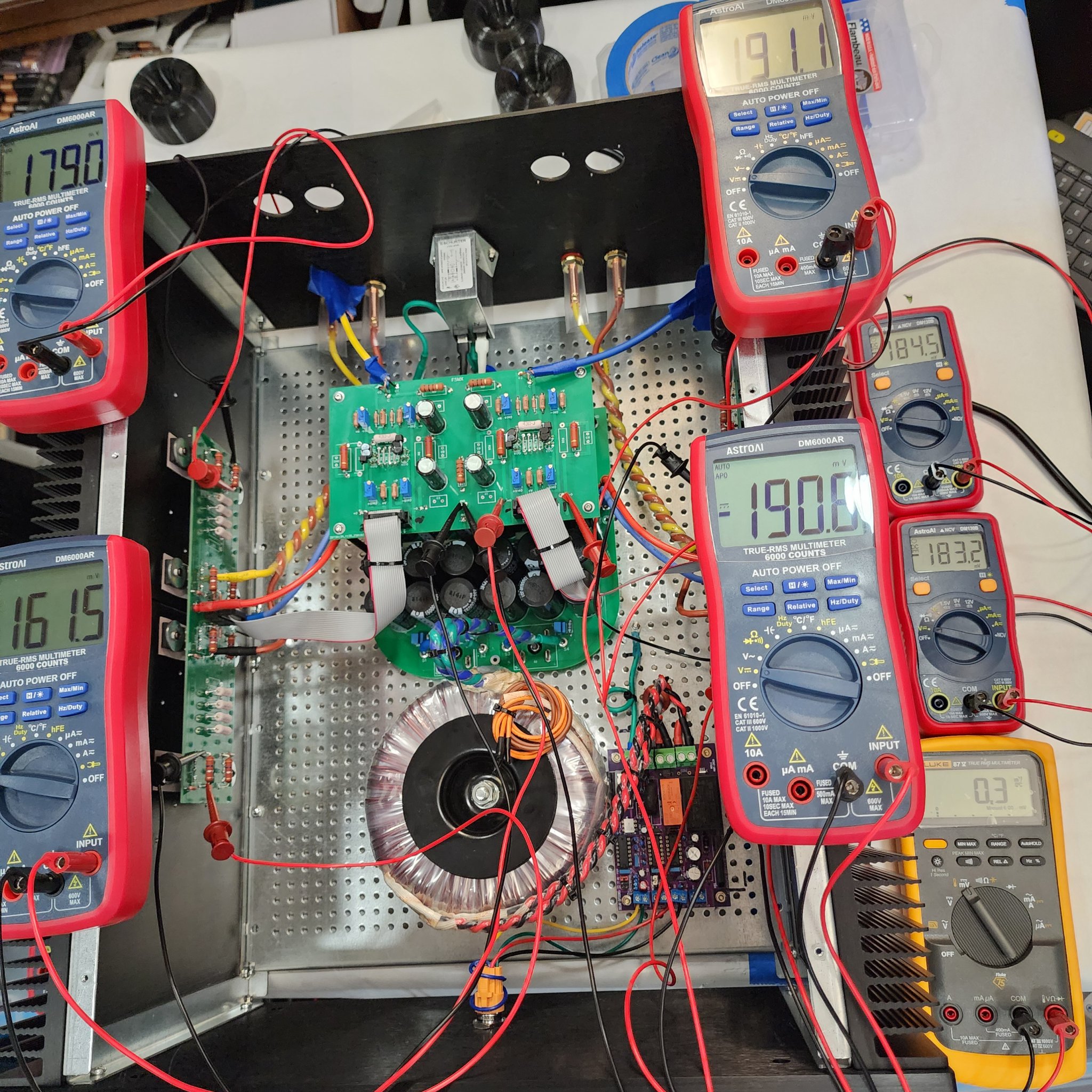

I've set about 0.5A bias per FET measuring around 185mV across the 0.36R resistors I used.

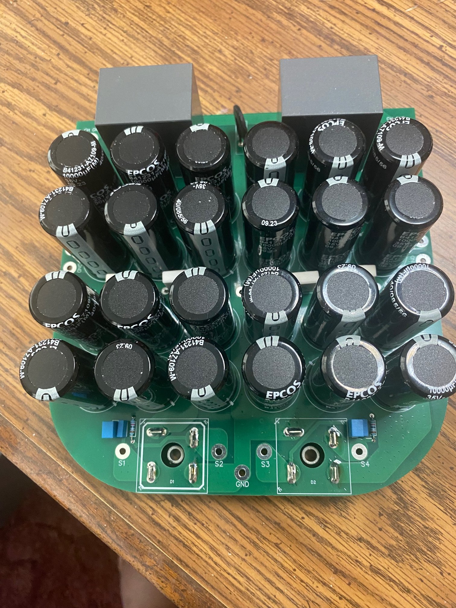

Unloaded rails for me are 31.7VDC on the +22VAC secondaries of the Antek. I added a request to have 22V secondaries to the order from Antek for the AN-8425, and John at Antek did his best to reduce the voltages. I may be a volt or two higher than Mike's rails just based on variation of that modification. For reference, I used 24 qty 15,000uF capacitors, instead of the 10,000uF caps in Mike's BOM. If I could do it over again, I'd probably just stick with 10,000uF caps. Since I'm using @Mark Johnson soft start (H9KPXG), I didn't use the soft start board provided with Mike's design. It seems to do just fine with the initial inrush of that massive cap bank (360,000uF!!!).
With 8 FETs per side at 0.5A and 30-ish volt loaded rails, is a lot of heat per channel (120W/channel of bias heat if I've done my math right --> Someone can correct me if I did that wrong.) My home room temp is around 72°F (22.2°C) when I'm at home and using the amp for reference. So that's just around a 35°C temp rise on the 5U/500 heat sinks to get up over 55°C. It stays under 60°C even when the room is up to 74°F (~23.5°C).
All the work to dial up the bias of the balanced amp was pretty tricky for me at first. This was my first time biasing a balanced amplifier, and I was a bit skittish with 8 different trimpots to fiddle with. I wished I had more DMM's at the time and I think I had 6 or 8 hooked up! It didn't feel like it was enough to really understand what was going on with the whole circuit. I had to trust Mike's instructions. I planned/plan on doing a write up, however, someone like Mike and Patrick (@ItsAllInMyHead ) are likely much better candidates to provide initial instructions. I'm happy to highlight the "tricky parts" that noob like me got confused with initially. Once I understood the whole process fully (took me over 8 hours to figure out with a lot of help from Mike), then it went really smoothly.
It's a really fun amp to build because of the relatively low part count, the simple and logical layout that Mike developed, and lots of help from Mike (and Patrick too!).
I couldn't be happier with the result! It's a spectacular amp to power my lower sensitivity Aerial Acoustic Model 9's (86db, 4-ish ohm). Whether at low volume or shake windows levels, it just sounds really good. "Me Likee a lot!"

When you get to biasing the amp, let me know. There are tricks to get the bias to start rising. 'It's All in my head' did a nice write up on it. I will ask if I can share it yet.
100%. I tried to tidy it up a little.
@uptownsquash - see attached. Suggestions are welcome and appreciated if others may want to use it.
