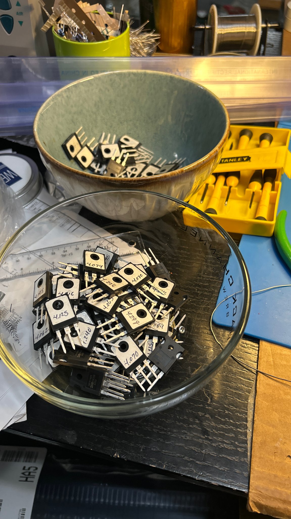

I'm finally making progress on my F5mX build. I now need to match the MOSFETs and then on to installation into a chassis. I am very excited to get this playing tunes in the not too distant future.

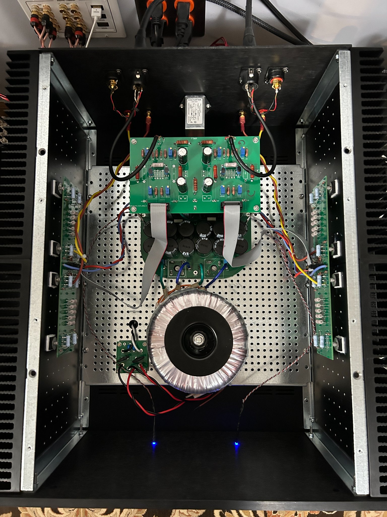

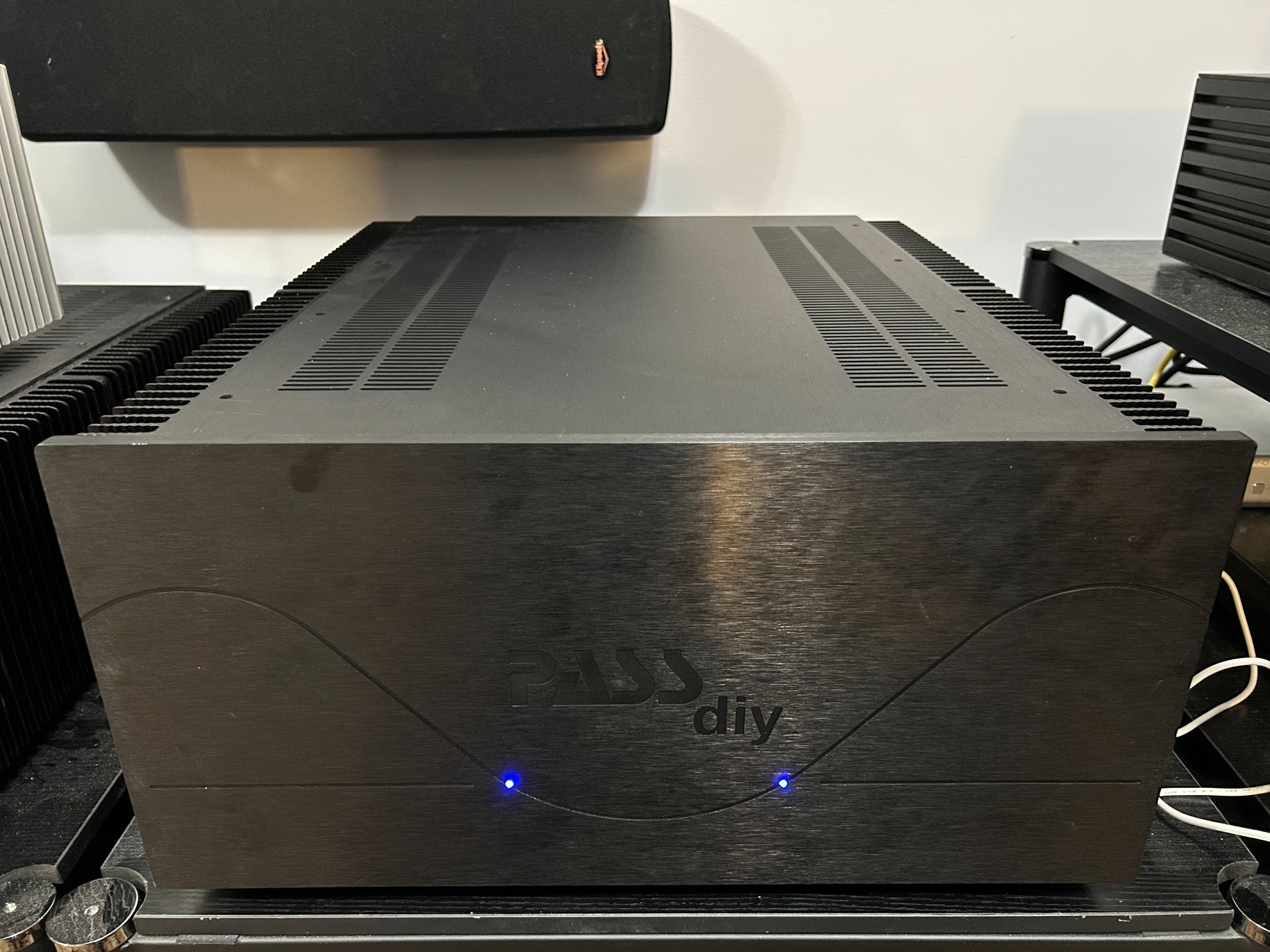

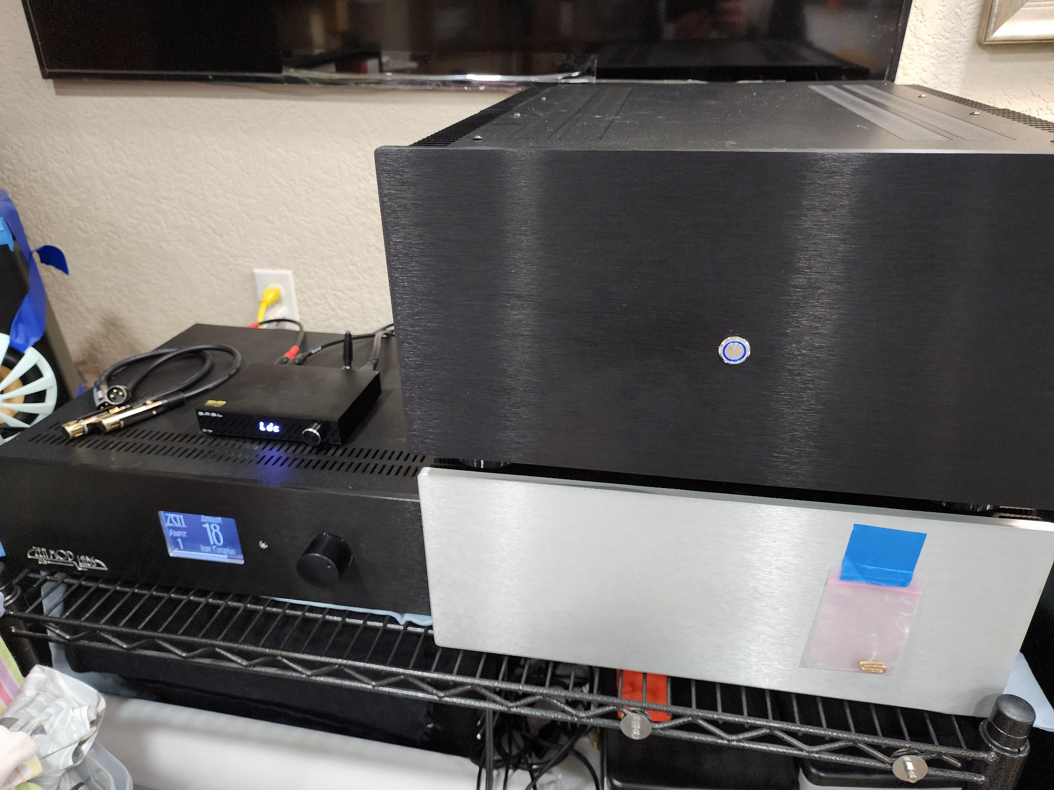

Here we go folks. Another F5mX is born!!!
A huge thanks to Mike for a fantastic design based on Nelson's F5m. This thing rocks hard! I'm just enjoying my first glorious tunes, and I can already say it maintains that unreal F5m sound with sparkling highs. The extra oomph of the F5mX is obvious in the low end control. The F5m has great bass, but the F5mX has that extra thump that double the class A power provides. It's an obvious improvement in low end that puts my F4 in the penalty box. I've not heard the F5 Turbo, but this feels like an F5m Turbo.
I used a Modushop 5U/500 chassis and set it up with 8 FETs per channel (IRFP140/9140). I've got it biased on 0.36R source resistors to 0.52A and 55°C heat sinks. This is a "big boy amp".
I'm listening to it right now and just want to give a special shout out to @Mikerodrig27 for all his support. I would not be listening to glorious tunes without his help.
I plan to do a little write up on my journey to help others out, but for now, I gotta crank some music up and enjoy the amp. More to come.....

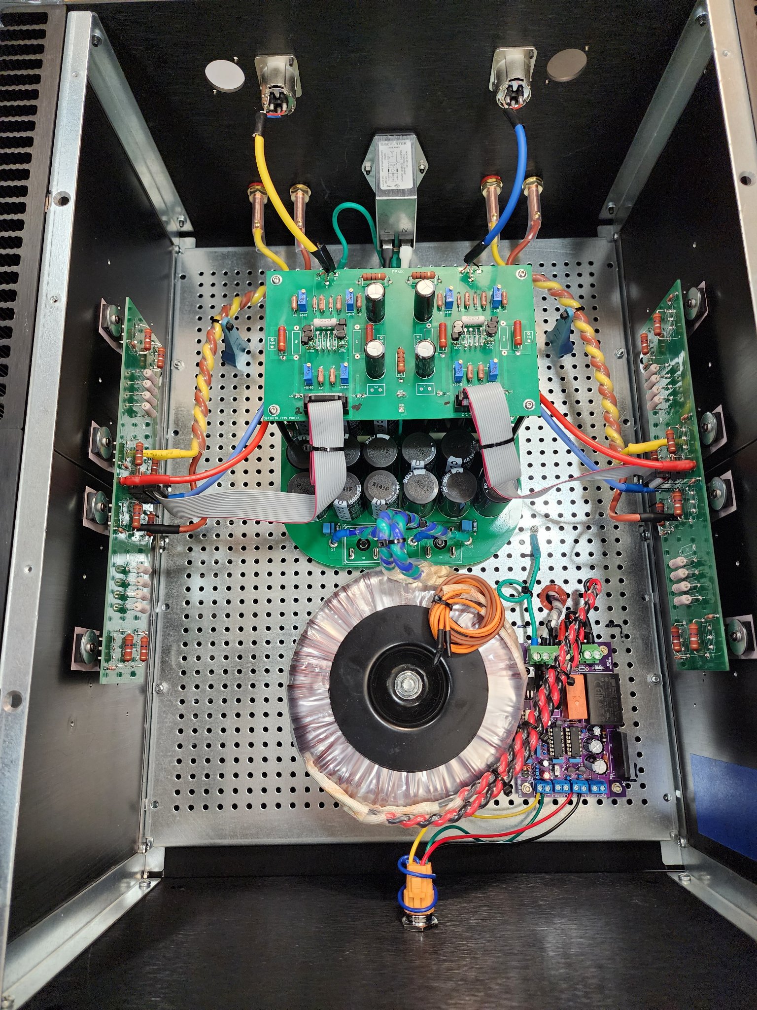

@birdbox awesome build. Just a quick question on the LED switch which I am presuming is a AC one looking at the number of wires as I also use the same. This AC switch is meant for direct AC and I see you are using on the SW pins on Mark's soft start board, I also use similar Lanboo led switch and I get some hum if using with SW pins of Mark's so I had to replace the LED to the direct AC wiring on the IEC socket.
Schurter 4304.4045. Coincidentally - that is the model included with the new back panel parts kits.@birdbox: what make and model filtered power entry model did you use? That is a clear improvement IMO, for ensuring sound quality despite differing AC mains conditions.
@ ItsAllInMyHead: thank you for the information. I am really awaiting the new chassis and back panel kits. I check every day!
The switch is nothing special. Came from Bezos bookstore. The LED illumination requires DC voltage (suggested 12-24VDC), and is just two wires (black and red on my switch). The other three wires are used for switching. One chooses the two wires of the three that meet your desired On/Off criteria (I chose button "In=Off/open", "Out=On/closed"). The switch itself can technically work with AC, or DC. Its rated to 5A according to the specs. There is no hum from my soft start board. It works great!Just a quick question on the LED switch which I am presuming is a AC one looking at the number of wires as I also use the same. This AC switch is meant for direct AC and I see you are using on the SW pins on Mark's soft start board, I also use similar Lanboo led switch and I get some hum if using with SW pins of Mark's so I had to replace the LED to the direct AC wiring on the IEC socket.

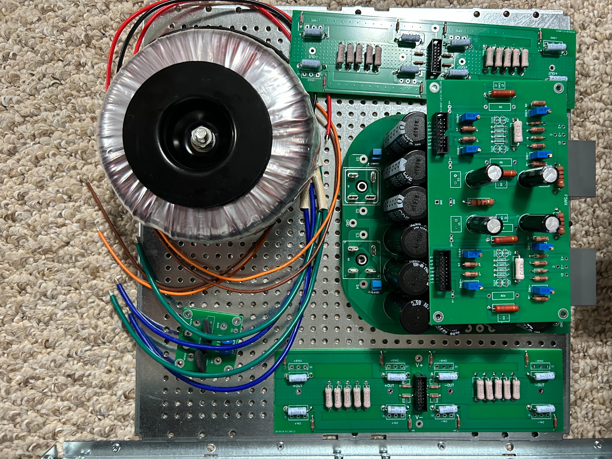

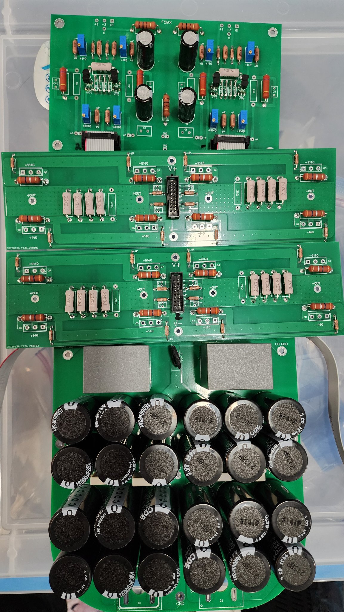

How is it that no matter how many amplifiers I build... I inevitably forget to order (or forgot that I ran out of) some small component. DIYer's law?

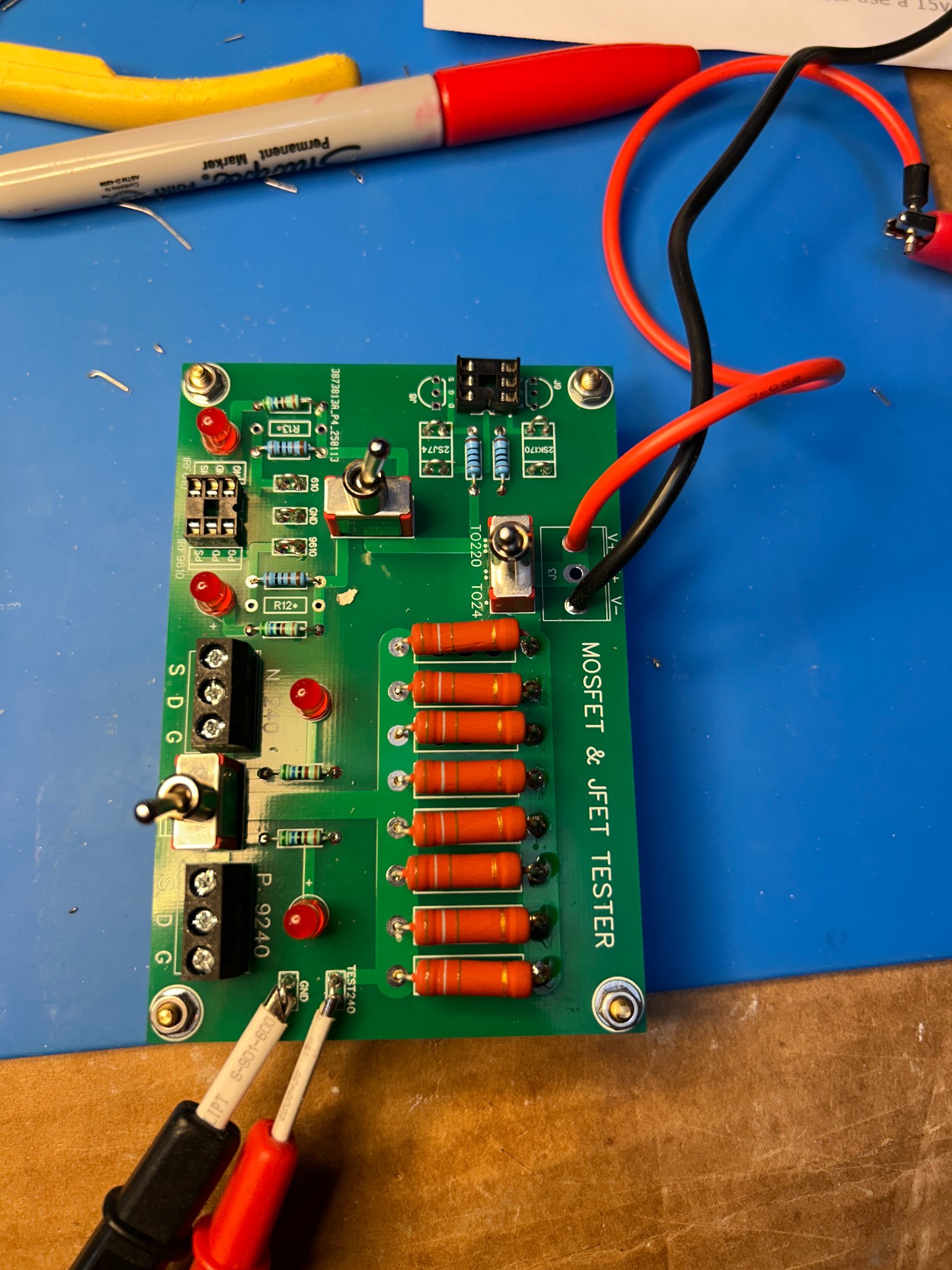

Anyway... I made some progress on the F5M-X over the week. Matched up a few 140s / 9140s. Built up the PSU and the amp boards.
Now, I just need a few mechanical components to arrive, and I'll get it in a chassis and fired up. Turns out that the 400mm perforated plates will work in a 500mm chassis, so I don't need to order more of those or rob them from another amp.
Was hoping to tidy it all up later today or tomorrow, but it will be next weekend most likely... unless I get lucky.
A huge thanks to @Mikerodrig27 for the fantastic design and straight forward build / guidance docs. Another big ol' thank you to @birdbox for grabbing a lot of the essential components.
