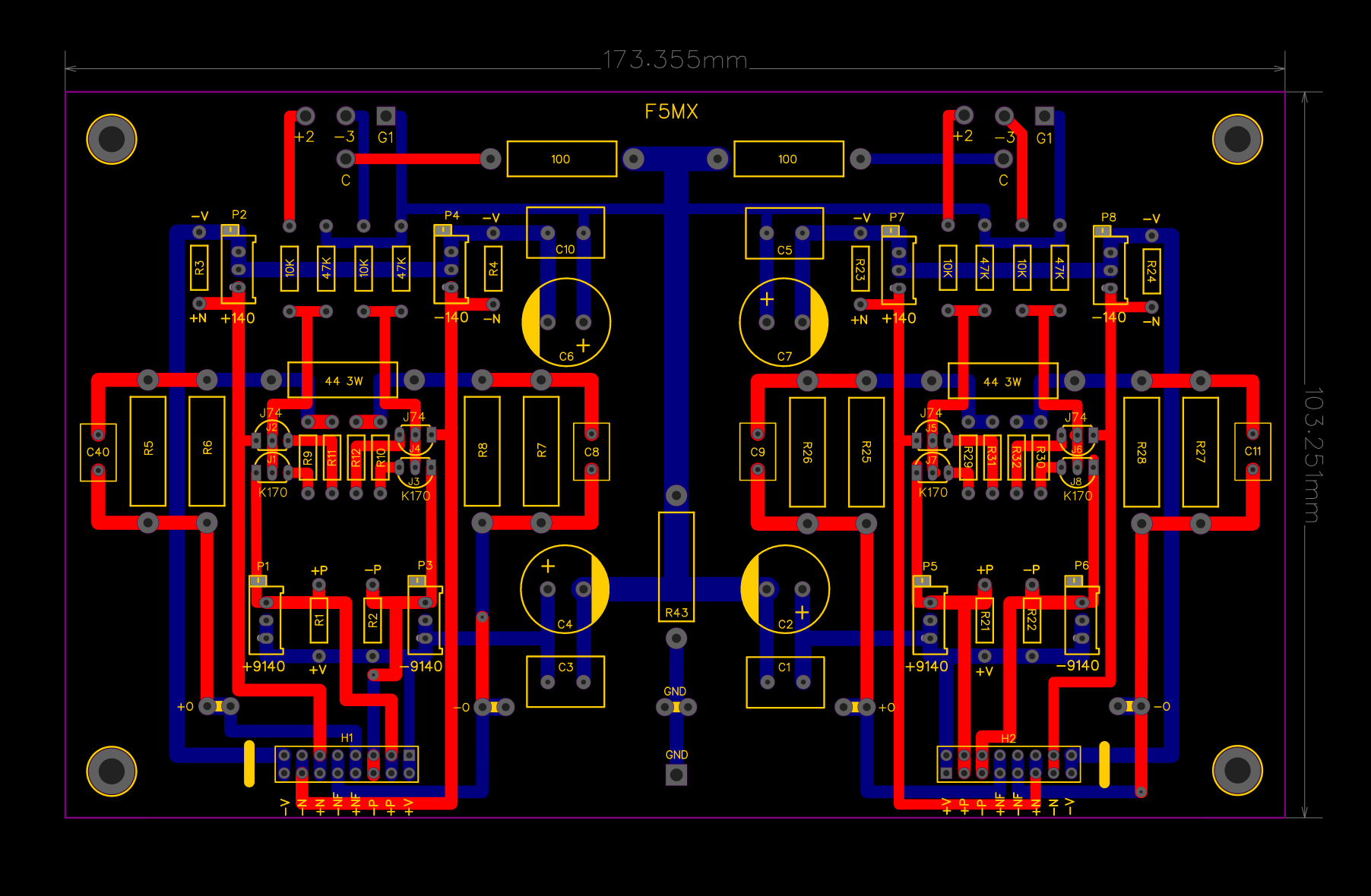

I built a bridged F5m which I am calling the F5mX. It is pretty minimal for a bridged amp.
It is pretty much a F5m that is bridged plus a few little tricks. The most interesting thing is that it has CCS resistors on the OS stage. They are oriented on opposite rails on the opposing phases to hopefully break a little bit of symmetry and give us a little 2nd harmonic distortion.
The Schematics and the BOM are in the 2nd and 3rd post.

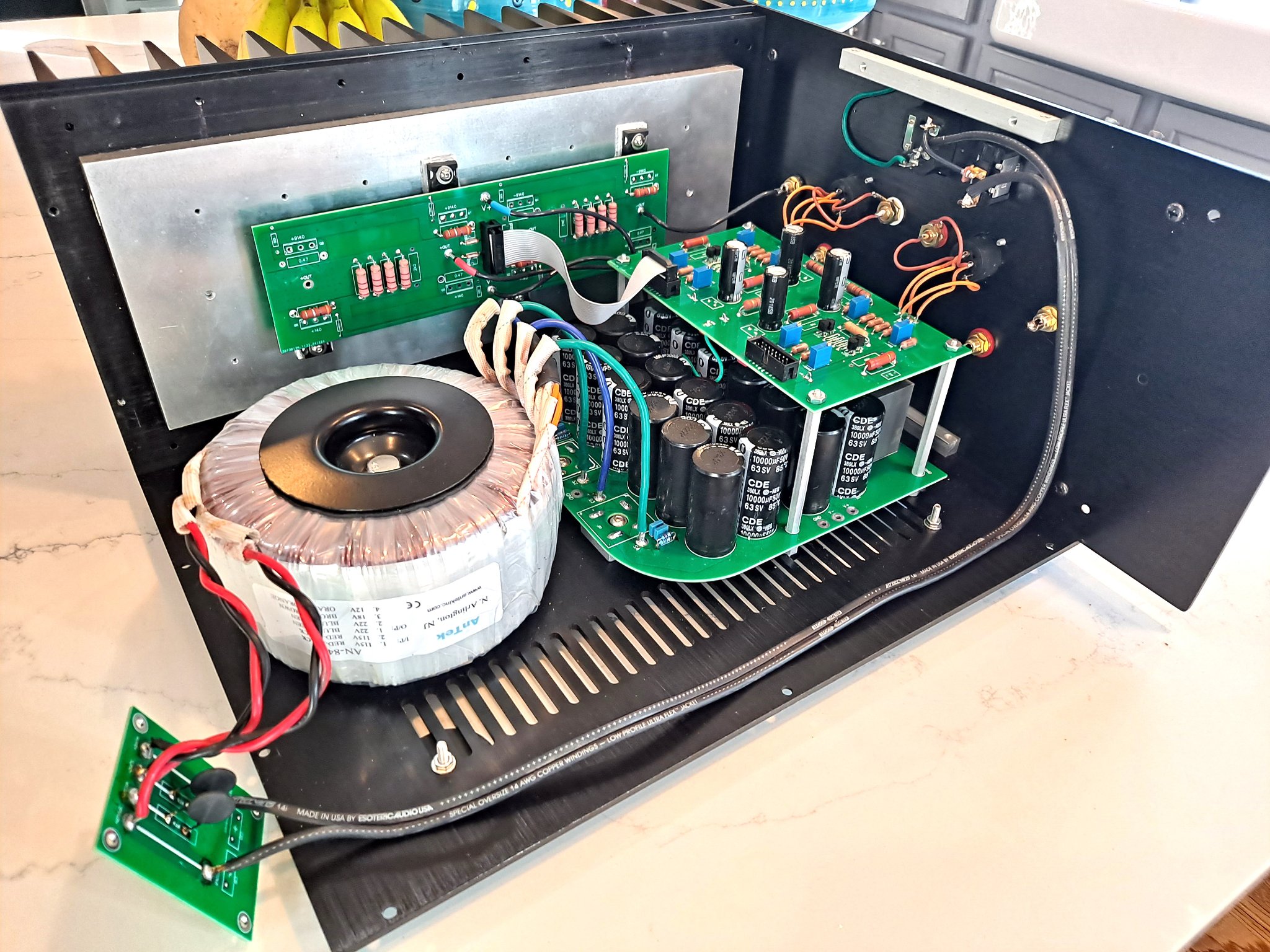

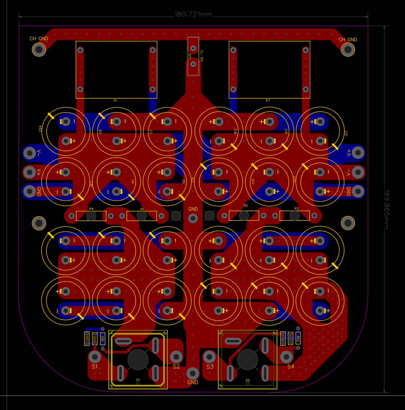

The power supply has the bridge rectifiers integrated in the board. You can see I snip the terminals after soldering. Keep in mind that snipping the terminals off is easier without the caps mounted. Snipping them off also makes it a bit easier to desolder the bridges if ever needed. The PSU has 70uF film caps bypassing the last stage of the CRC cap bank. The EL caps are 24x10,000uF 35v. Ground lift is on the board and connects through the standoff. there is also a Quasimodo Snubber circuit on the board which I recommend using. My transformer required a 7 ohm resistor for RS1 and RS2. A 8-10 ohm resistor would work as well.

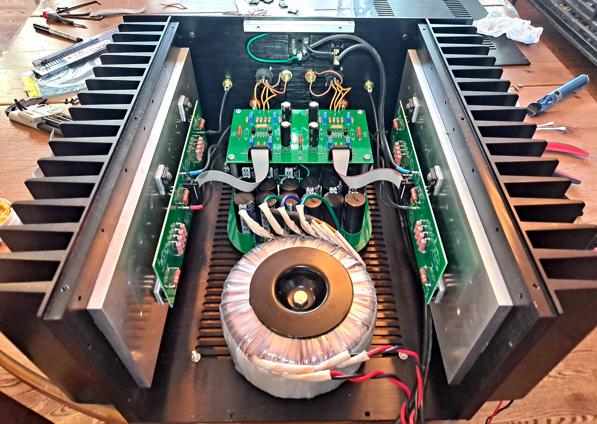

The front end connects to the output stages with two 16 pin (2 rows of 8) female to female ribbon cables. I bought the ribbon cables and sockets from Amazon. I did have to shorten them as they are very long. It is not very difficult to do.
Each channel on the front end pulls it's power supply from the output stage via the ribbon cables. There is a single ground wire connecting to the PSU which you can see in the pic below. The front end mounts to the standoffs that the power supply mounts to the bottom panel with. So you have short standoffs under the PS, then tall standoffs going from the PS to the front end. I made the standoff holes on all the boards large enough to accomodate #6 thread so you can use either your typical metric standoffs or larger #6. The OS simply mounts by being soldered to the leads on the IRFP140/9240 mosfets. When you assemble the front end, it is good to reduce the resistance of the pots to their minimum setting. This will make it so that they are not biasing the output stage upon first startup. I used Dale resistors as there are so few, and they are convinient for troubleshooting so long as you are careful to face the value labels upwards.
There are spots for source resistors on the JFETs (the 10 ohms) but you can jump as you see in the photo below (between the JFETs). These are there to allow a bit of flexibility in the event that someone wants to experiment.

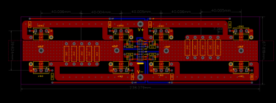

The front end takes one quad of J74/K170 Toshiba JFETs per channel. The outputs are two pairs of IRFP140/9140 (one pair per phase). However, there are spots for 4 pairs of output devices per channel so you can experiment. I used 0R36 source resistors and it behaved great. However feel free to use the standard 0R47. If you are only using the four mosfets per channel, feel free to skip the gate resistors just like on the regular F5m. There are spots for thermistors on the OS board to make the bias more agressive at a cold startup but I haven't tested this yet. It works just fine without them. As you can see, I have four of the 2.2k CCS resistors populated per phase. I like this amount but you can try more or less. I use ceramic insulators on the mosfets but feel free to use the stores insulators. They are great!
I have had it biased at about 50-60 watts of class and have tested it up to about 110 watts in class B. Assuming you are using a quad of outputs per channel, and have a 5u chassis, with your 0R47 source resistors, use the normal say .500v per mosfet and see how hot things get. If you use 0R36 resistors, you can set it to 0.380v accross a source resistor. Then lower or raise it accordingly. If you are using 4 pairs of mosfets per channel, drop the bias per device in half and tune for temperature.
The transformer that I am using is a 22vac 800va which is giving me around 26.5vdc rails. Antek gave me simple instructions on others ordering this same transformer.
The boards are set up for UMS spacing. The power supply board and the soft start board has the holes set to 10mm spacing so they should bolt right up to the preferated bottom plate that DIYaudio sells. One board set includes:

one power supply board

Here are the schematics for the front end, the OS and the power supply as well as two pictures of everything assembled.

I liked the F5m so much that I was interested in doing a turbo type of F5. But then I thought it would be interesting to try a bridged F5m'ish amp that takes advantage of some of the tricks that Pass used to make the F5m happen.Lets get things flowing. What prompted you to create this amp ?
The balanced aspect is pretty cool in that the output supply is really fast.
-You don't have to increase the rail voltage to 32v in order to get the 50 watts of class A
-No cascodes, lots of current
-A healthy 110w class B envelope
-The feedback structure makes it so that you don't have to fuss about making the power supply as quiet as you would with a non-balanced design... So a fast power supply is really nice.
-All at the cost of an extra quad of JFETs and their associated parts.
The end result is what I expected. A nice detailed amp that is still relatively simple. When I play songs with lots of bass, things will be rattling in the house and the vocals will still be floating in the middle of the soundstage seemingly unaffected.
Mike brought this over to my house a couple weeks ago, it’s absolutely fantastic.
- 800VA transformer
- 2 filter capacitor banks of 120,000 microfarads each
- no inrush current limiting or soft start anywhere?
Mark, I am glad you brought it up. The board is designed around 120V. So for 240 V supplies, people may need to get creative.... I will probably add the silk-screening on the bottom to accommodate 240V the future.
