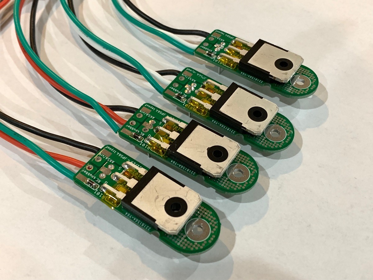

Made me think of the AN39 amp that's popular over on the SS forum. It has those separate little floating boards. Keep in mind you always want to keep any gate or base resistors physically close to their respective pins for stability.

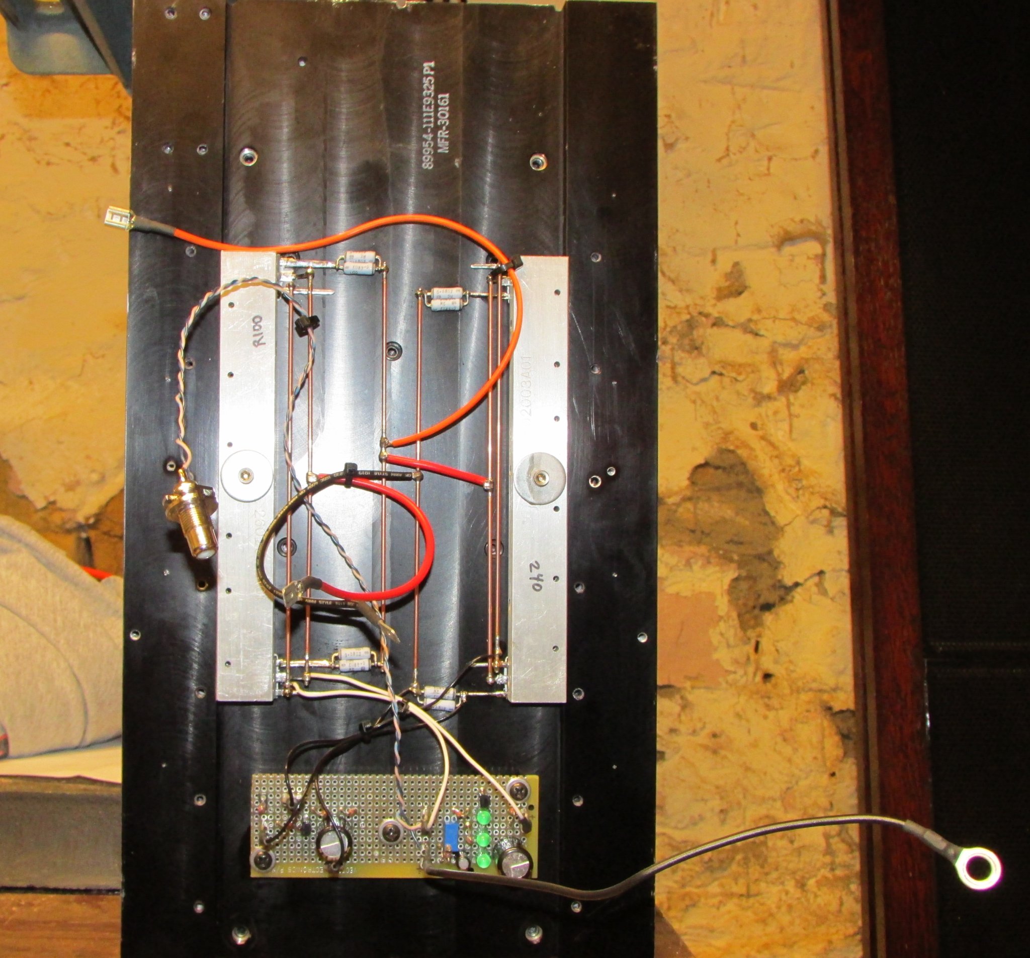

But you could use large wires to connect... something like 12 gauge? And keep them in parallel, not twisted.
Thicker wires won't be as effective as shorter lengths to reduce inductance, and are more difficult to work with.
The inductance is nearly proportional to length, so shorter is better.
Twisting actually does reduce the loop inductance, although twisting should only be done with the base/gate
and the emitter/source wires. You don't want to couple noise into that pair of terminals from other nodes.
Novice power electronics students have often made that mistake, and the consequences are not pretty.
