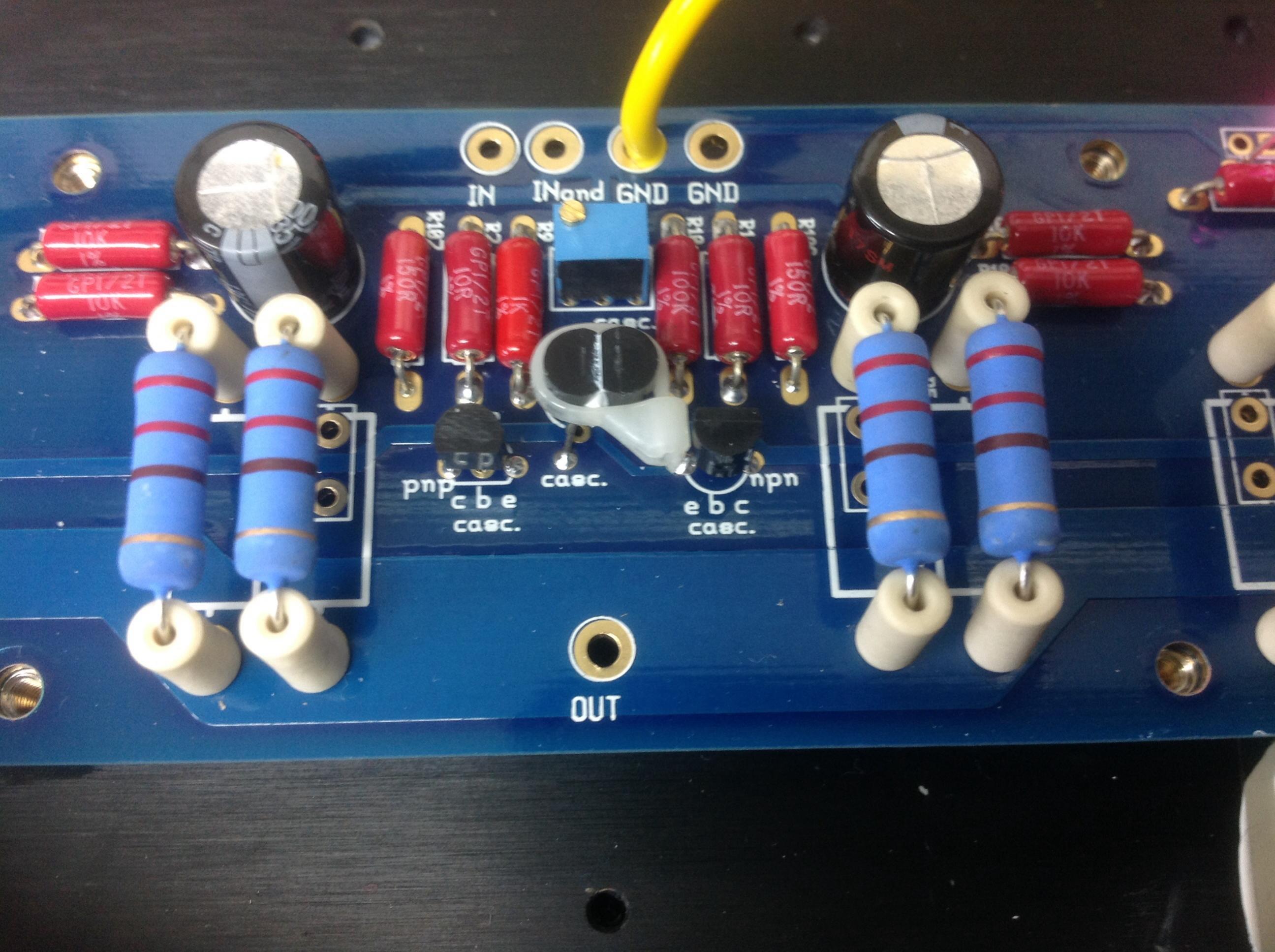

Bias problem
Hi Guys just fired up my first F5C and all is working apart from the fact I can't get it to draw enough bias current I have adjusted the P1 & P2 pots alternately and I can achieve only 0.134mv across the source resistors.
The amp is obviously working and is stable and I am able to adjust P1 & P2 to achieve 0.00 MVP offset at the output, I have had the amp on for a few hours just to see if she's stable and the sinks have warmed up nicely to 36deg C I'm guessing some resistors will need adjustment so any ideas where I should look.
Ian
Photos of pcb just in case I've missed anything

So it's a cascoded 2 pair version? Wich rail voltage do you have? And whats the value of the resistors in the cascode circut?
okei.
Also. Whats the idss of the J-fets? And are you sure they are the real deal?
Not sure about the JFET's I purchased them some time ago from an eBay seller in Israel (alweit) allegedly matched quads they were marked 4.45 ?? But what measurement is god only knows.
I have ordered some new JFETS from the DIY audio shop I will swap them out and see if they cure the problem, I think you may be right as the amp is basically working.
Earthquake -
Increase the resistance across the bias pots - add another 2.2K in series or swap for a 4.7 or something in that range - it seems like your Jfet are low Idss and just need more resistance in the bias circuit to turn on. Easy, simple fix.
And just to verify, the max bias you can get, with zero offset, is 0.13V?
4.45? is it GR grade?
6L6. i think i need 6.8Kohm. or maybe more. it depends on how much bias he wants of course🙂
however. i'n not sure that a single pair J-fets with 4.45mA IDSS is up for the task of driving 2 output pairs.
Hi guys (6L6 & Audiosan) your both right it is almost certainly a bias issue the devises are GR's and not BL's so that's most likely cause I am expecting some Jfets from the DIY audio shop any day now but in the mean time I'll play with the 2K2 resistor value. Thanks for the pointers.
