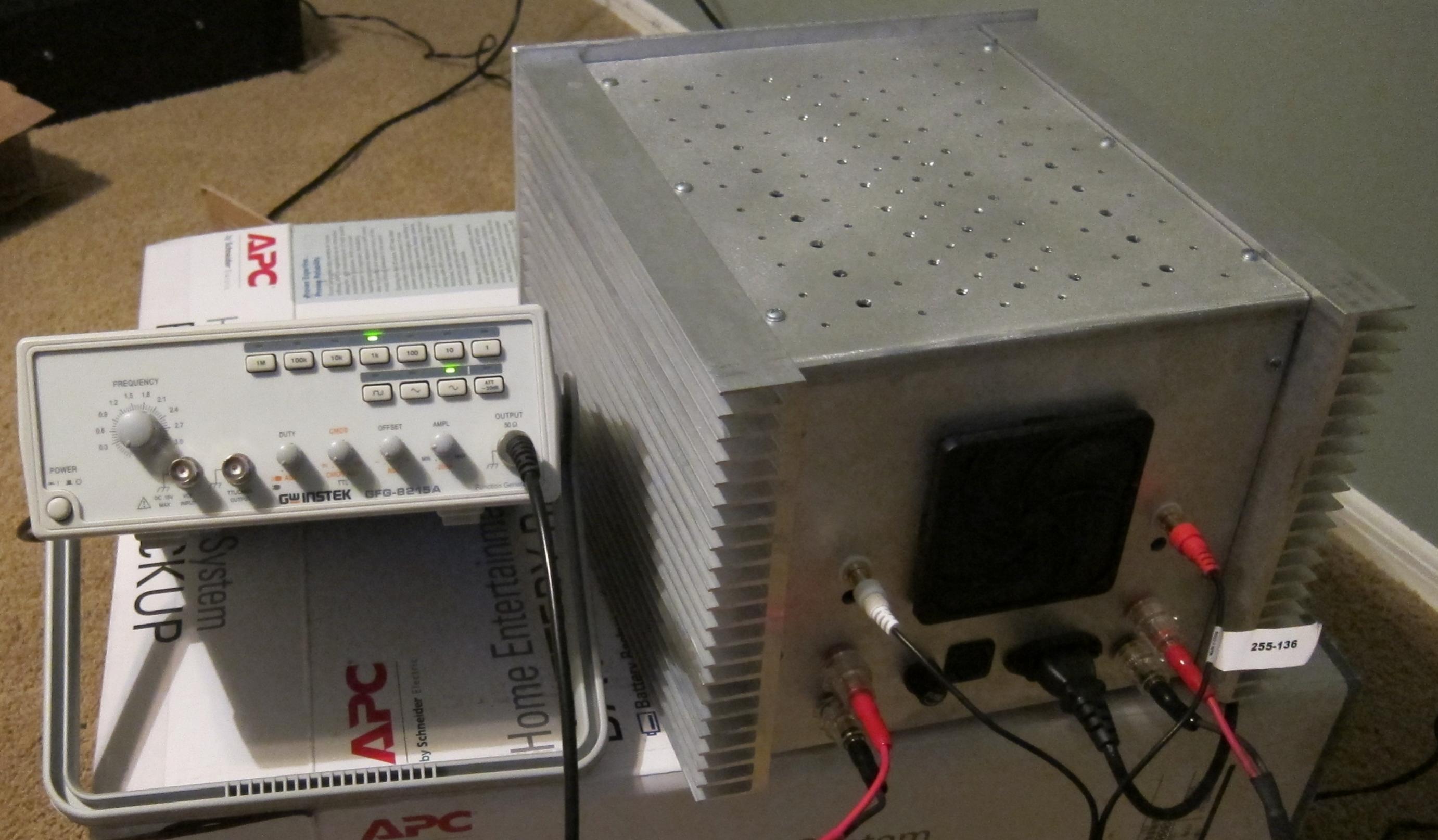

Next step was to measure the output impedance of our initial F5 (biased at 1.3 A) and of the F5c V2.0. Measurements and calculations were performed with a 1K Hz signal into the amp. The photo below shows the signal generator by our original F5. The F5 measured about .3 ohms while the F5c V2.0 measured 0.15 ohms. But these were rough measurements using a 5 and 10 ohm power resistor compared to an open circuit, and are only approximations.
With an identical 1 K Hz sine wave into the F5 and into the F5c V2.0, the F5c V2.0 (220 ohm feedback resistors to increase gain) put out just slightly double the voltage at the speakers compared to the F5. No surprise there.

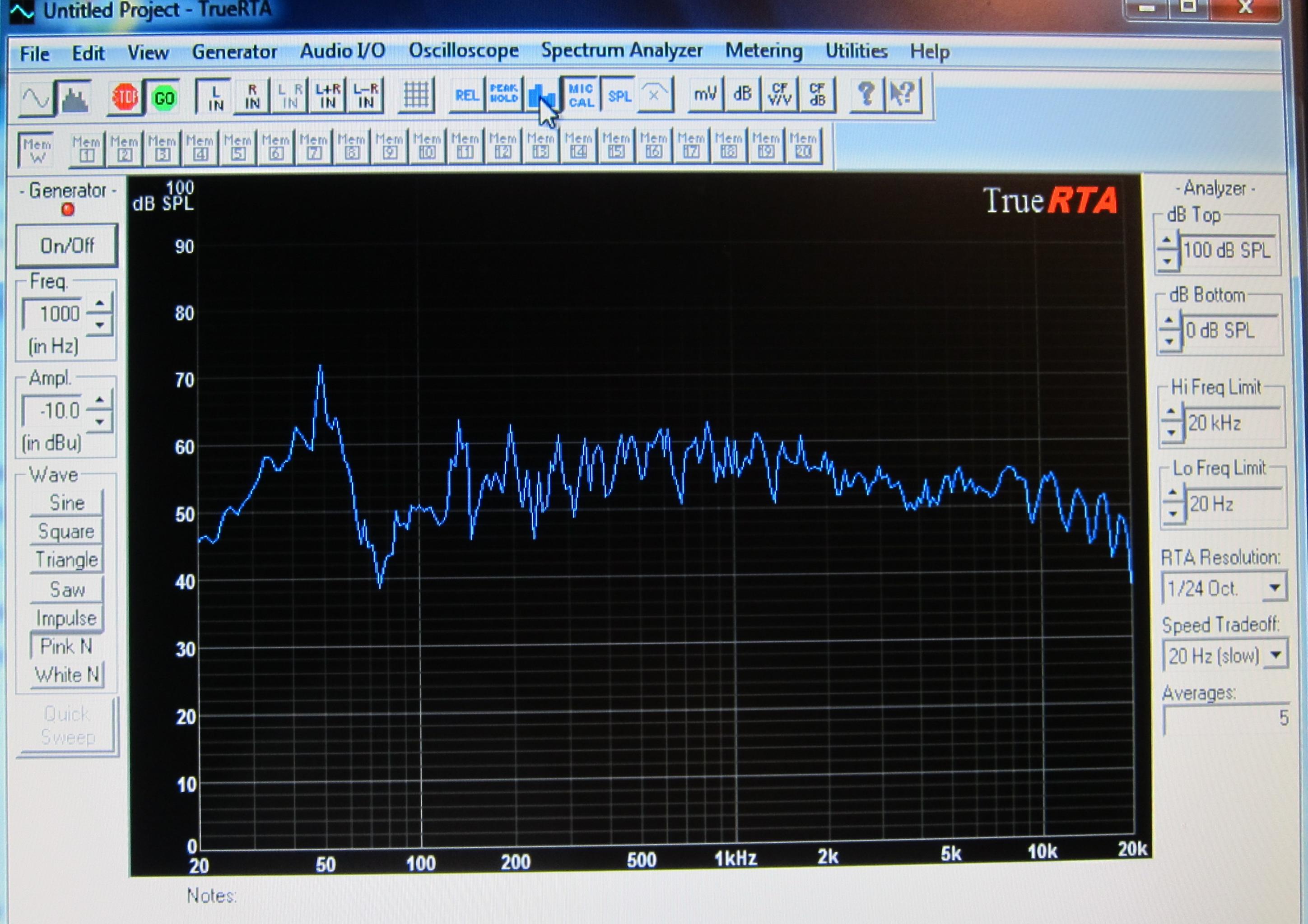

Frequency response measured in the room (microphone, software, etc.) were compared between the two amplifiers and were extremely similar. The speakers were Spendor S8Es (2 drivers each). (We did not take measurements of the isolated amplifiers, themselves, but plan to do so). We have shown a room measurement curve for the F5c V2.0, below. We have a bump about 50 Hz with a slight dip around 80, which we have seen in this room with other amplifiers, as well, making us believe it is the room, and to a lesser extent the speakers, more than anything else. With room measurements, both amps produced pretty much identical curves.
