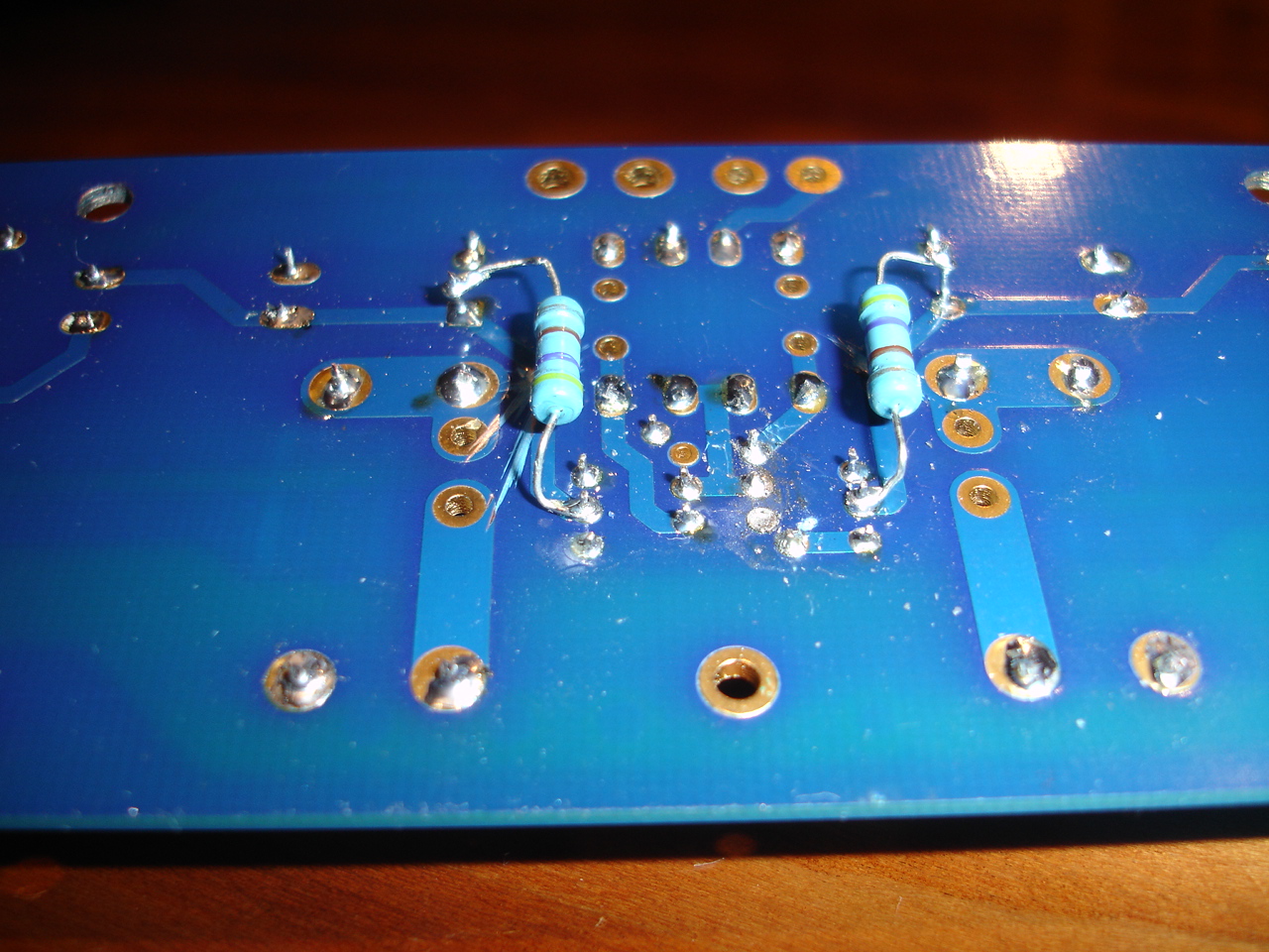

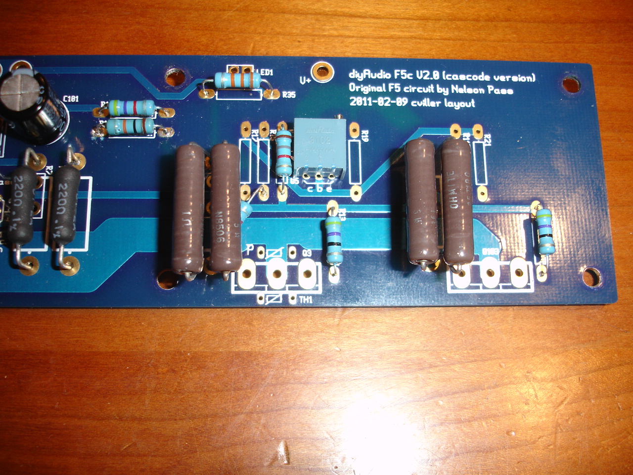

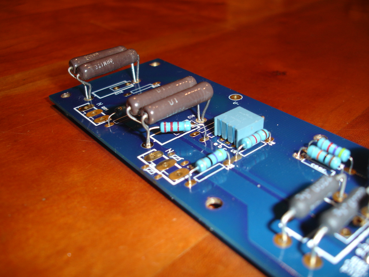

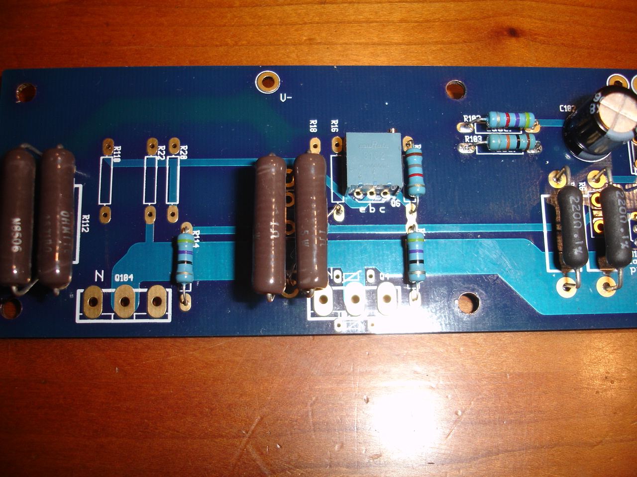

I thought I would post some comments and photos on the construction of an F5 turbo my son and I completed about a month ago. The amp currently is up and running. We had built the F5 previously and had many components remaining, just waiting to be used in a project. When the F5 turbo discussions began, we decided to go for it, mainly to be able to power 4 ohm speaker columns. We certainly are NOT experts, but had greatly appreciated the photos documenting previous F5 builds for our first project, especially the work of 6L6. Thus, we hope these notes that show our mistakes, misconceptions and successes might assist a beginner in building their first amp or, at least, first F5turbo. This record was made as we went along during the build, and has been assembled and edited for this thread.

Thanks for the kind words, zoe. I assume you found Nelson's discussion of those resistors in his initial F5 turbo document after looking for them. It may be that the amp works fine without them, but we took the time to install them as they certainly could not hurt. We also increased gain (by increasing the value of feedback resistors) as Nelson had suggested.
We spent quite a bit of time comparing schematics from Nelson's with that of Christian, and then looking at the parts list for Christian's board from the store, etc. As you know, the numbers on various resistors differed between schematics, etc., making this initially confusing. One of the schematics also had a typo on one of the resistors of the voltage divider circuit for the cascoding transistors (was it Nelson's? - can't recall without looking), but that was pretty easy to pick up, as the circuit had to be identical to the base of both transistors. But Christian and others were of great help in quickly responding and answering questions. I honestly have not looked at the parts list and schematic that are posted at the diyAudio store in several months, so things may be a bit different. I'll take a look tonight again out of interest.

Looking good. Nice job on the resistors on the bottom side. I see parallel 5 watt 1 Ohm resistors on the sources of the MOSFETs. What are you shooting for with regard to bias, or is that just what you had lying around? That should sure do the job.
Just a note: on the photo of the underside of the board, some of those soldering connections look like they could be cold - but a photograph can be very deceptive and you obviously can see it much better than I.
What are you using for MOSFETs?
