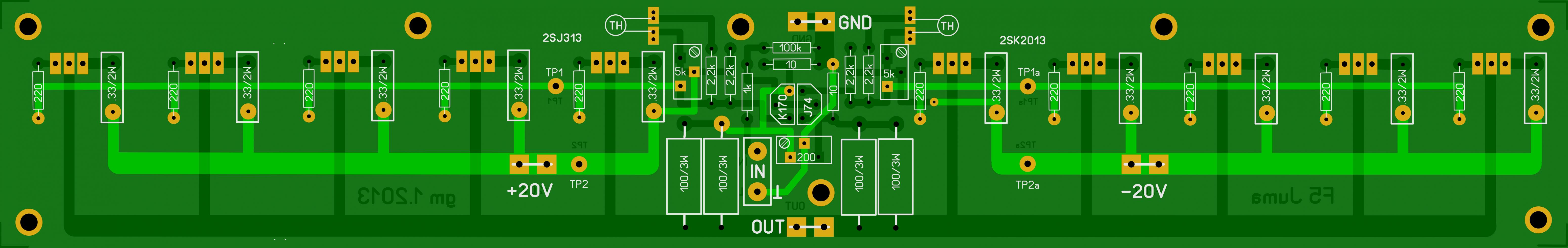

Thanks for your interest in the Juma F5 boards. I will definitely order a small run.
The boards will be FR4 1.55mm thick, two layers, 105µ copper cladding, green solder masks on both sides, white silk screen print on the top side. The production time will be approximately two weeks.

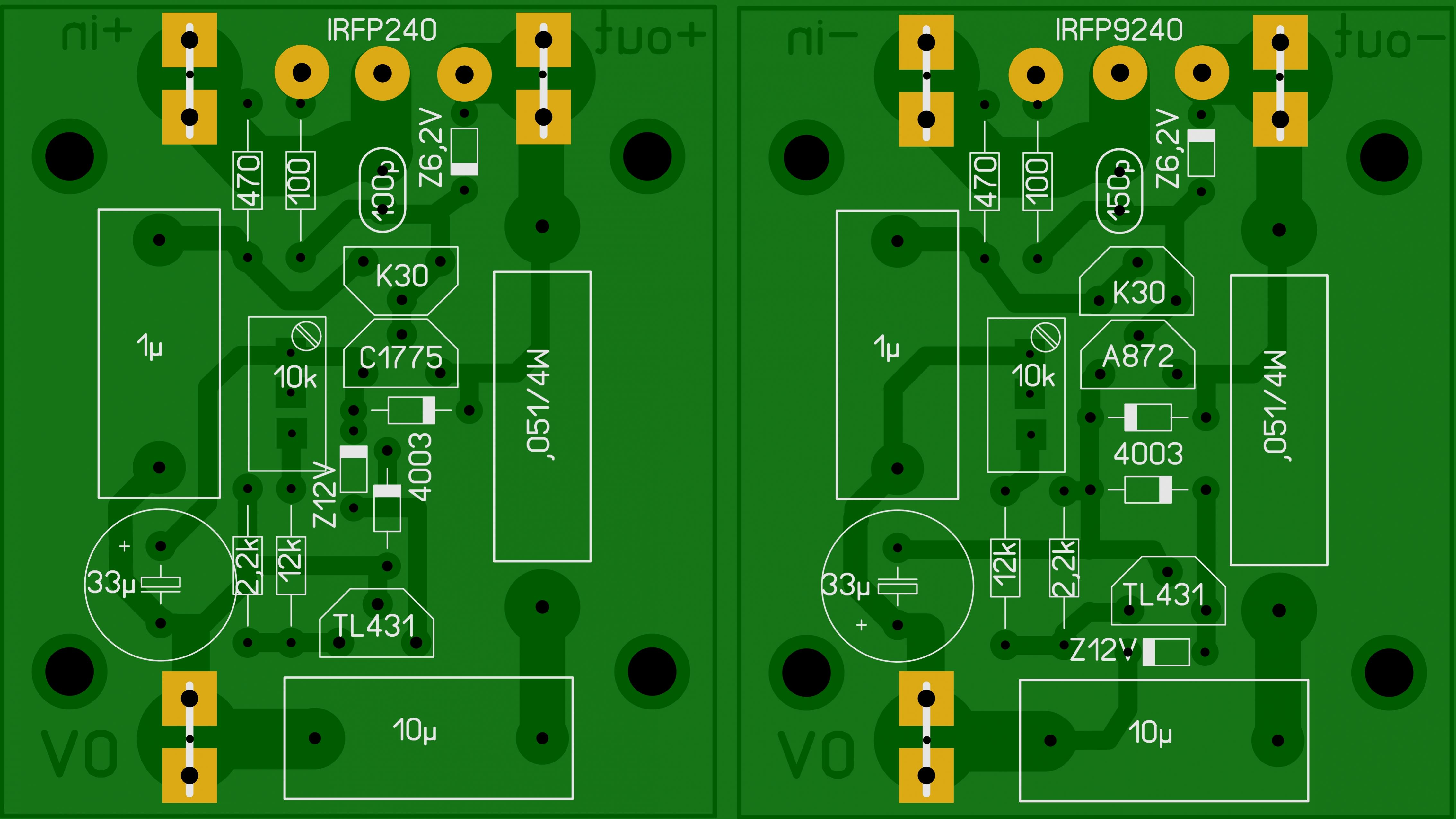

I will also offer regulated supply boards with adjustable output voltages on request. These boards do not include rectifiers and load/buffer capacitors. Please send PM for more information.
Here is a picture of the actual amp board. I added Papa's "tone control", a 200R trim pot paralleled to the 10R Source Rs of the JFETs (optional). The MOSFET degeneration Rs are MPC70 .33/2W.

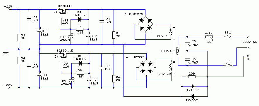

wonder if this means I can finally find a purpos for my old 2kw monster trafos 😀
they put out 2x 38Vac
would your regs handle this...safely ?

They will. It might be necessary yet to double the MODFETs depending on the wanted current flow.
What regulated voltages do you require? It wouldn't be wise to feed the regulators with rectified ~ 55V and regulate them down to 20V...24V though. Too much needless heat dissipation.
permaneder;3376150 I will also offer regulated supply boards with adjustable output voltages on request. These boards do not include rectifiers and load/buffer capacitors. Please send PM for more information. One set (2 boards = dual Mono) will cost ~ EUR 20 (minimum order = 15 sets)[/QUOTE said:You are using a different regulator than Juma's, see below.
What is the advantage of your regulator over Juma's?
Rush
Juma's is cap multiplier

no, I think its more like a filter
and works like a big cap, just more effective, in some ways
hence the name cap multiplier
I think its also less prone to malfunction
if you dont need a precise fixed voltage it might be better than a reg
you may still need to know how to calculate the correct voltage drop

think Vgs for mosfet based one , and think Vbe for bjt based one
