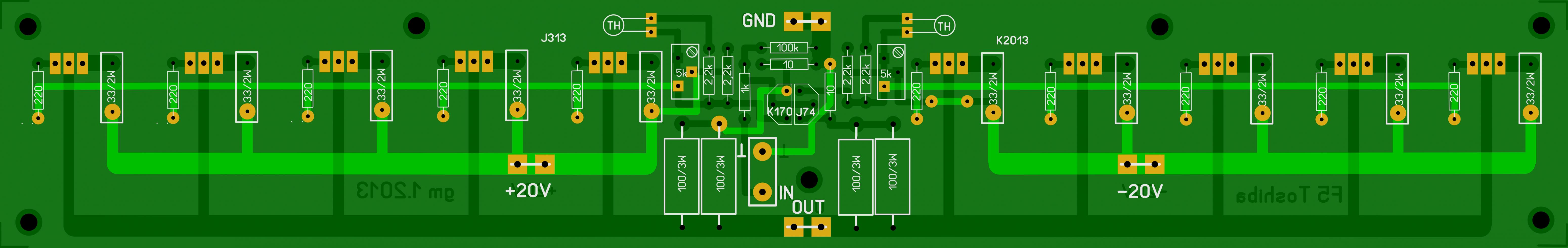

Just for fun, here is a little pcb for your amp.
me likes to!
Just for fun, here is a little pcb for your amp. Each five MOSFETs allow either lower bias and higher supply voltage rails for more power@8Ohms or more power@4Ohms with 400mA bias (total 2A per rail) and +-20V supplies.
Nice looking board. What are the dimensions? Output device spacing?
Have you tested the board, any errors?

I would order boards of Juma's F5, if there is sufficient interest. The price per set depends on the number of ordered boards. From ten or more sets on we we can expect reasonable costs.
I would like a pair of boards also, Per - can easily trim them down to 3 o/p Fets if required -
Could you add 2 small electro/solid poly caps across the rails to a separate 0Volt point near the jfet input, maybe 47uF+ ...

What about those: Panasonic FP V low ESR SMD electrolytics EEEFP1V470AP (~ EUR .30 each here in Germany)? Send PM with your email address and I'll mail the datasheet.

...or two types of pads (SMD and pasthrough) to choose the type of capacitor. I like the sound of Silmics and others audio capacitors
