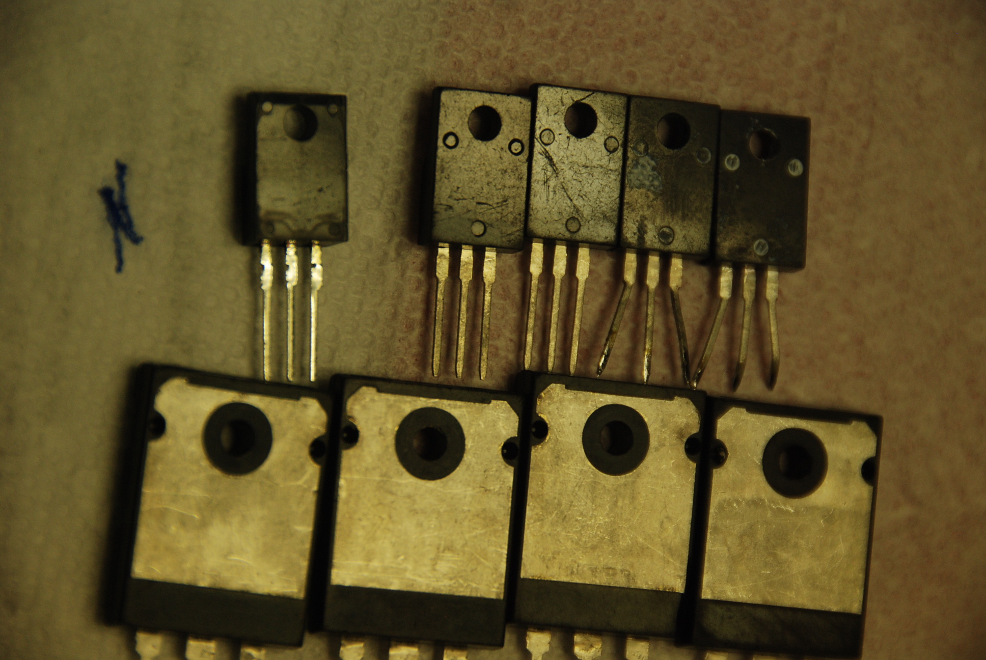

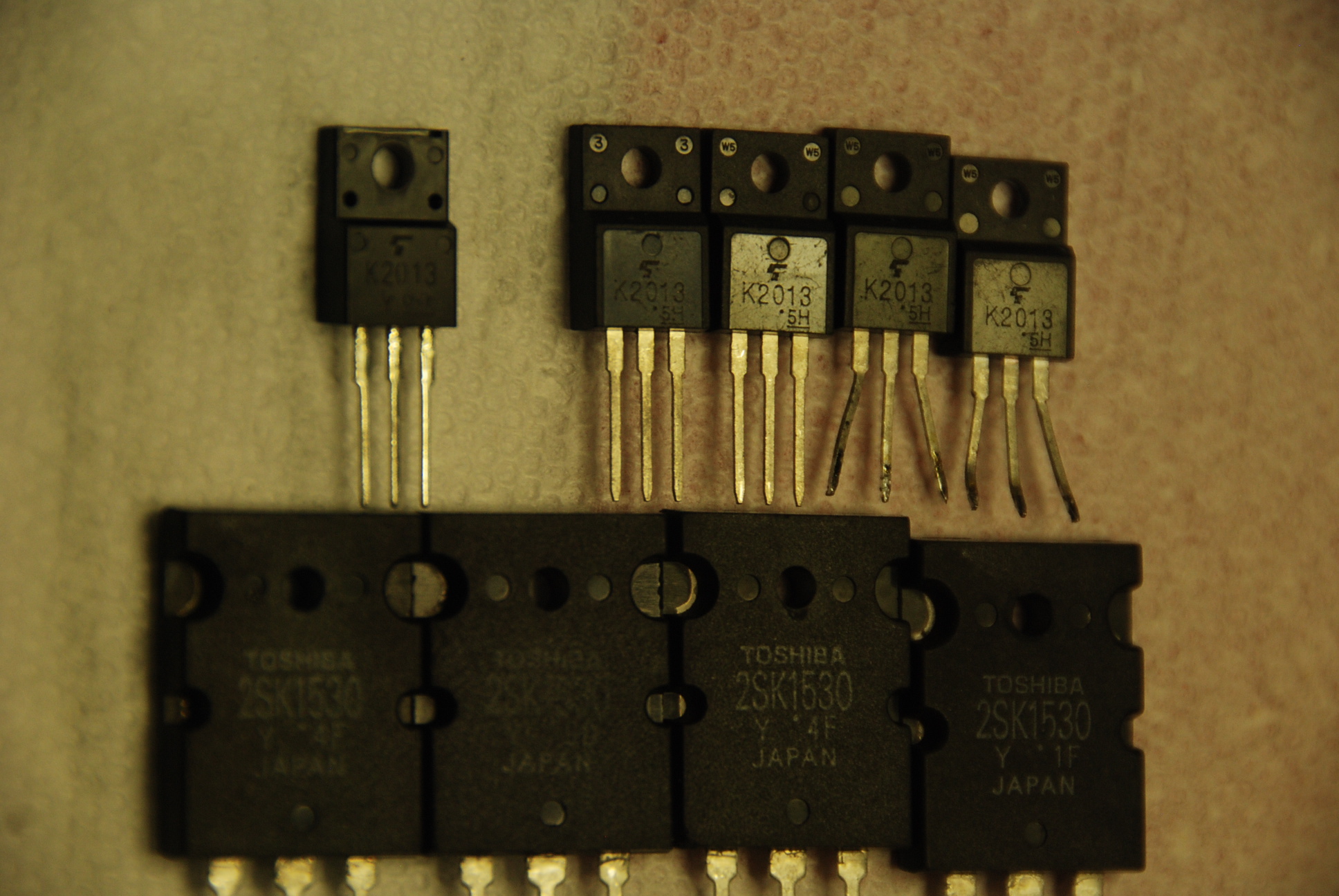

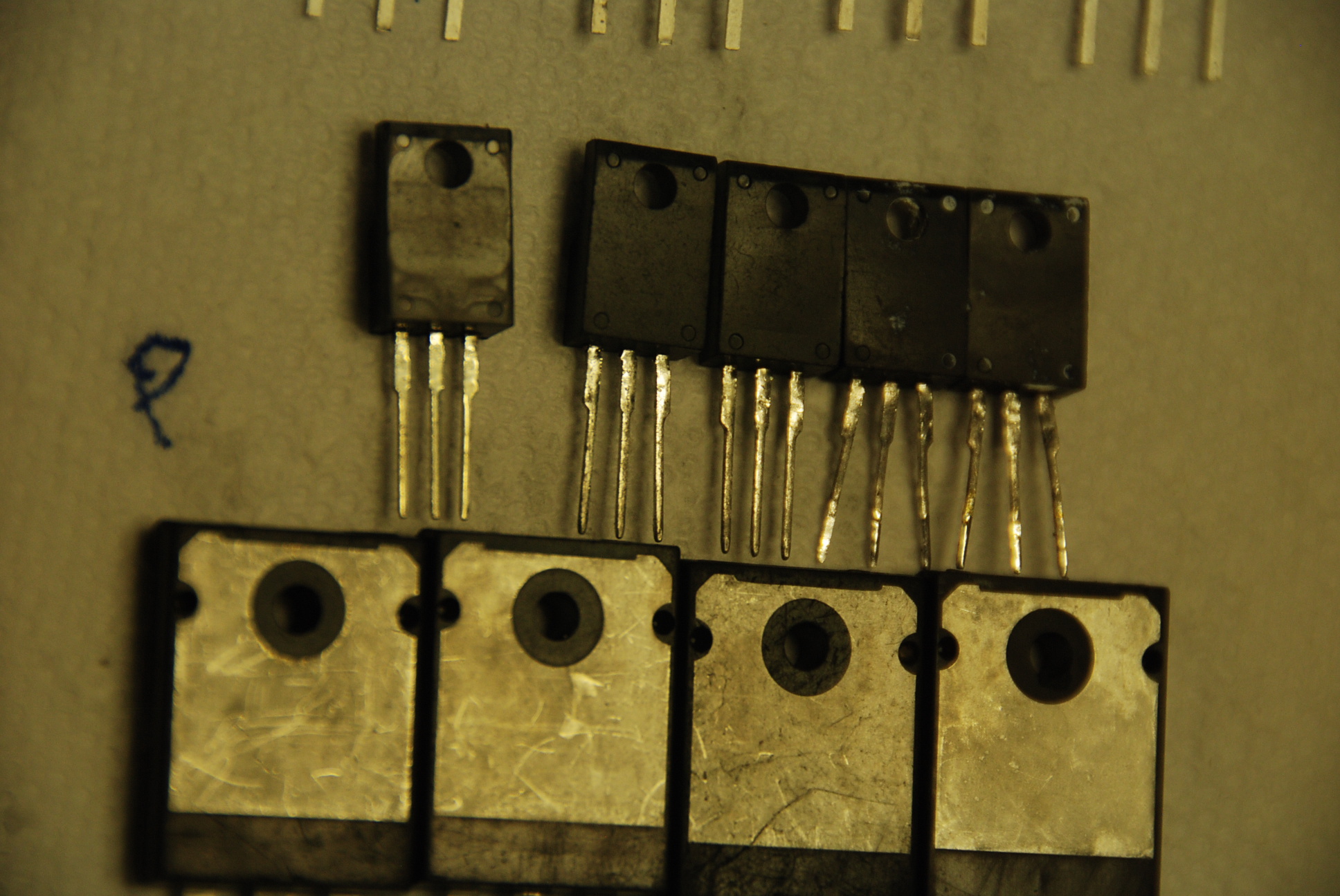

I got the Nikon out and I hope you can see the transistors with greater detail.
Sorry about the lighting.
Photos of the face then the back. I marked "P" & "N" on the back so you could tell which was which.
Zhou Fang's is the TO-220 on the left in all photos. I don't have any more 2SK1530/2SJ201's to compare. The 2SK1530's look like they might be Toshiba, the 2SJ201's have the sanded face like the 2SJ313's do, so I bet they are fakes.
The 2SK2013's look different than Zhou's with a ridge around the face and other noticeable differences in the case as you can see.

Ah, that's a very clear photo - thanks.

fab,
Zhou's look a bit like Batman's ears (in these photos) caused by a small ledge moulded into top edge of the package - the fakes are just plain edges.
The fakes have numbers and letters moulded into those circular depressions near the "ears" - Zhou's are blank.
On reverse side, Zhou's have 4 shallow circular depressions - the fakes have 3.
Don't think the numbers and underline are a reliable indicator.
