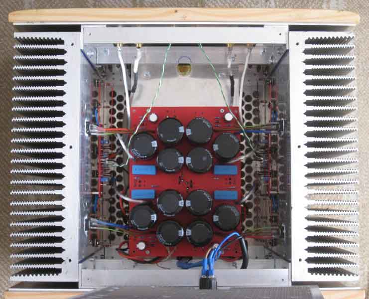

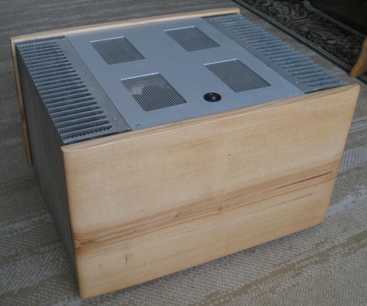

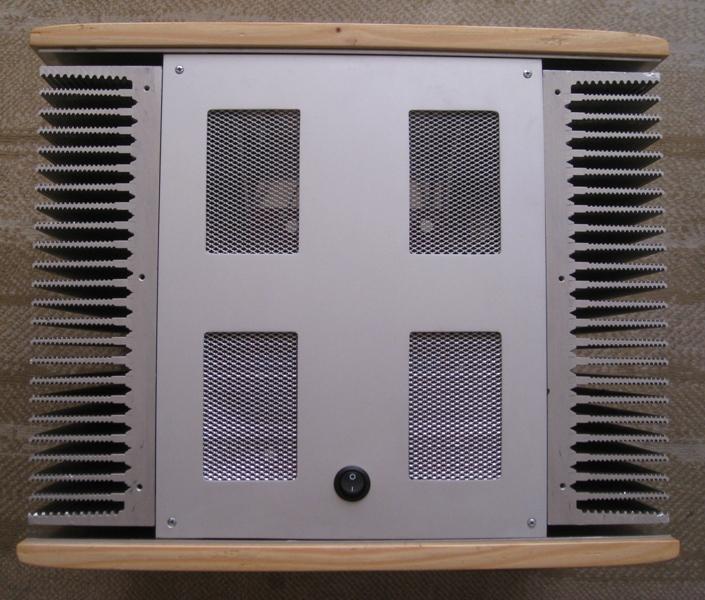

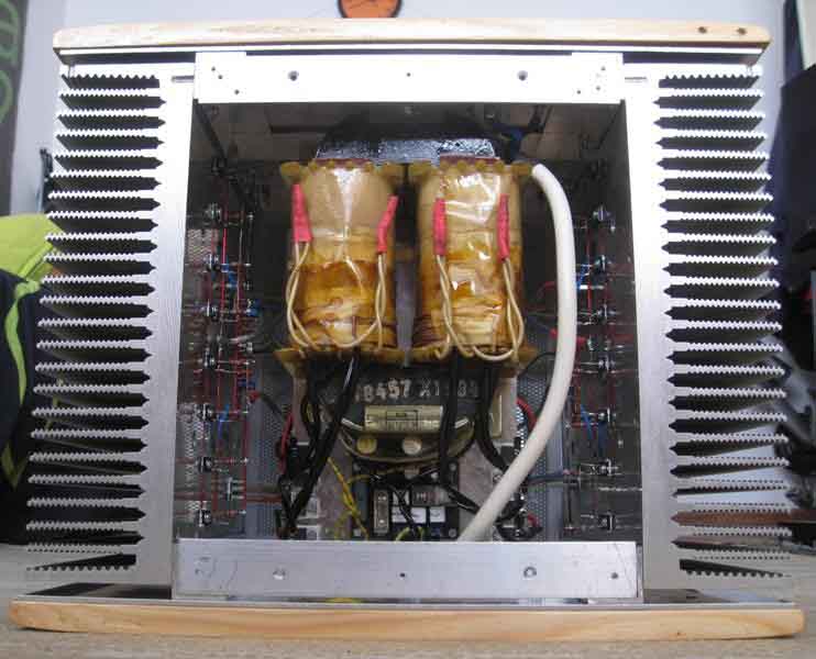

One more amplifier done 🙂 Few more pics at baby diya
Complete amp and case are home made. 4 pairs of output MOSFETS, 1,6A bias.

Nicely made chassis. Very generous HS. It shouldn't be too hot, isn't it?
What did you use to cut square holes on the top plate? CNC? And how did you fix the grill to the top plate?
Best regards
