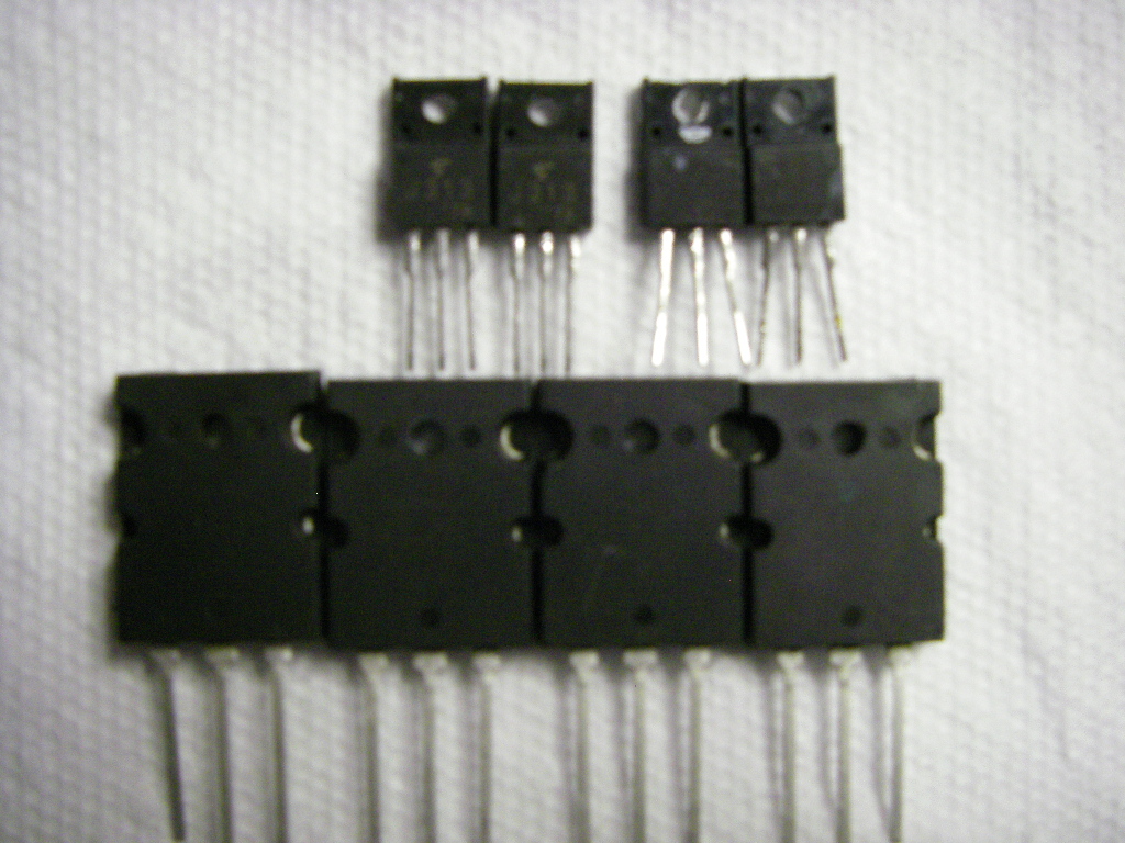

Thanks for the input. I will post some pictures, which should help determine whether the parts are original or not. Any quick tests I can perform? Thanks.

Thanks guys forthe heads-up about the fake 2013/313 - I had a good look at the ones I got from 'utsource' (supplied in tubes) and have also found them 'non-genuine' - the body of both the 2013 and 313s are slightly wider, the letter 'A' and the number '13' are moulded into the top edge depressions ('I' and '14' on the 313s) and doesn't have the strange lip on the top edge - also, on the back, there are 4 dimples on the genuine ones but only 3 on the 'other' ones - leads are different also.
Hope I can get a refund, too.

I bought 4 each of 2SK2013/2SJ313 and 2SK1530/2SJ201, 16 transistors in all.
I used a pair each of the 2SK2013/2SJ313 and had thermal stability problems. I eventually switched them out for some I bought from Zhou Fang and the issues went away. The amp is stable and sounds great.
I read here about the fakes and mine look just like the photos referenced and sold by utsource.

I have some from Zhou in stockpile. Would it help to take more photo's, measurements or are we good?
Rush,
Can you show the funny little lip at the top of the Zhou ones and the three dimples on the back - a few of us have the 'utsource' ones that are quite noticeably different - don't know if your camera will focus this closely.

I wasn't impyling problems with Zhou, only that I might be able to get some good shots of them close up.
Yes we know Zhou's are the real deal and i agree a good closeup of one would help to show the difference to the utsource fakes !
when in doubt break open and if insides have big dye................fake!
