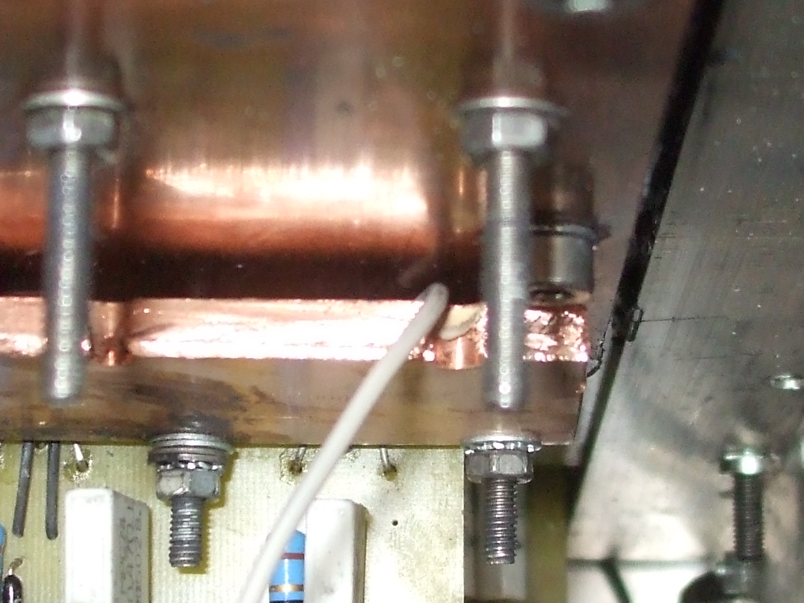

How did you mount them to the heatsink? That TO-220 case looks weird. How many watts are they dissipating?

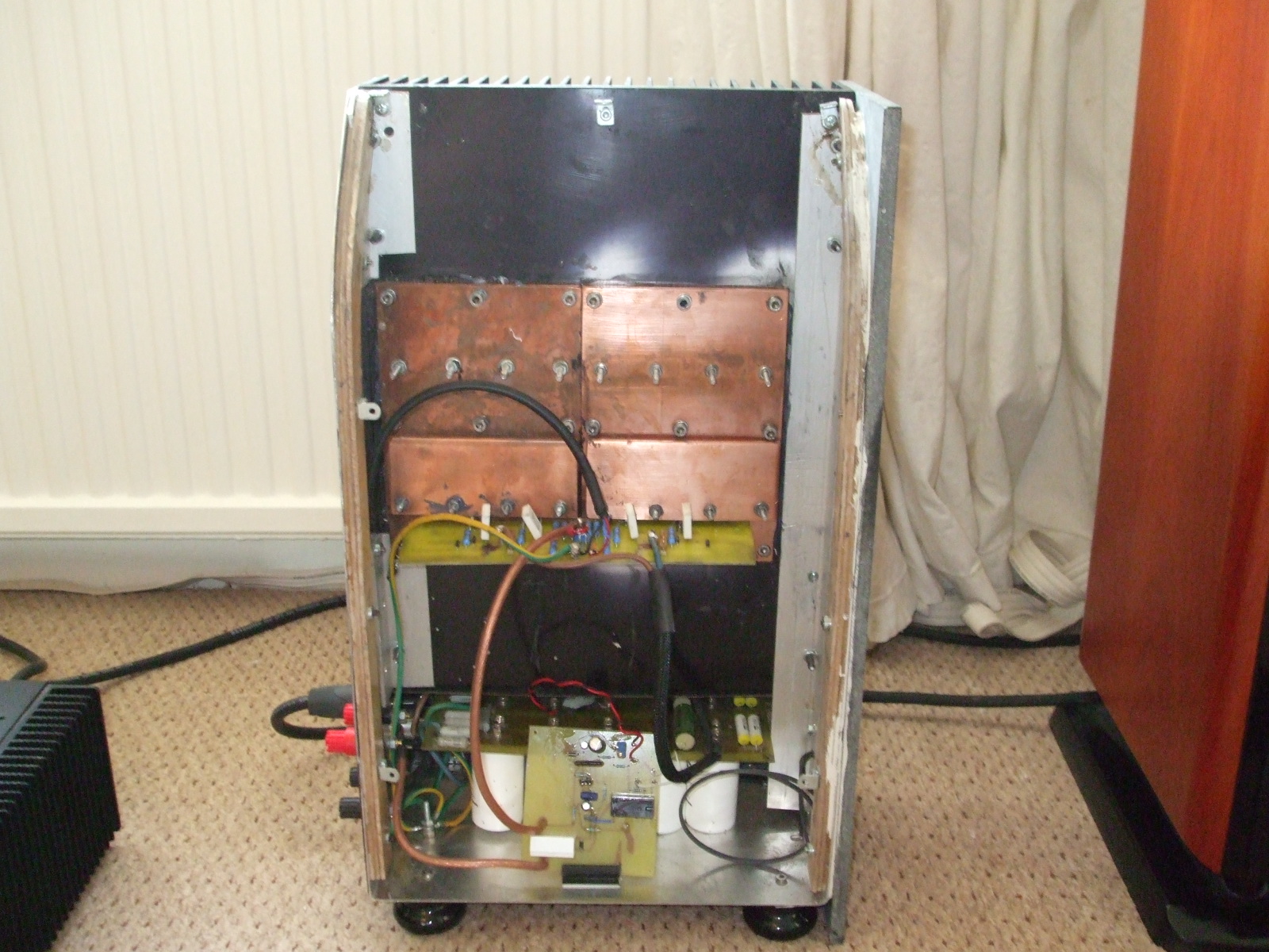

Same as i did for the TO247 or even the toshibas
Big piece of flat coper bar and 2 M4 (metric 4mm) bolts on super duper heat spreaders.
32V 1.3 A or 26 V 1.8A depending on the mood I got 100VA trafo with taps at 20 and 24 V
About 160 watts on each sink and recon they shuld be good for around 250 W whitout going over 50 C mark.
I am using Kerafoll 86/83 and with the bolts I can put loads more pressure on them than with litle M3 single srew.
Kerfoll show graph of thermal resistance against pressure on data sheet.
Loads more about it on MY F5 tread.
The grey wire in the first picture is a PT 100 probe I have used to monitor the TO220 case themperature
If you post there I will be happier to ansver any question you have witout boring soks off the rest of the population and hi jack this tread.
