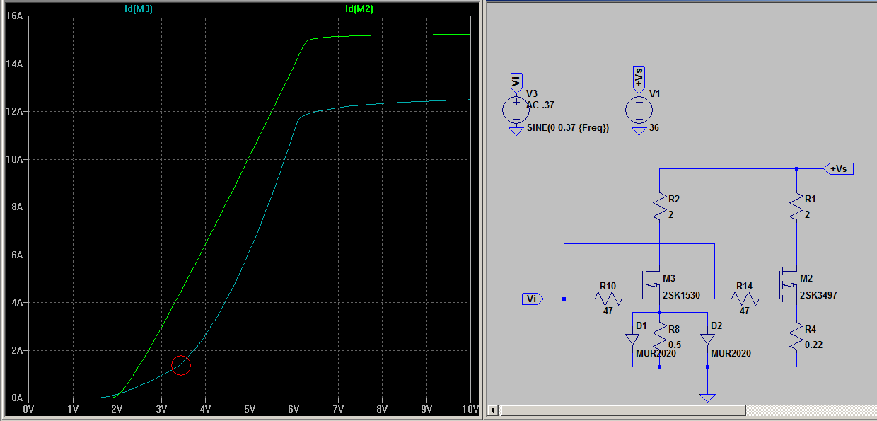

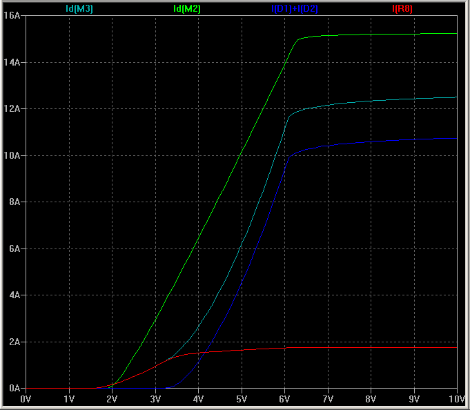

Further to the discussion in post #7 :
http://www.diyaudio.com/forums/pass-labs/206240-f5-turbo-posted.html#post2896992
We have done some simple Spice simulations to compare the two output arrangements.
The attached figure shows in green the Current (Id) vs Drive Voltage (Vg) characteristics of the 2SK1530+0R5//MUR2020 in grey-blue, vs 2SK3497+0R22 in green.
The sharp knee point circled in red is that at which the conduction of the diode becomes prominant.
The simulation is not 100% reality, as the models are room temperature based and probably somewhat simplified. But it does show clearly how the characteristics of the 2SK3497+0R22 being dominated by the resistor, due to the much higher Yfs than the 2SK1530 at the same bias.
The upper knee point at Vg~6V is due to the MOSFET running out of Vds headroom (largely due to the 2R load resistor I added to the top rail).
Patrick
