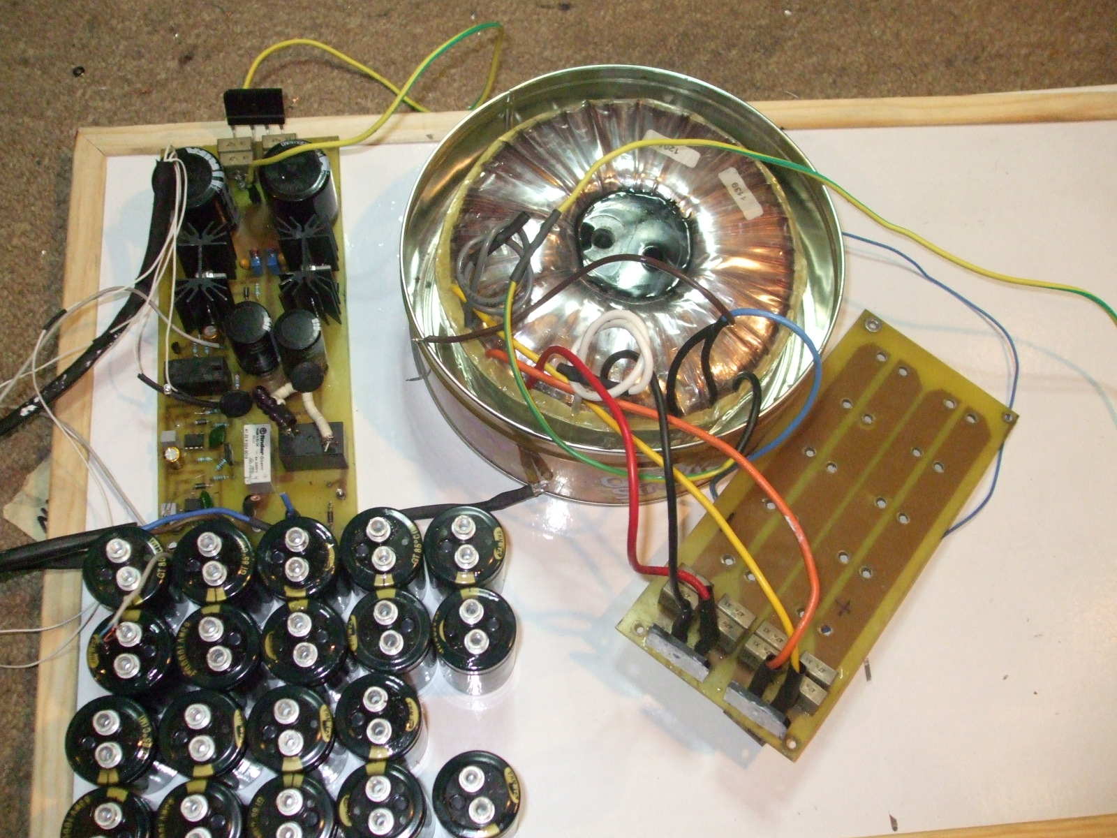

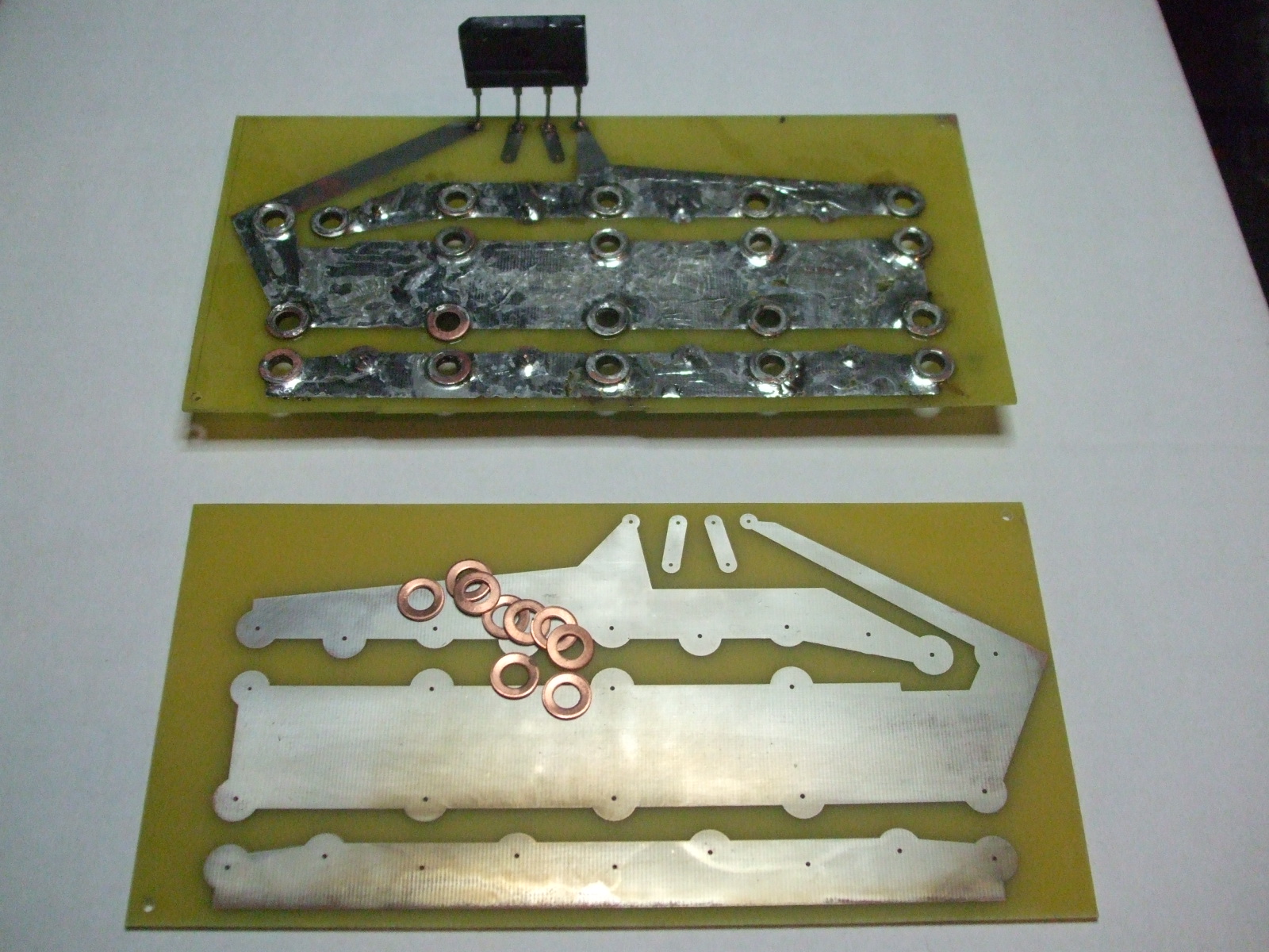

cuple of boards from one running since Last August
