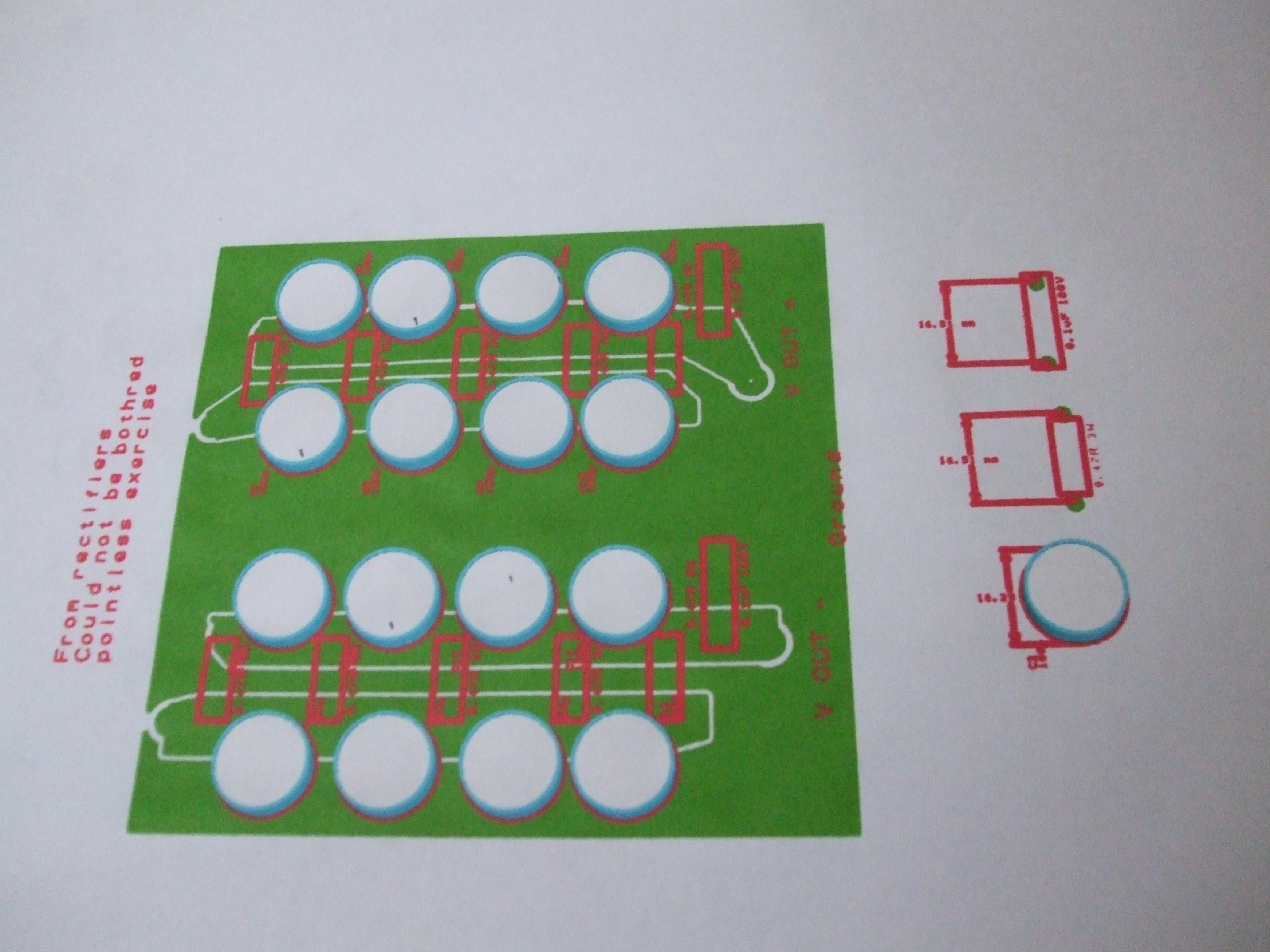

I posted the lay out for how IMO capacitors board could be made simpler with less track lengths and such all is needed is the bit for the rectifiers (again I do not intend to but in see above)
Track thickness can be really large and different size capacitors just need extra pad on the Ground plane.
Low impedance and current caring capacity is really important here

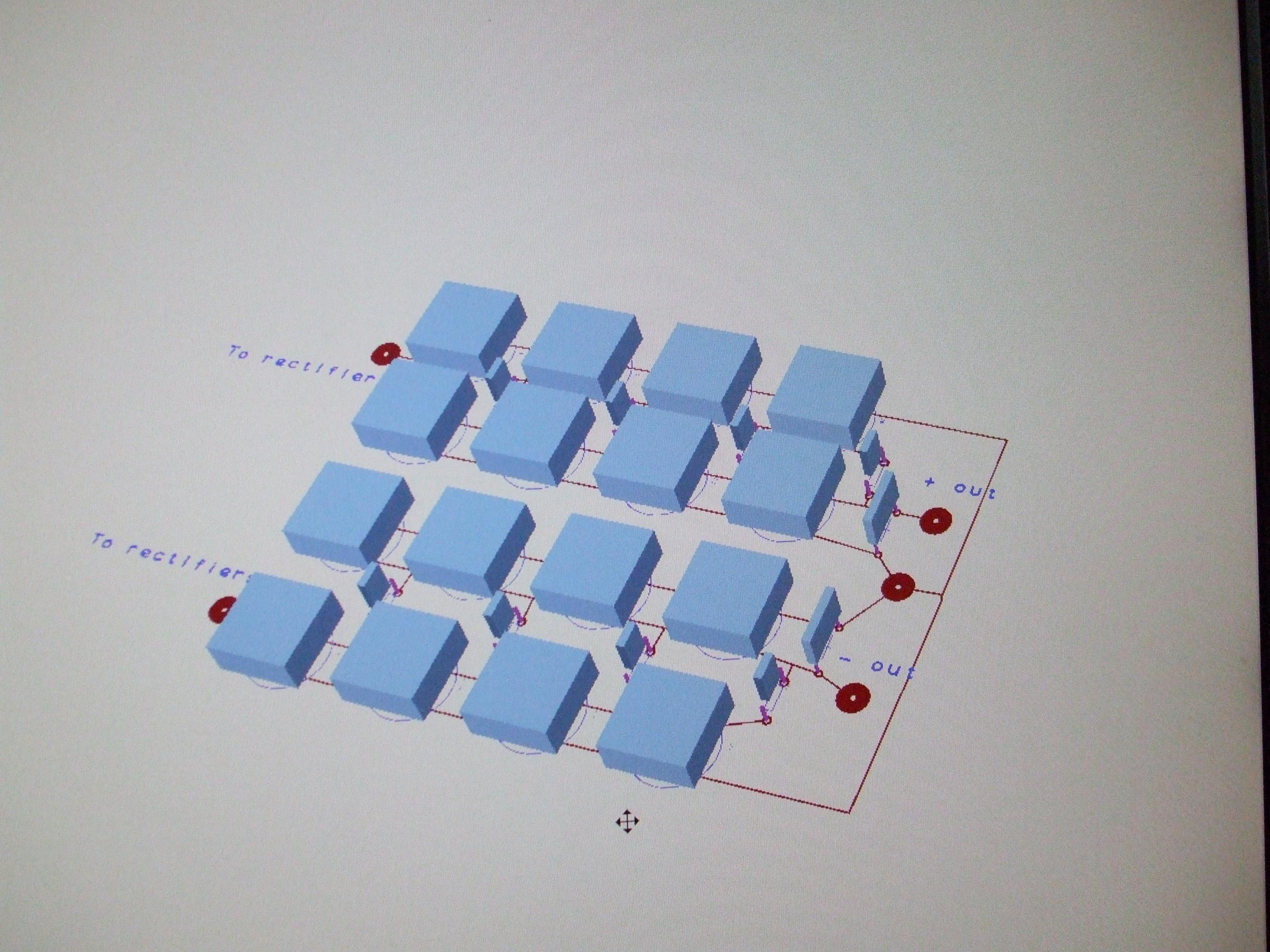

To make it easy to see here is a couple of 3D views with copper poor areas and basic track

What obout the track rooting (again no ego involved here) would you think that 1 single straight track is beter than loads of track with loads of bends
Don't get me wrong bend and duble layers make it look pretty but I think we are not going to put one of those at the Biennale.
Cost wise one get charged by board size and number of holes.
It is actualy cheaper to leve as much cooper on the board as Acid get changed less often but you will get no discount for that.

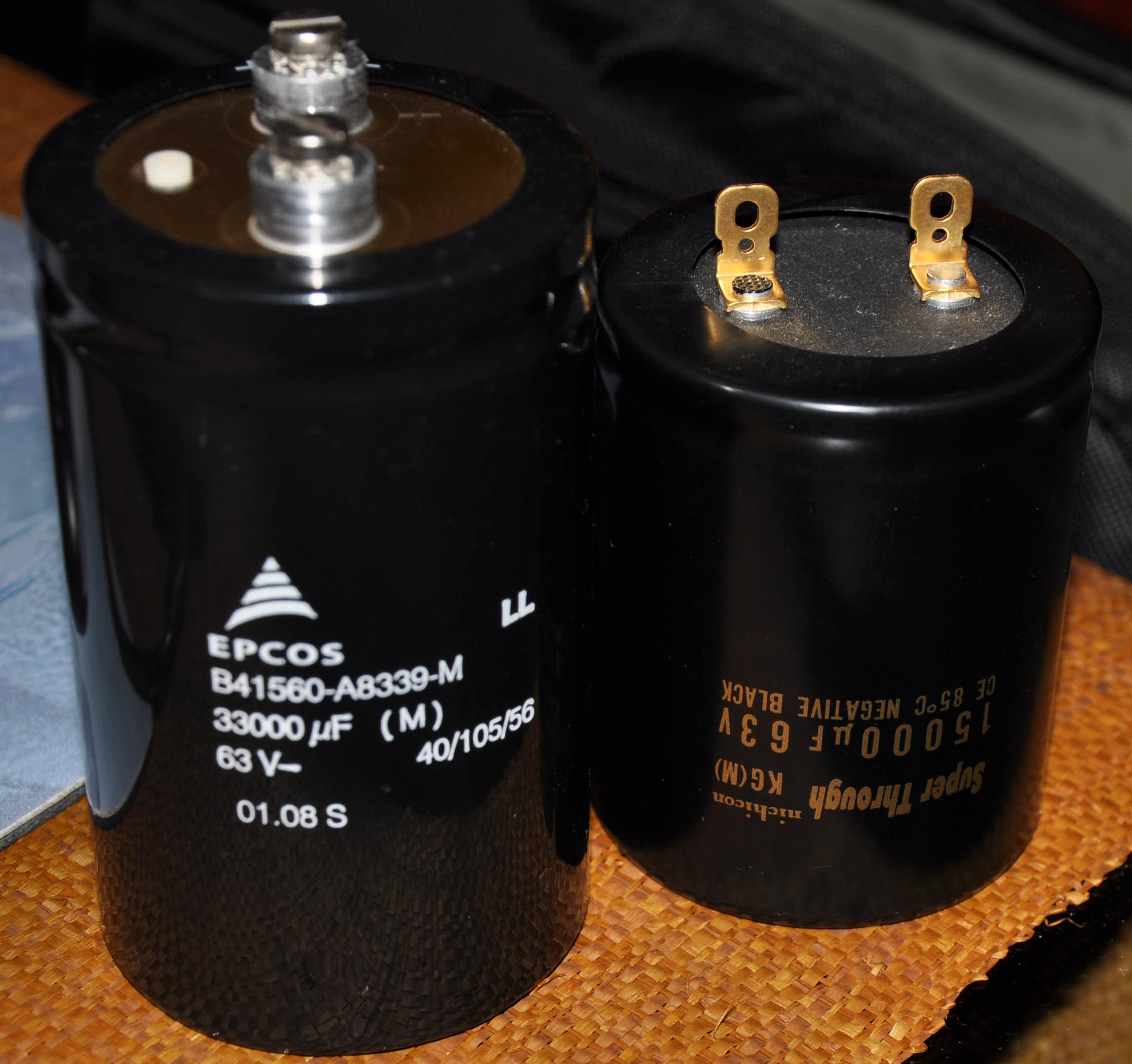

3- Uktoecutter assumes that we will all use small caps ( like Papa has truckloads off ) ..I for one will not for the simple reasons that i don't have tons of them and this board takes up a lot of horizontal space , a PCB like PA's posted earlier by Jacco is better in my opinion, uses fewer and bigger caps.
4 - I know these bigger caps are more expensive and capacitor plate surface area is smaller than a lot of small caps....but engineering is tradeoffs....

What is size of cap you are dreaming about The one of board are 6 mm pitch tiny litle ones still 63 V 10mU
