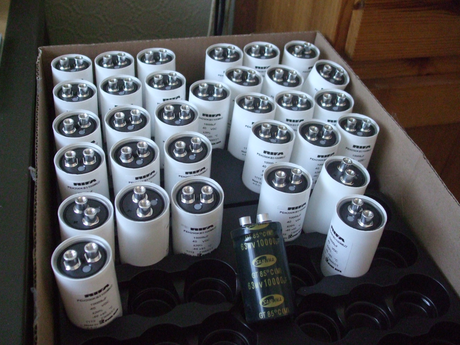

If you like screw mount capacitors there you have it.
Eswa 63 V and Rifas 40 V
