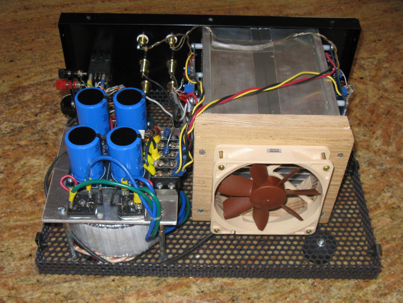

Monoblock: .6 cu ft
This monoblock configuration would work for a 180 watt F5-turbo.
The dimensions are 15"x11.5"x6". It might need to be slightly larger for the bigger toroid transformer. I have actual temperature measurements for 2 x F5 channels at 65W dissipation per channel with only 12C-14C temperature rise.
