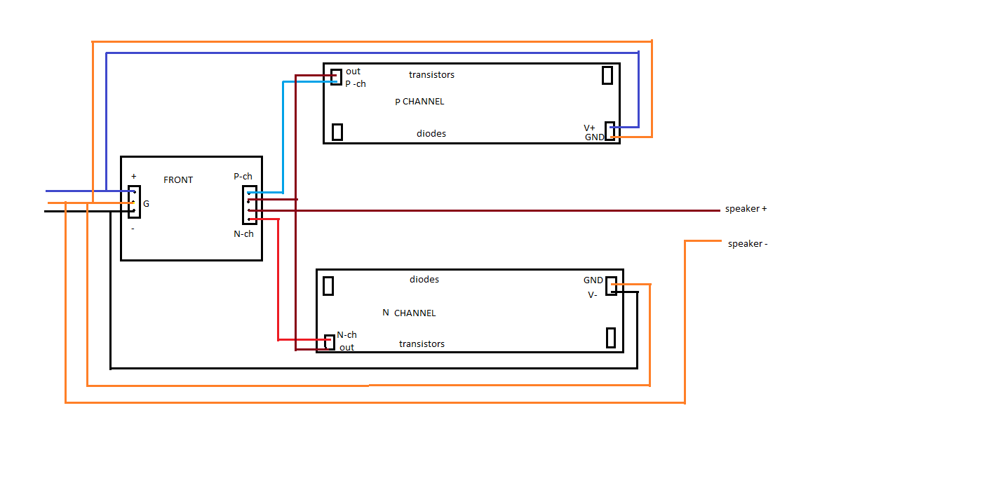

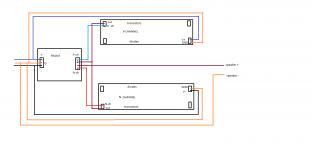

I've searched but have not found a helpful guide to the wiring on the latest store boards I've started my build but a little confused on how to link up all of the OP connections etc.
and what is the link connection use for?
If memory serves most of us will connect the "link" to ground. Those building an balanced "X" version will use it to connect to the other front end board to make it an X amp.

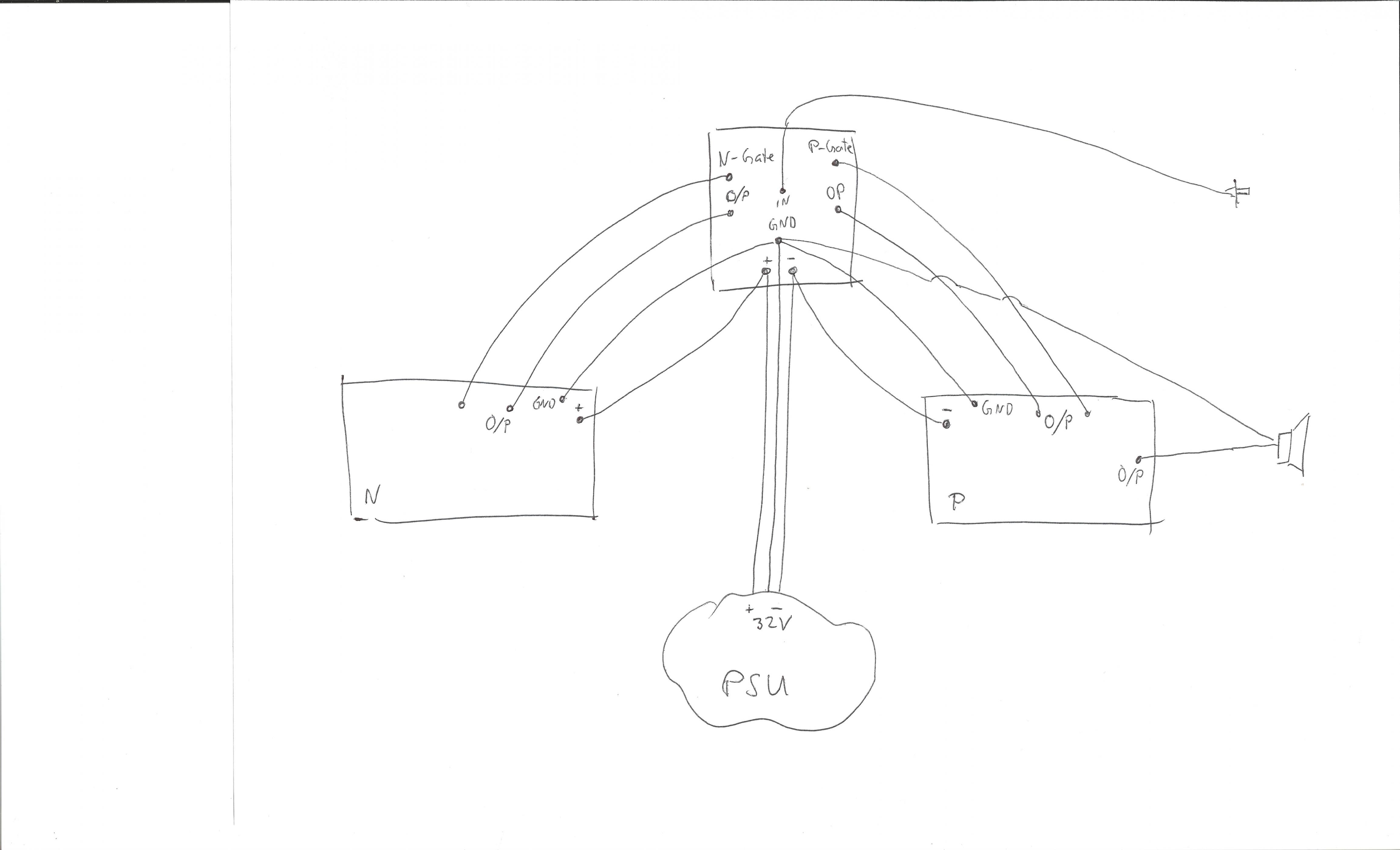

Question regarding wiring of diyAudio pcbs.
Please see my litle principle sketch below. Does this make sense? Especially the O/P to the speaker!?
I'm wondering if it makes a difference when I use the very right side output connection from the pcb instead of the centered O/P connection of the gain stage pcb.
Thanks in advance for your help!!!
here is a drawing from the old Boards. but the conections are about the same.
the link is used just for balanced amp configuration. With a standar stereo amp the link is shorted to sig. gnd.
Is the link the only difference between SE and balanced? obviously, the inputs will be + and -, but do any parts values need to be changed?
there will be som value changes. but there is never made any schematics with values for a balanced version. as far as i know.
