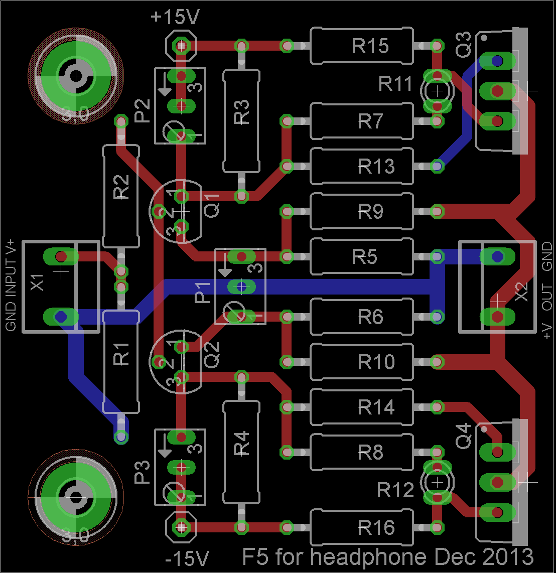

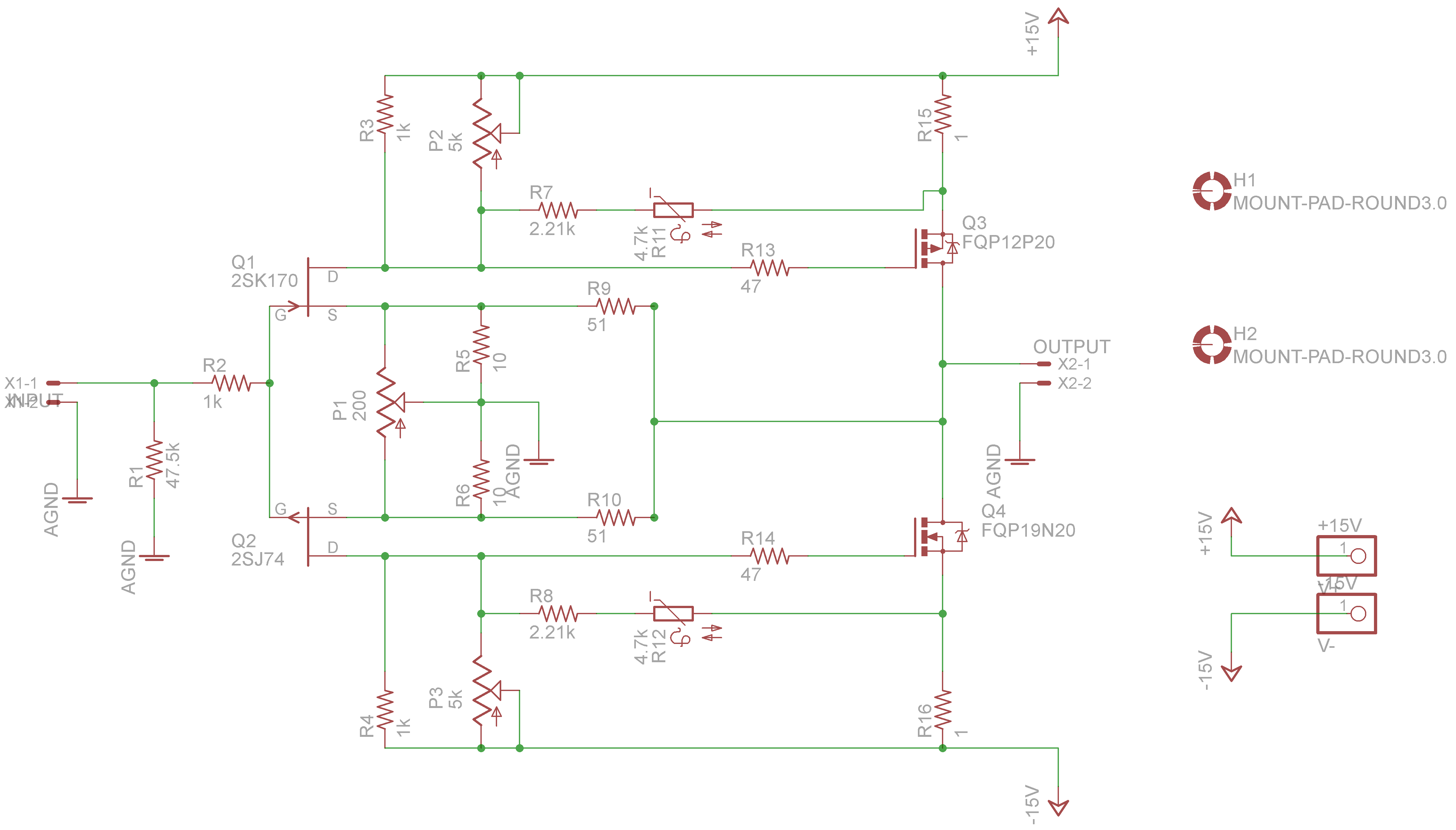

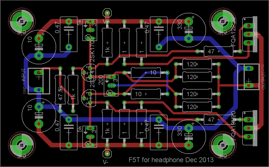

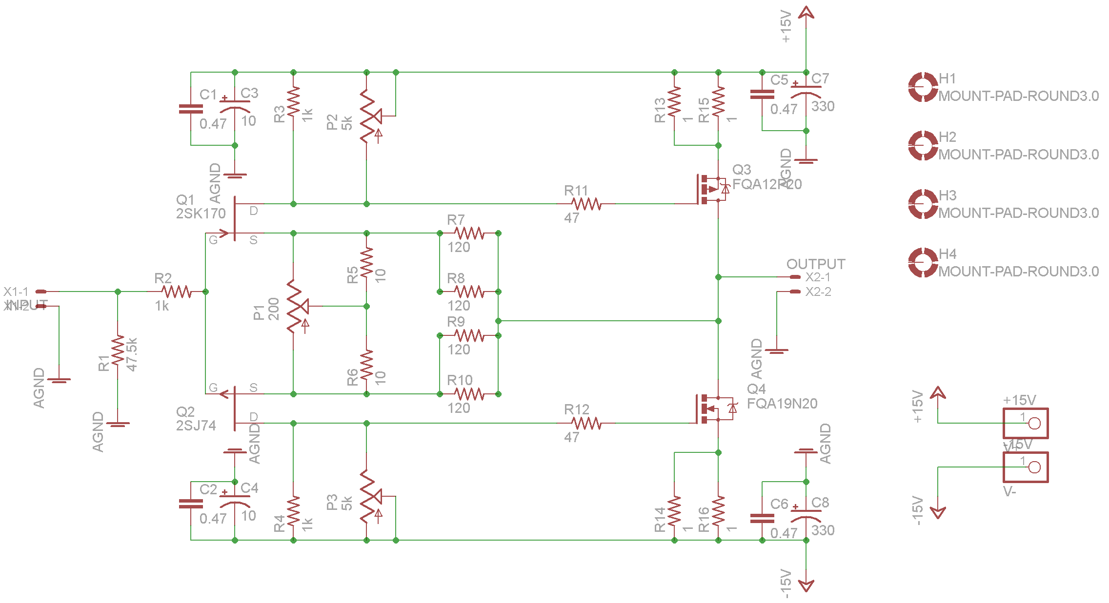

I am going to build a scale down version of F5T for headphone. For simplicity sake, (1) the current limiters are removed and (2) the thermister are also removed. But, I am not sure whether I have to retain the 2.2k resistors attached to the thermistors in the original schematic suggested by NP. 1/4W resistors will be used except R13 ~ R16, which are 1 ohm non-inductive rated at 2W. I am going to bias output at 100 ~ 150mA. Any comments on the schematic and PCB layout?

you dont need dobble up of source resistors and feedback resistors.
but you might want to get the source resistors close to the output transistors.
you don't need TO-247 transistors. TO-220 is plenty. you can also drop C1-8.
and it is not a scaled down F5 turbo, but a scaled down F5🙂

I used TO-220 footpin in the PCB for the MOSFET but did not change the FQA to FQP in schematic. Sorry for the confusion.
You are right. At low current, it may not necessary to double the resistors. I will re-allocate the position of source resistors after the deletion of the doubled resistors.
Regarding the 10u caps., they are founded in the Turbo V1 schematic in the Pass article. The 10u caps are not seen in the original F5.
Agree with you. The 330u may not be necessary. Because 100mA constant current is more than enough to drive most headphones that 300u caps are not needed for high transient load. Is my understanding correct?
and i would not drop the thermistor circut. it's there to keep the bias stable.
I am planning to mount the MOSFETs on the chasis.
I though that it can make the amp thermally stable.
Yet, adding a resistor and a thermistor is easy.
I am open here.
