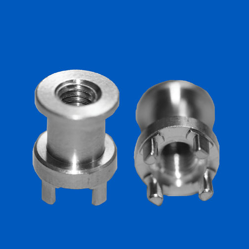

There are serial manufacture metal blocks for PCB mounting, either with multiple solder pins, or a threaded end.
Mounting side is either a screw hole, or also a threaded end for a nut.
Smallest ones are 0.2''/5mm diameter, see example pic, rectangular ones are 9/32'' .
Smallest disc spring is 6mm diameter, also see example pic.
For an M3 ring cable lug : mounting block - cable lug - regular washer - disc spring - screw head.
