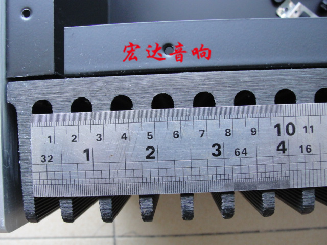

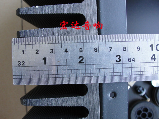

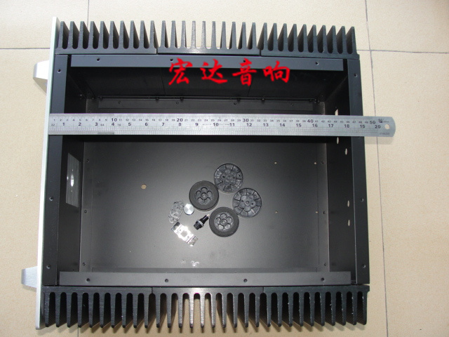

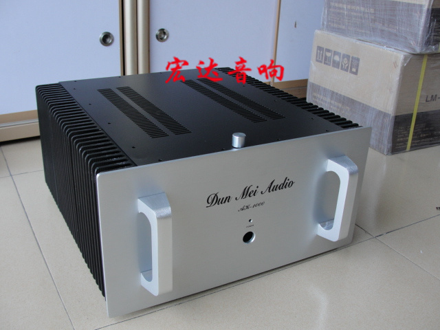

Hi Guys,
I'm looking for a little guidance. I just got my F5T kit from Buzzforb and I'm looking for a case. I'm working in China and I found this case and wanted to make sure it's suitable. Being American and mathematically challenged doesn't help.😕 It is also a bit confusing using Google translate to find things. It seems to me this one should be fine?
There are three heat-sinks per side which are 16cm wide, 23cm tall and 6cm thick. I was hoping to run the F5T at or around 50 watts. See pics. Your guidance would be appreciated
Hi Guys,
To me it looks more than good enough for a 50W F5T. A pity you don't have the specs for thoses sinks though just to make sure.
PS: Just use an 8mm spreader plate to distribute the heat evenly accross all 3 of the sinks on each side.
Thanks Henry. I will use a spreader plate to allow for heat distribution. I'm not sure if the seller would understand what I'm asking, if I asked for heat sink specification. He would probably give me the size again?
It's bigger than the 5U case so I thought it should work. The sinks combine to be 480mm deep and 230mm high. They are also thicker than the 5U 40mm sinks, they are 60mm.
The case is also much heavier. 23.5kg compared to 15kg.
It is about $200 shipped. I wanted to make sure though.
The fins are really thick for their length so the whole fin will get nice and hot. Pity they did not take advantage of that thick root and make the fins 70 to 80mm long.
Using 3 separate sinks requires you to ensure the whole backplate of each sink runs at roughly the same temperature. 25mm by 10mm copper bar bolted along the width of the sinks, one just above the F5 and one just below the F5, i.e. nearest the hottest part of the sink next to the devices. 2m of copper bar would do for all six sinks.
Thanks Andrew.
I have found some stores that sell only heat sinks. I'm not sure if they have something more suitable or not? I will also inquire about having some made with longer fins. Here in China everything is possible.
I found flat copper bar on taobao. I will need someone to help me look through them and find something suitable. I assume that if it's wider than 25mm it would be ok? I found some that was 50mm. Anyway I will keep looking.
excess width is better.
But do not reduce the thickness. You need very low thermal resistance between the individual sinks and high section area of the bar gives this.
