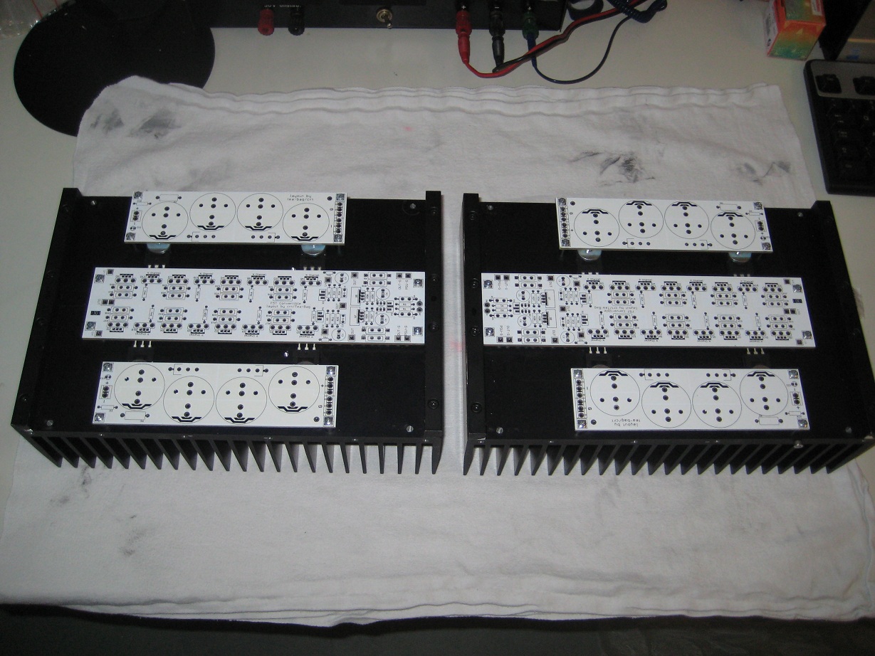

HeatsinkUSA can get machine work done from a machine shop nearby at reasonable cost. Below I attached some pdf's of some drawings I sent to them for 2 monoblock F5T, using c'viller v2 boards, in case that will help anyone. The total cost was very reasonable. The holdup now is that I am trying to find an anodizer locally for a fair cost. The layout is similar to buzzforb's and looks like 2 large mono ACA's. I am using 6" heatsinks on the sides and polycarbonate for the top/bottom/back. The PS is a dual mono in a different chassis. I got the copper plate (for heat spreader) and angle steel (or aluminum) from Online Metal Store | Small Quantity Metal Orders | Metal Cutting, Sales & Shipping | Buy Steel, Aluminum, Copper, Brass, Stainless | Metal Product Guides at OnlineMetals.com. I am using mica under the FET's with Quantum heat sink compound from TIM-Consultants - Thermal Grease Specialists which is cheap and tied with the best from a test. I can email an interactive 3D view pdf (4.3meg, too big to attach) if anyone PM's me.

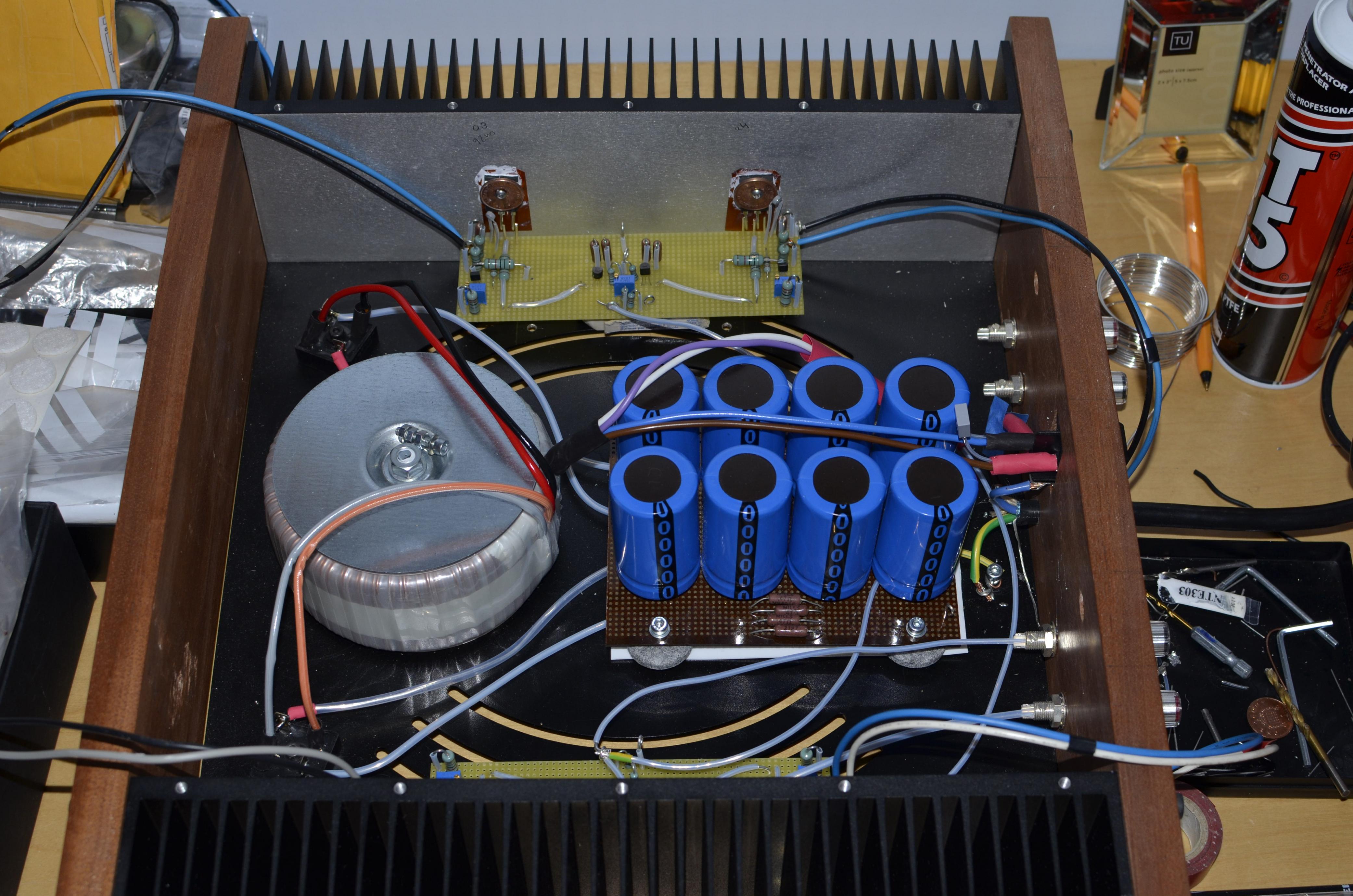

I followed your advice and here is what happened.

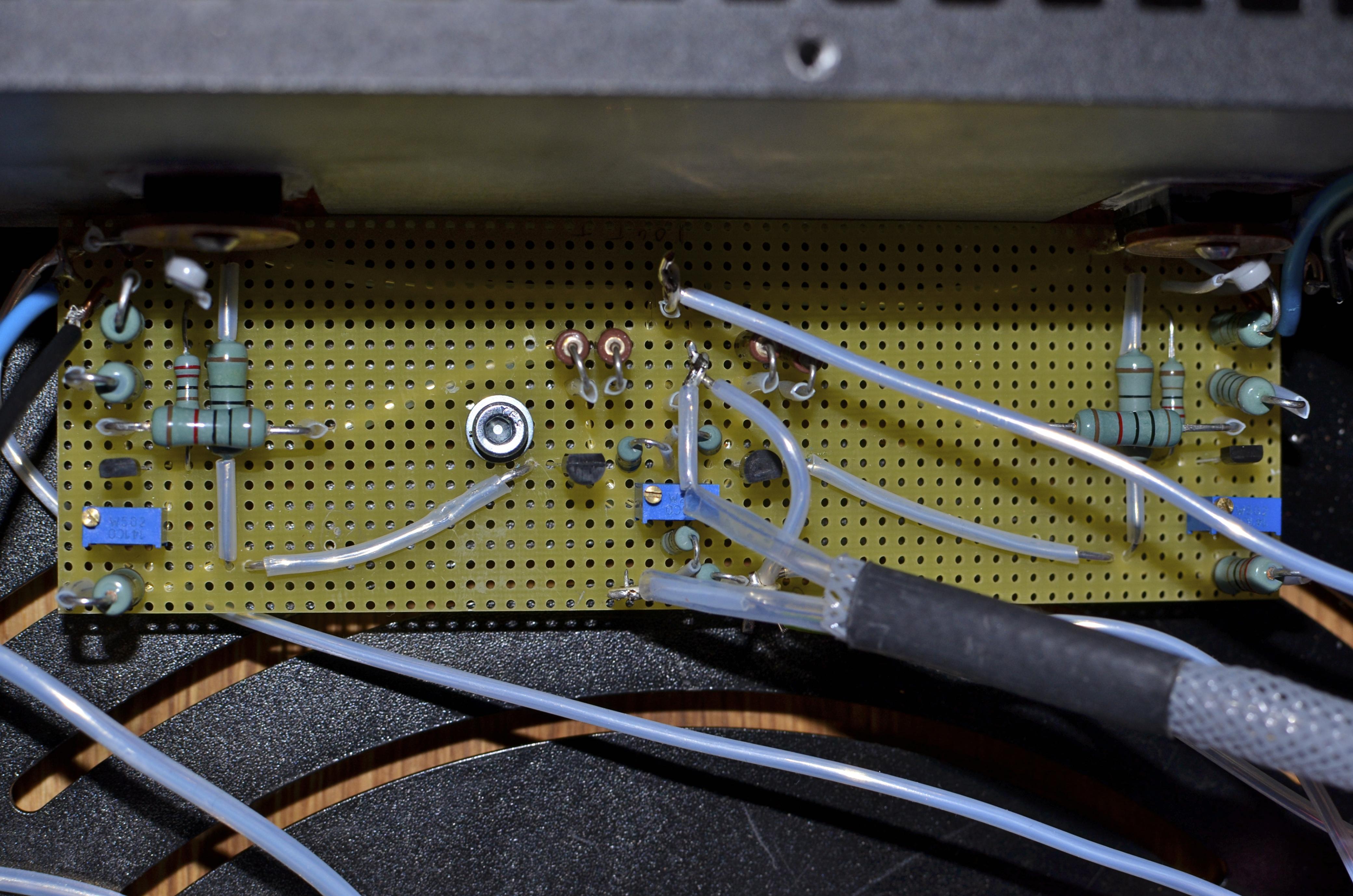

Left channel is ok. Right audio board, however the little FET J74 / Q2 smoked, so I quickly shut the power down. Waited a while to cool and then powered up again this time quickly turning pots to bring output voltage with no load from 7v to about 0.2v on the output. Then added input (2v from preamp) then my expensive speakers. Nothing! not even a buzz 😱
I'm guessing now, I may have made a mistake by wiring the two grounds from input to R1 to ground between R3 and R4??
Any other tests I can do to enable me to sort this out and get some sound out?
Appreciate any good advice

Steve - well-lit, in-focus photos of your right channel board please, specifically around the input jfets and grounding. I'm not followng what you are describing in regards to R1/R3,4

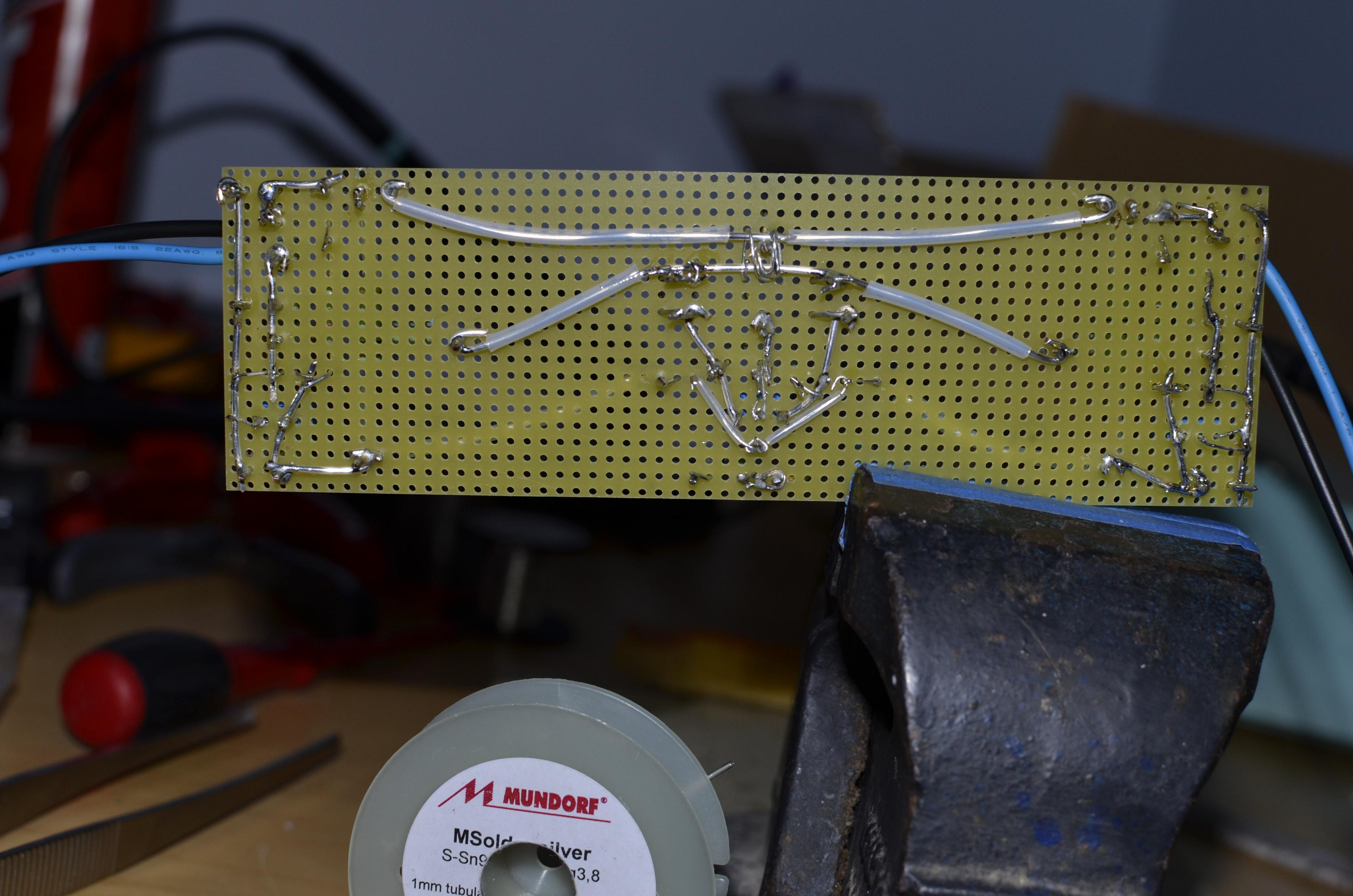

I have attached some photos which I hope make some sense. As I have used point to point wiring, shown photos from top and underneath for you. Hope they are clear enough?
Thanks for offering to help

Steve,
I would not trust any Toshibas bought on eBay. You may have found source of your problem. Otherwise, I would suggest trying again with fresh layout. Tough to P2p an amp. So many places to make mistakes.

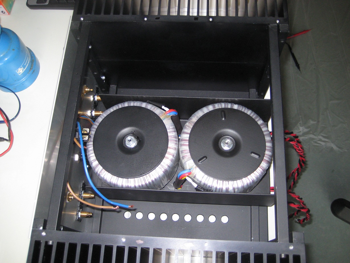

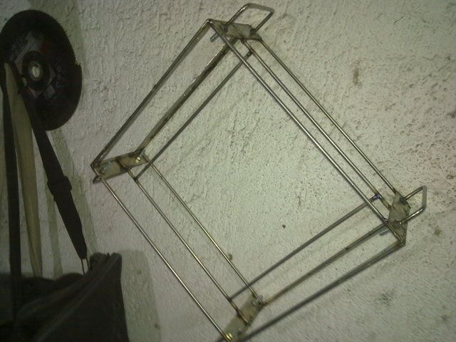

This was made to hold that heavy load of 25Kg in place - 11.0 Kg of heatsinks, 8Kg of transformers, 2Kg of parts and 4Kg of Aluminum plates. Below is image before metal partition sheet to be welded and only frame was ready. Its lightweight only 1.5Kg.
Hi Omishra, I only now see the pictures of your amp. That's some nice peace of work!
I'm going to study your pictures to see if I can have some smart construction details from you...😀

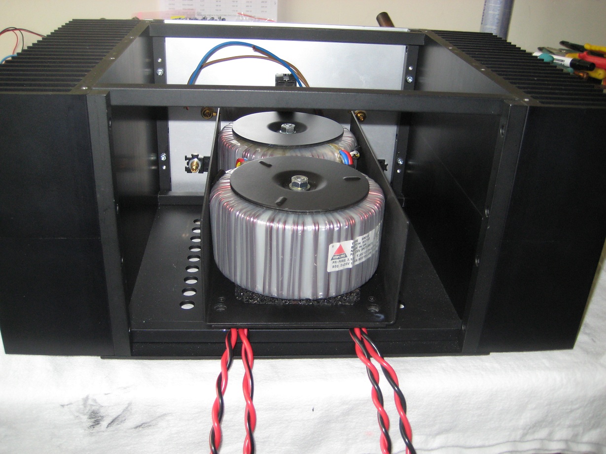

PSU is build and tested, it's modular, it can be removed as a whole from the amplifier.
All the nasty and noisy rectifiers are shielded under the transformers...

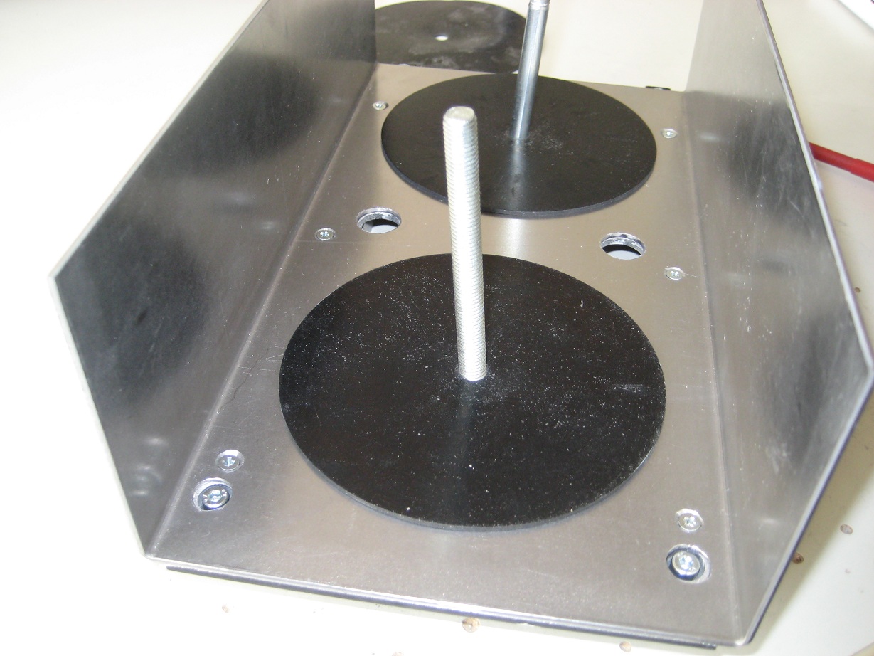

ZM told me the rectifiers would be warm 😀, so I made a U-profile for extra cooling and at the same time shielding for the large 625 VA transformers. Also the thick rubber is his idea...Yes I do listen sometimes😎

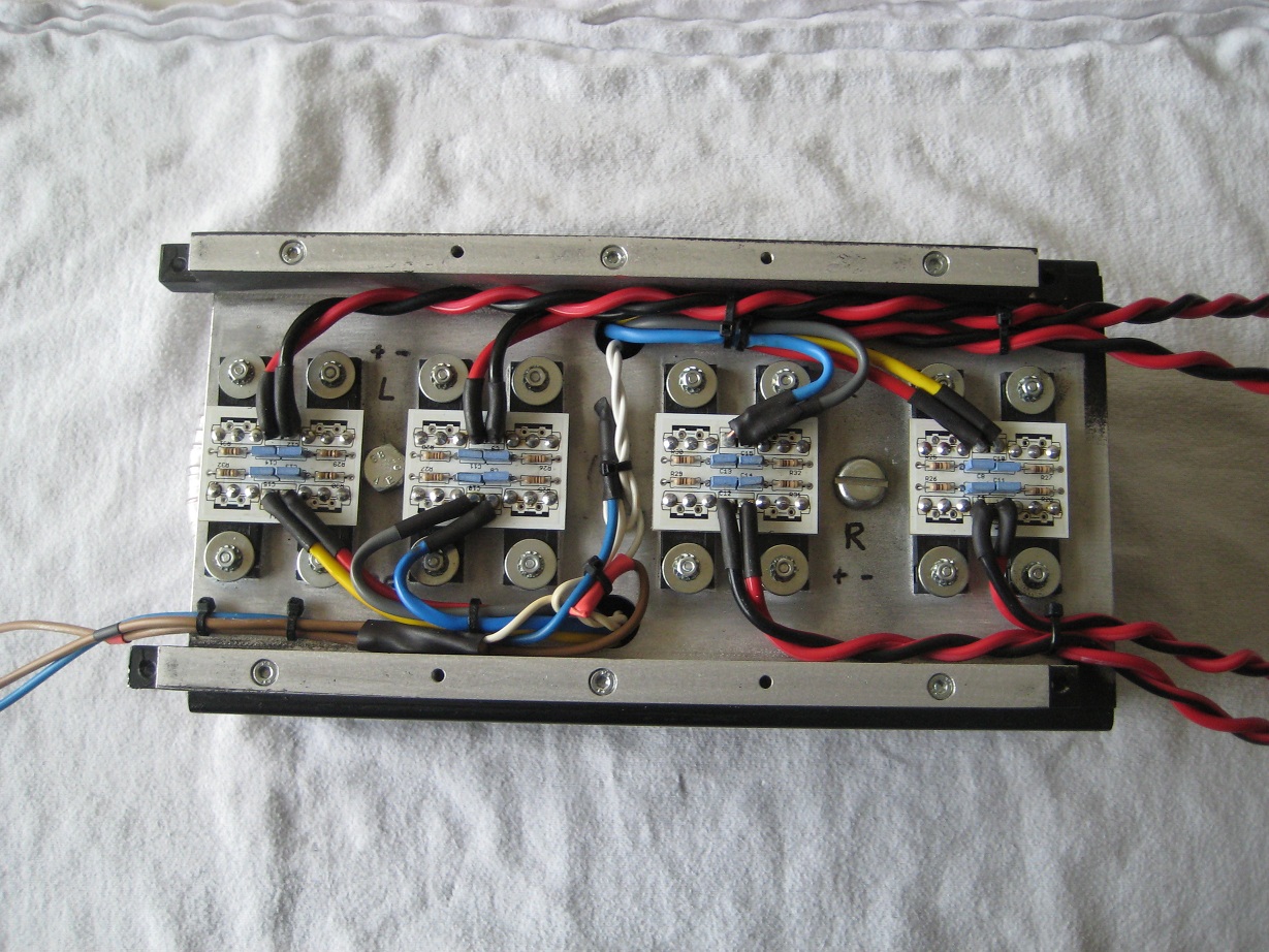

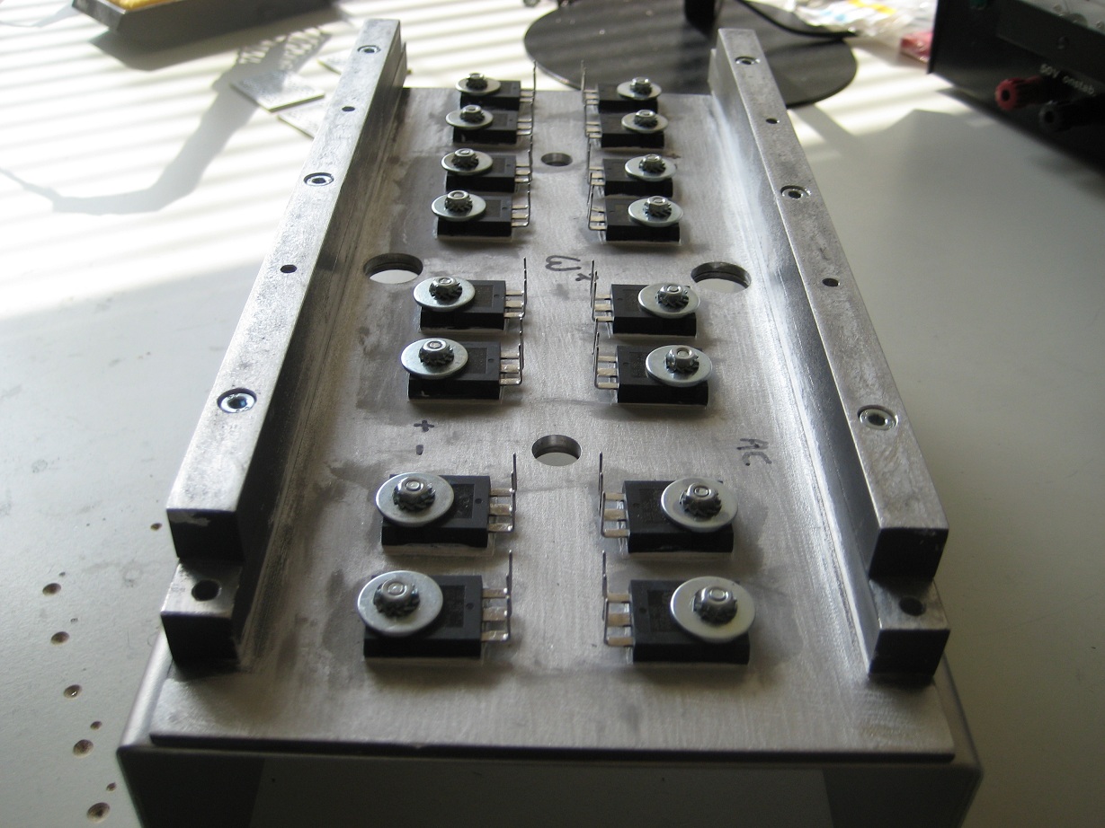

All PCB holes in the sinks are drilled and tapped. All transistor's are matched and selected, just like the resistors.
So now the nice part of populating the PCB's starts..."bestücken" yeah..

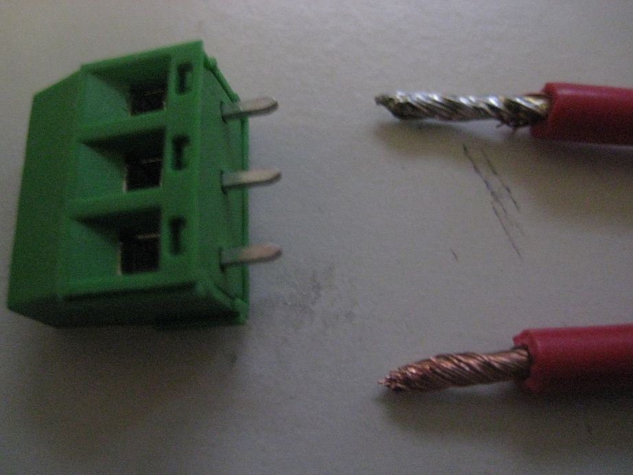

My last pic with the green terminalblock...what is better? Tinned leads, or just with the bare copper leads ???
What gives the lowest contact resistance? Also in long term?
Or should I not use them at all, and solder the leads directly on the PCB's?
But then my PSU is not so modular anymore😕
