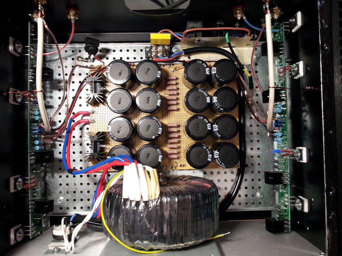

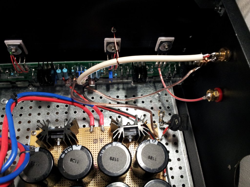

I ended today my F5 Turbo v2, the sound is fabulous, I gained more dynamic and bass QB, but ... the HUM not let me go.
I need help because I can not stop the hum, I begin to suspect that the apparatus is doing pre!
I'm using the pre-out of RA1520 Rotel integrated amplifier, takes little time and is still under warranty, you may be pre??
Already with F5 std had buzz, did all experiments and then some, and softened a bit, but there was always a little bit, but now we hear this a lot ...

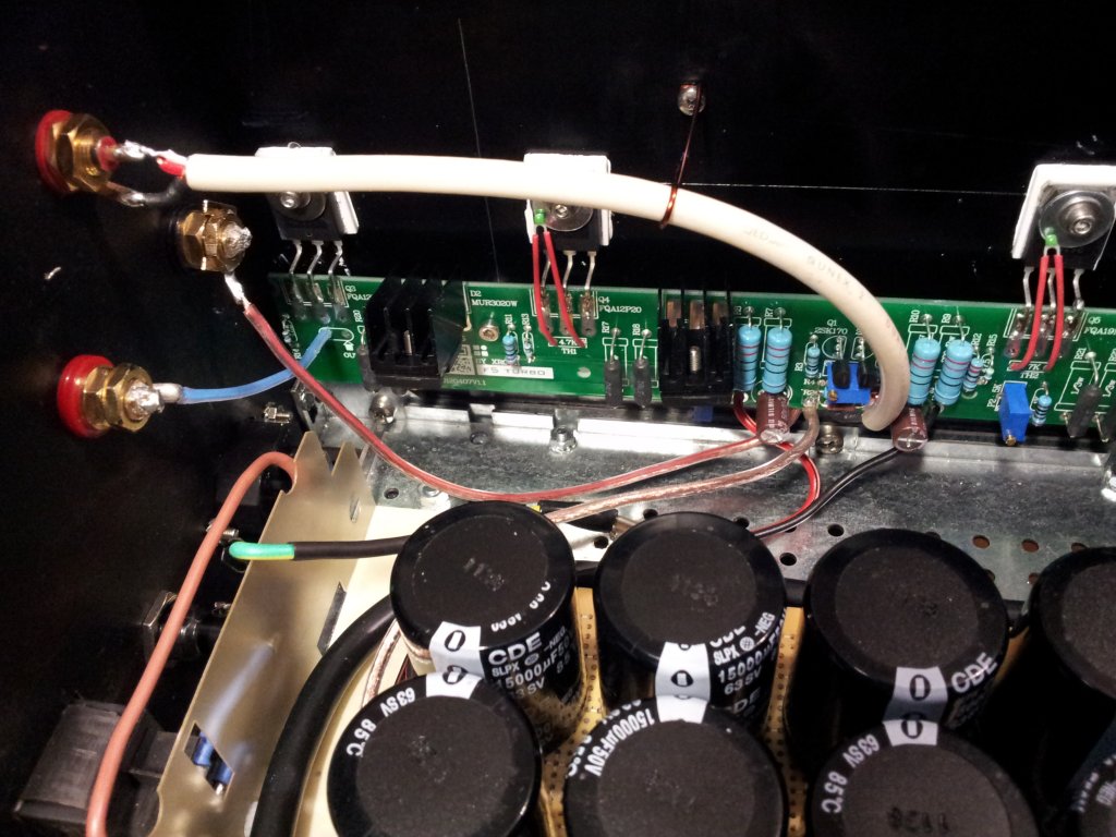

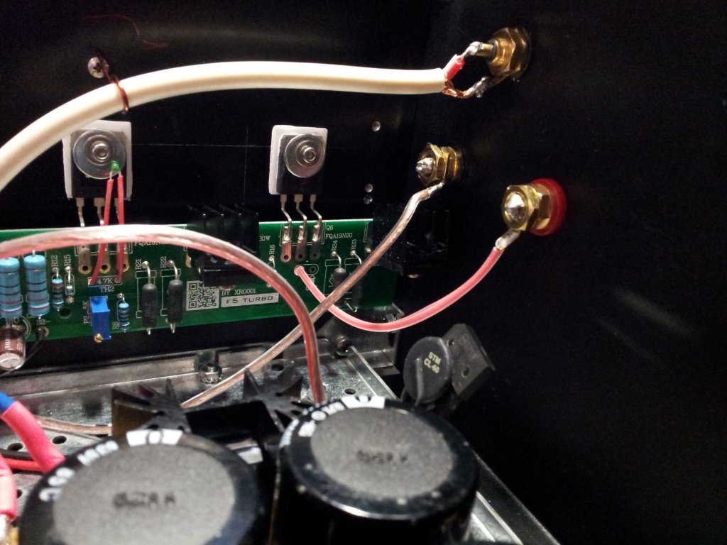

I'll tell you how I have the F5 V2 Turbo:
- The PCB source was made by me and the layout is just like the NP. No more and no less pieces.
- The IN is done with cable Qed with attached mesh will GND the pcb.
- The mass of the Speaker also connects to the pcb along with the GND.
- Then comes the pcb a wire that connects to GND PSU.
- PSU with 16 capacitors CDE 15,000 each, and resistance Fukushima
The same thing was done for the other channel.
The 800VA toroidal 2X24V is also moans a little nothing ...
There must be something to eliminate this buzz, I think to be making the connections that the NP used in F5 ...

is buzz there ( it is always around , but not that buzz ) even with nothing connected to inputs ?
I am surprised, cause I do not have any hum even though I have no grounding(it is in tweaking mode — on the floor with no chassis 🙂. Opposite to my Aleph.
here we go again .......
Without inputs connected, I hear very light (passes the test), I really have to touch the ear to the column.
Input connect only on the left side of the column is silent, but the other is with a slight buzz. Input connect only the right side the same thing happens.
When I connect the two inputs hear the buzz in the room, all this with zero potentiometer pre course.
Much has been said here of buzz, but I think every case is a new case, so thank you for your help.

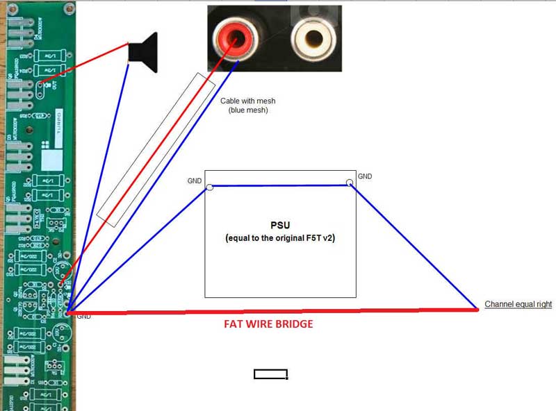

put fat and short(est you can manage) wire between two central grounds of two main pcbs
that will look as bridge between them
Can you draw a Schematic of the wiring inside the amplifier?
This scheme reads:
A cable Qed mesh connected between IN and pcb channel. The mesh connects to GND.
The GND Speaker Out connects to GND PCB Canal.
The GND of the PCB connects to PSU.

It can be a solid core?
yes
even if multistrand is easier for soldering
