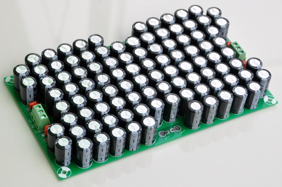

I have done like below, please note I implemented discrete rectifier board. You can replace it with standard bridge rectifier.
Power Supply Connections:
[picture are not in scale, just image representation for understanding.]
Mains to Rectifier:
Rectifier to Filter Board with Ground Isolator:
Earth ground must be connected nearest point in chassis where PS ground will connect through isolator explained below.
Ground Isolator to be built for each channel using Bridge Rectifier block and black NTC:
There are NO wires shorted on crossing also with mounting bolts. Please see actual construction - 1. Graphics 2. Actual Construction Top View, 3. Side view.
Please solder in pins properly, not shown in below picture.

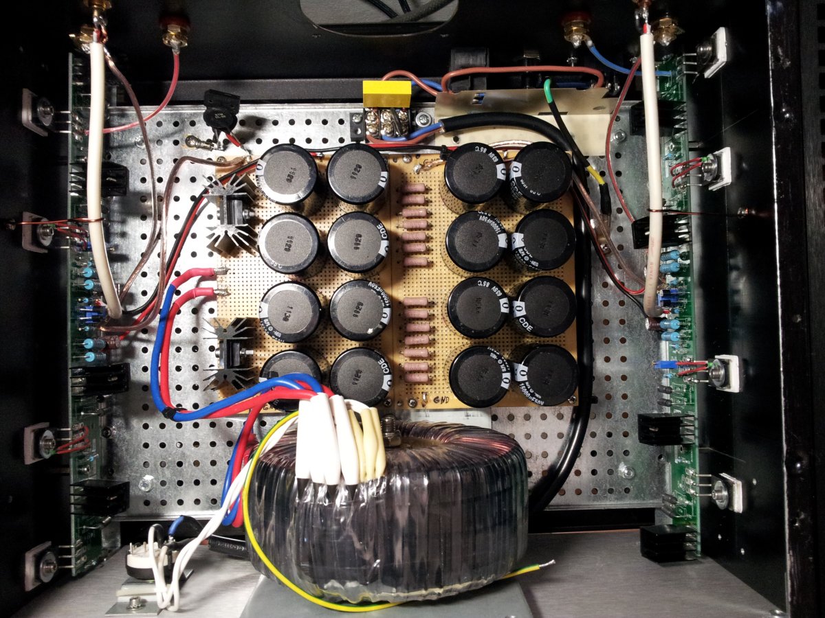

@Blink_PT: One more layout difference I found that your PCB is at same level of transformer. I tried to keep input sections and input cables away from mains and secondary wires of transformer.please see it here.
in your case situation is much simpler - you have two monoblocks , sharing one case and mains switch/fuse/cable
in case of boyz using common PSU for both channels - situation is trickier , often having different complications (or at least amount of it ) in different builds
whatever - trick with "decoupling" one gnd input signal route with resistor and/or joining central grounds of two channels via direct bridge - is most often working
those are old and ancient tricks , I can't even remember where I saw that for first time

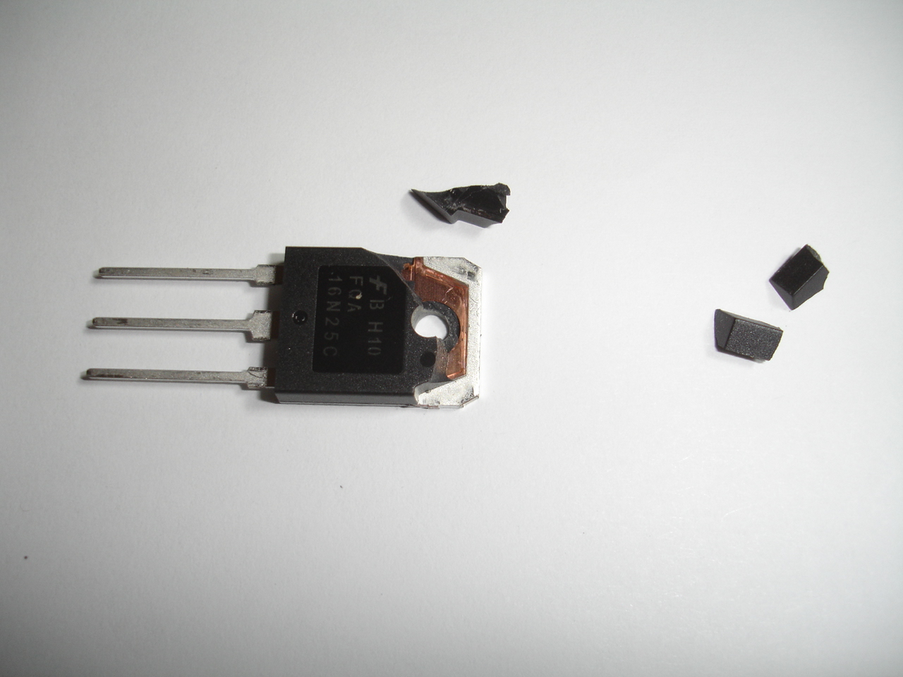

I also have grounding issue, small buzz. I tried Zen Mod's tricks. Now buzz is in left speaker only. Amplifier sounds better then expected . Zen Mod do you have any more tricks? Buzz as you said fet still works. I broke fet while drilling to enlarge hole for screw.
