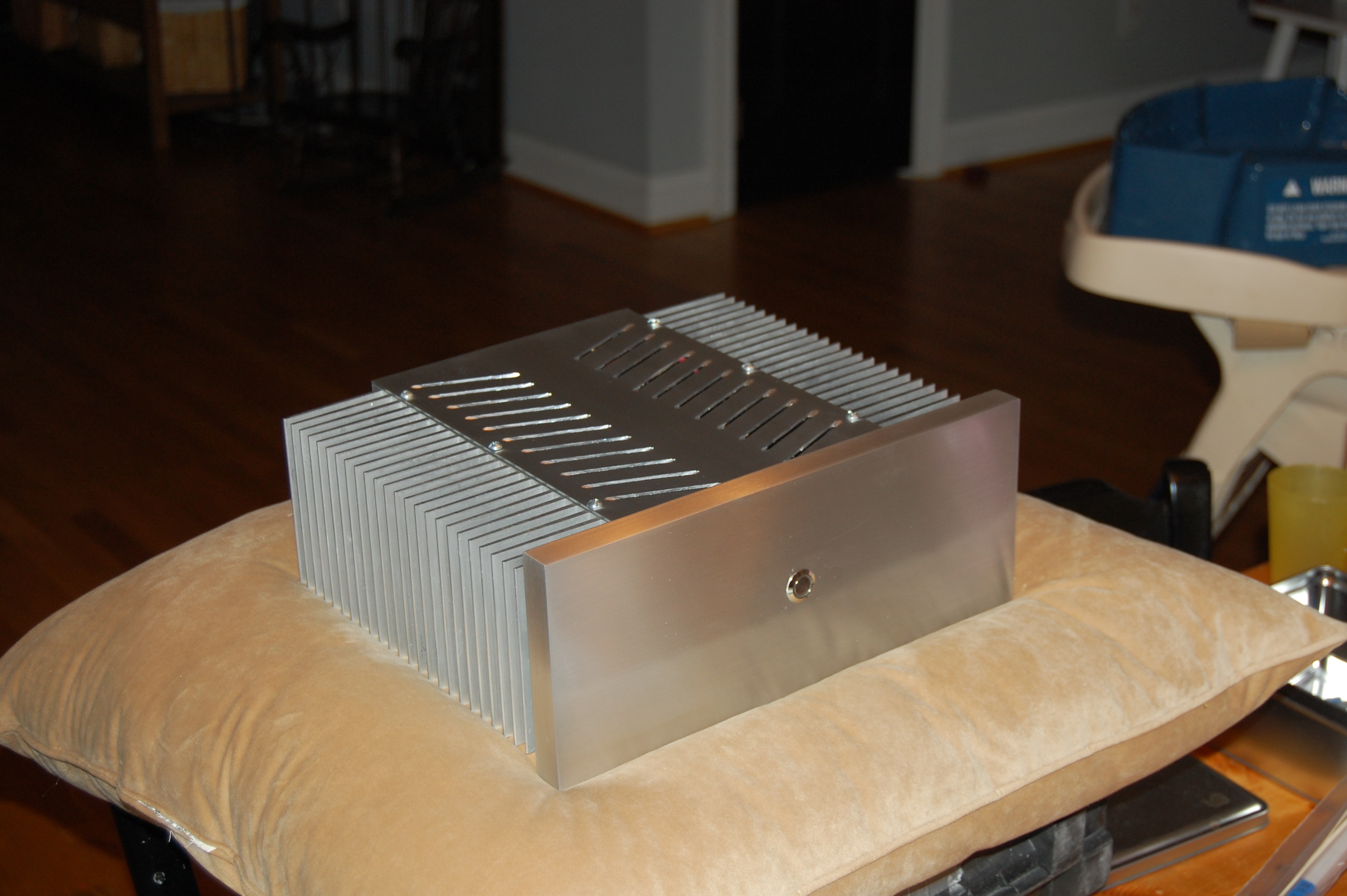

F5 Turbo Builders Thread
With the exception of cheapo button and screws(which were changed), table saw, chop saw, and sander.
Not proportional, but was going for small.
Buzz that case looks outstanding how did you cut the slots at angle?
when I cut my heatsinks on my table saw they were not perfect.
I've got more to cut. If you don't have an aluminum blade find one with the lest amount of rake on the blade teeth and lube the blade I use wd40 be careful wear eye protection.
I think I have I have aluminum sliver in my eye not from table saw but related work.
Always were glasses. Had a friend lose an eye using grinder on aluminum. Invest in proper aluminum blade. Makes a BIG difference. Without proper blade, you get drift. Make multiple passes to compensate for blade. Better the blade, the fewer passes. I still mak quite a few. Next set will have top and bottom in receeses cut for flush mounting. Slots were cut with small circular saw. Router wilwork as well, but is more dangerous without proper clamping jig. I almost lost finger to router. Be careful.

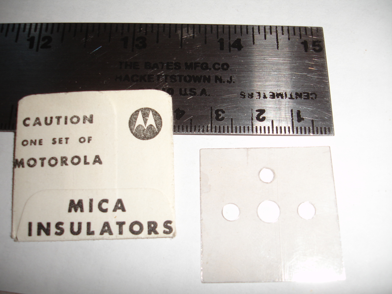

i will not recomend that. use insulators that is ment for your type of mosfets. those can send a spark to the heatsinks. and thats something you don't want🙂
take a look here after the 15th. : Assorted Components Kit, Modules items in Electronics-Salon store on eBay!
Audiosan
Do you mean there are too many holes on the insulator or mica is not a good insulator? I have bought a bunch of those expensive keratherm red pads for TO-267 (I think) BJT. I hope they will fit the mosfets used in the F5T.
