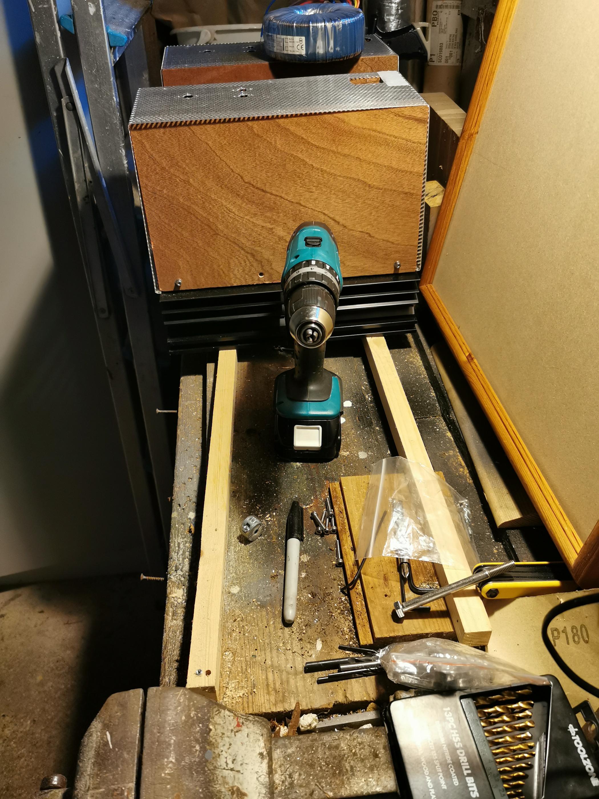

I bought a pair of F5 Turbo V2 boards and silicon about 6 years ago on a sleep deprived new father hood, uneducated whim. I slowly bought components and heat sinks and have designed what will be (one day) a pair of mono blocks. I've subsequently had some sleep, read what a wonderful chap Nelson is and built the B1 Korg with much success. Thank you very much to all for the wonderful documentation this site gives.
But I have made a mistaken purchase. The transformers are 500VA 230 primary to dual 25V secondary. Mains is measured at 240+V round our way so I think I should expect to see ~36V at the rails. The V2 aims for 32V rails and I'm worried that the extra 4V will be to much for the input JFETs.
What do you think. Risk it with heat sinks on the JFETs or cascade as suggested for V3.
If cascading, can anyone help me understand what value R25/R27 and R26/R28 voltage dividers should be to get the correct (32V?) at the JFETs please?
And is 32V the 'optimal' voltage for the JFETs, or should I target something else, and why?
No hurry, I haven't built up the PSU yet and the boxes are only just drilled and ready for paint and oil. Still very much in the shed and not ready for the kitchen table yet.

cascode them. Let the J-fets se about 16V.
Formula for calculating the cascode voltage is: railvoltage/(R25+R27)*R27.
so for 36Vdc rails you can use 10Kohm for R25/R26 and also 10Kohm for R27/R28.
that will be 36Vdc/(10+10)*10=18Vdc
