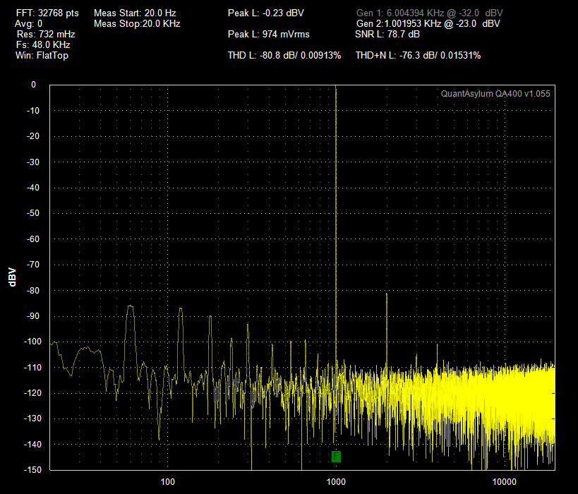

Just to check the analyzer, and for fun, here are the distortion/noise figures for the channel that just popped the fuse.

The distortion number is certainly good. You do have some power line related noise starting with the 60hz peak in the analyzer display and going up through the harmonics of 60hz. I believe you have 2 transformers in the chassis which makes it easy for this to happen. Not enough space to keep everything well separated.
