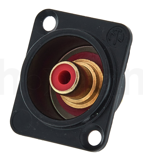

I'm going to hazard a guess that somethings up with the cheap RCA's in the box. I have some replacments that are much better isolated. Though these show fine on the ohmeter, it may be wrestling with locking rca jacks attached to them did something....I should swap them out to these better jacks. Never trust a jack with a shoulder washer that has a 1mm tall shoulder. The other jacks have threaded plastic to fit through the entire hole. MUCH better isolation.
Hello BigE,
I also had problems with RCA too close to the case. I tried shrink tube...
Centering the RCA carefully and so on.
The last few years I prefer NEUTRIK - RCAs. No problems, no loosening/spinning...
But there are also other good brands.

Well. this Neutrik RCA connector has the same nylon washers as most other RCA connectors. And the extra body is metall. So conclution is. If they can make it work, anyone can.
