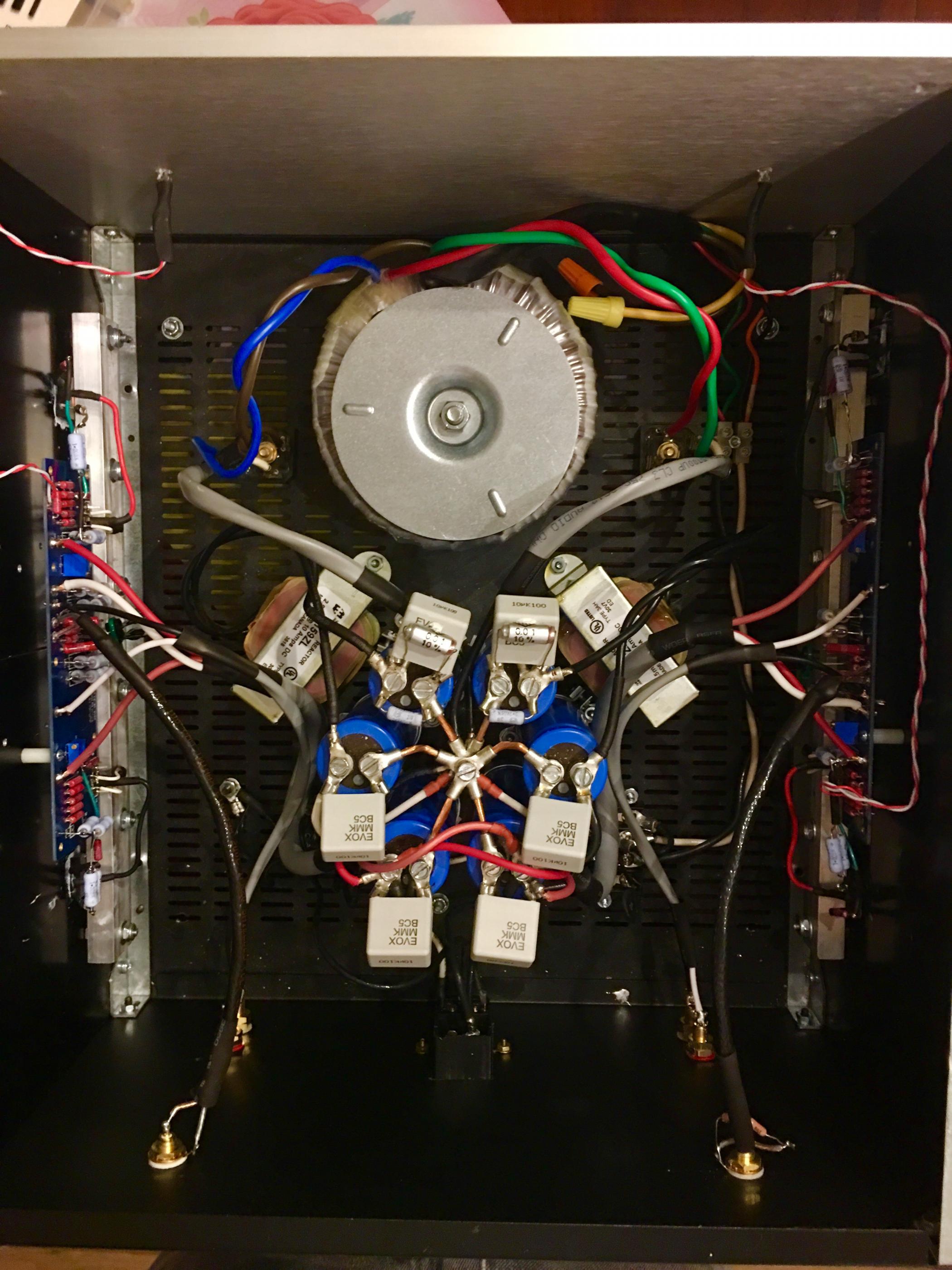

What is the wire size that people are using for their diyAudio F5T boards?
Is it really 20AWG?
If not, how are you connecting the wires to the boards? ( I my last iteration, I used harwin PCB mound solder cups, but that meant drilling out the boards....I'd rather not.)
14 AWG. I've used 18 as well, couldn't tell any difference.

Strip back a portion of the 14AWG wire. Cut of a resistor lead that fits nicely into your holes. Wrap 3/4 of the resistor lead around the outside of the 14AWG wire and solder. Cover that bit with heat-shrink tubing. Now the other end of the resistor wire goes into the hole.
What I do is to strip back the thicker wire and about 1/8” from the insulation I snip off some of the strands so that the end of the wire will fit in the hole. Then solder it and put enough solder on the top to have it flow up to the insulation, soldering the 14g portion of wire to the top of the board. This will make the wire a bit stiffer than typical. If your runs are short and you have multiple parallel output boards like in an F5V3 it may be overkill using larger wire. I can’t remember what gauge wire I used.
Neat idea ... but perhaps not the optimal solution for any wire that carries high current? 😕
I mean, you are reducing 14g wire to, say, 24g wire (the resistor lead). Whereas if you cut off some strands like Hikari1 suggested then you get down from 14g to, say, 18g - which is a lot thicker than 24g.
Andy
I would argue that parallel is better although it probably won’t make much difference. What might make a difference is everything having a more central “star” ground. I started out with THHN house wire, I’ve used that, Teflon silver coated and speaker cable. Doesn’t make much difference.
You could connect 14 awg stranded wire by putting a 1mm pin into the center of the bundle of strands as a guide, then ensure that there is a solder bridge between the tips of the strands and the board.
You need to ensure that the wire is soldered in from the back of the board as well to make the circuit. For those connections you get maximum contact via 1mm wire.
Stranded is a must here for strain relief. I used solid core house wiring in the first version, which is too stiff.
