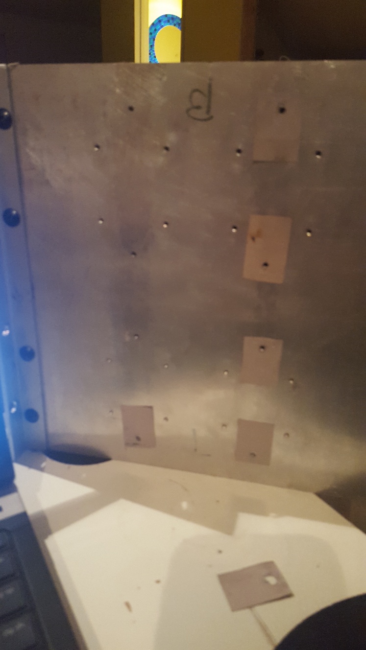

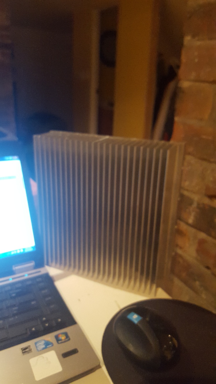

No. I'd use the 4 ohm resistor to set the bias to a level that my heatsinks can manage. Here is a pic of one.... I will be using 4. Each will have a DIYaudio output section on it -- that's a pair of positive on one sink and a pair of negative on the other.

That is the heatsinksUSA's 10.080" profiles 10"long?
As long as you get the heat spread over the sinks backplate, you should be fine. I use those sinks in 6" lenght. and they can handle 100W of heat dissipation each without problems.
Excellent! Thanks for the link.
Mount the outputs 1/3 up from the bottom. And distance between outputs should be around 10X the baseplate thicknes. on this sinks, that is 9mm. So 90mm between outputs. And no more then 10x baseplate thicknes (so 90mm) from edge to first output. And from edge to last output. add it all togheter and you get 270mm. Just about perfect. But i would limit the heat dissipation pr outputdevice to 30W to get some lifetime out of them.

Thank you for the mounting specs! I will have to redrill for sure. At most 48 holes -- 8 for one board, 2 for the mosfets and 2 for the diodes. So 12x4 boards.
I think I can manage that!

Just keep in mind the Maximum dissipation pr device. With your rail voltage and speakerload, i would use 4 output pairs.
You may then have to Mount the outputs 1/2 up from the bottum of the sinks. with one PC Board over the outputs and one PC Board below the outputs. with the diodes over and under. Then you get a raw of 4 outputs pr sink, in the midle. That works fine. No worries. The diodes don't need the cooling per say. They just need the temeperature te be even thruout the diodes.

Well that means less work.
However, all outputs are currently not quite at the center. They are currently drilled 1/3rd up from the bottom, 1/3 down from the top. That's about 70-75 mm between them at the center.
A P-channel board and an N-channel board on the same sink makes wiring simpler.

I don’t think it will make that much difference as far as location goes. Top or bottom 1/3 should both work. I don’t think there is any mechanism for heat convection within a solid. It may make some positive difference with the air convection at the fins with the bottom of the sink heating up first using the lower mounting position. However the heat within the sink itself will not spread faster up the sink than down.

Perfect I always start 1/3 from the bottom.

1/3 from bottum or 1/2 up. just juse New fresh drilled holes.
and watch the distance te the edge of the sinks. THATS the realyy important thing.
