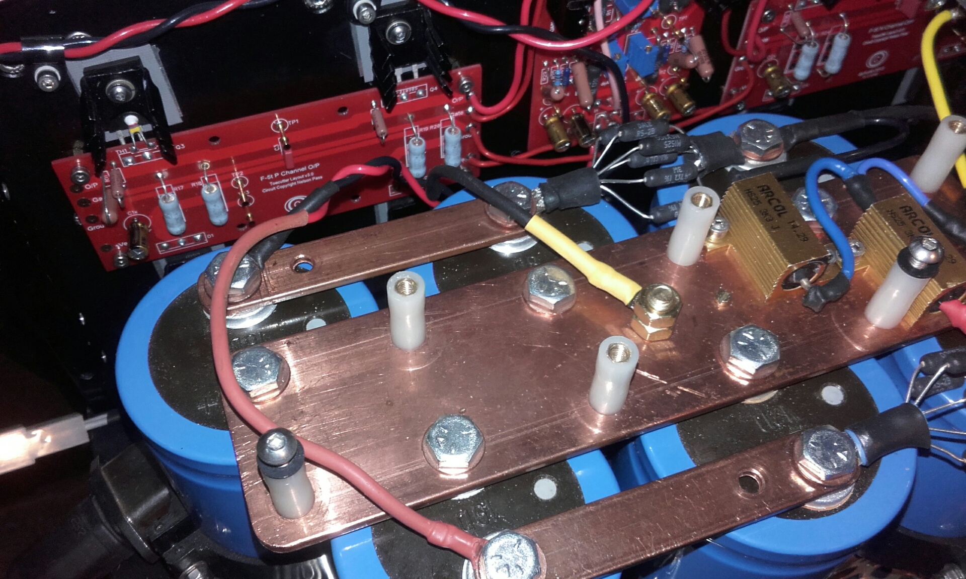

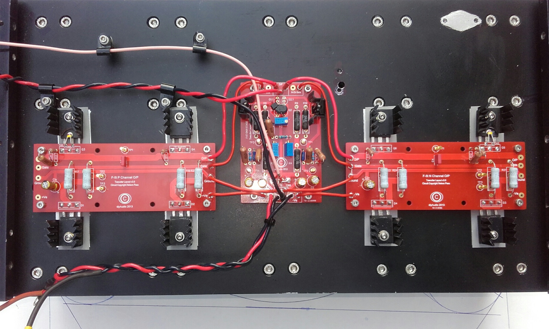

Before I proceed further I need to understand why there is rail voltage (34v) present at TP1/TP2. here are a couple of photos of the build, can anyone see a problem.
In this image from espirit, the power and control wiring is such that the two output boards are paralleled.
Is this approach better than running the two boards in series? ie where power comes from one end and control/output from the other?
Is the *shortest* wiring best?
