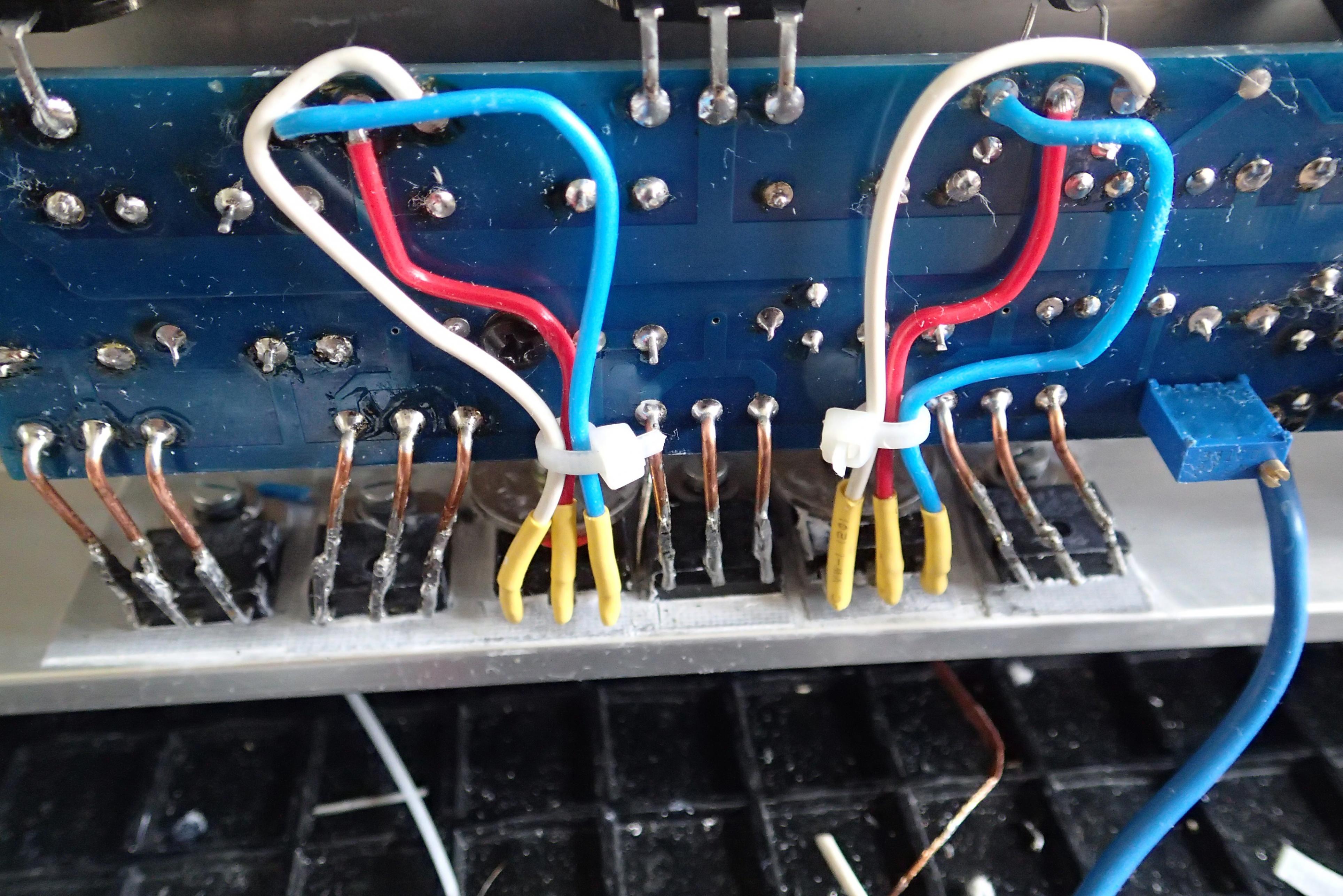

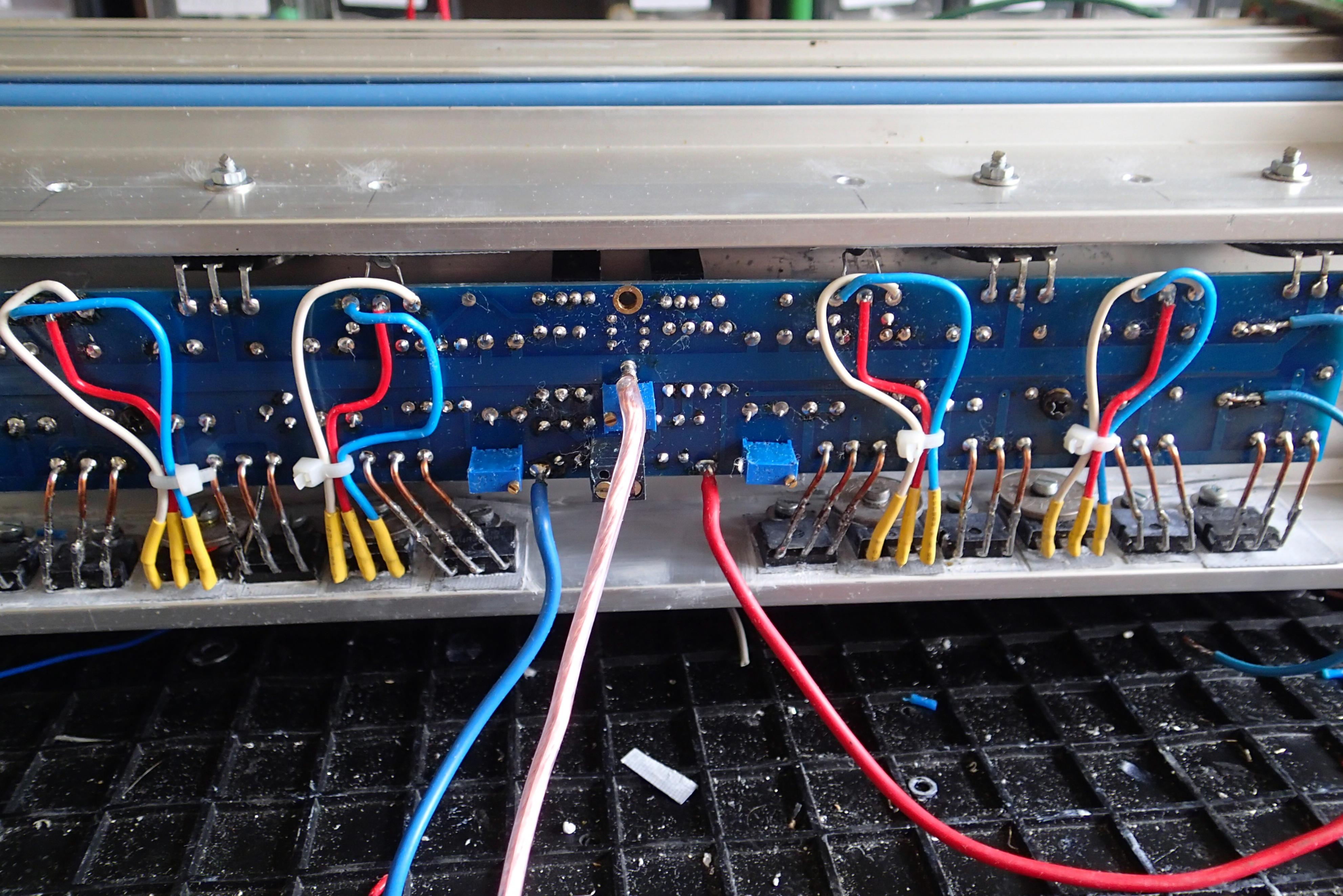

The damage after R3/4 burned show up to be quite worse. I took my time to test all power FETs. Six out of 8 power FETs was broken(no MUR diodes). Since I use a cooling tunnel and mounted the powe FETin an unusual manner, it was a hell of a job. I will wait til to morrrow to fire it up again. I dont want to hurry into new troubles. I do have learn to walk slowly and to double check.
Johnhenryharris: Interesting project modding F5 with different powersupplies.
The tunnel I use are separated into four "individual" heatsinks not connected to each other. This result in a much lesser spread of the heat. I started with all the power FETs on the upper heasink and the diodes on the lower. Now I have moved four of the FETs together with all the diodes. This have lowered the temperatur very much. My aim is to run with 310mV over sources or so much the tunnel can take keeping the temperatur around 50 C. I also use blowers on a very slow run.
