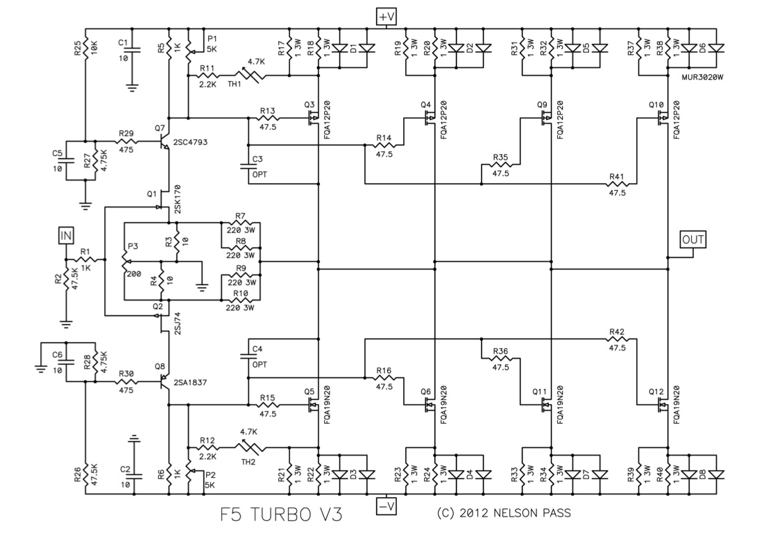

So 1/3 of 32 volts is 10.6v at the voltage divider to the base of the BJT. With the stock resistors 10k and 4.75k in series you have 32 volts across them which gives your 2 ma of current, 32/14.75k. If you want to keep the same voltage to the base and 2 ma current with 48v you need 19.2k for r26 and r25, 48v/(19.2k+4.75K)= 2MA. Sizing R5 and R6 is not as obvious, at least to me, from rail voltage to ground at the source resistors, either R3 or R4, you have 1k + 10ohms so you have 32v/1010ohm = 31 ma if the cascode bjt were bias wide open, which it isn't, but using that for calculations 48v/31ma=1548kohms or about 1.5k. Now this is just educated guess work, which is why I am asking. Another way to look at it is the 48 volt is 50% greater than 32 volts so the resistor R5 and R6 need to be 50% larger, hence 1k to 1.5k.
Analysis/comments please.
Thanks,

So, after all that headbashing trying to figure out what why the voltages at the Jfets were so low, it really is the 470K resistor (R29/30) that was mistakenly put in... now exchanged for a 470ohm resisistor and voila! :cheers:
Just connected the rest of the circuit, and biased at 0.3V with 1mV offset :yes:
Next issue..... now the transformer buzzes/hums 🙁.

Only thing is now is trying to figure out why the transformer buzzes so much. at 5-6A total draw it shouldn't be much for a 1.5kVA trafo. Does current imbalance do this ? I'll try swapping the diodes for slower ones tonight and see if it solves the issue.
BTW I didn't put the 1nF cap in... I hope thats not causing issues....

Ok. Jfets replaced and cascode parts added. The channel that was good still works great. The channel that I had to replace the Jfets is now acting wierd. The bias pots seem to only affect one side each. Plus the DC offset does not do anything and just reads 1.2mv.
So I can bring each side up to .3vdc but it's not right.
With music fed in it sounds very distorted and farty.

Print the f5T schemtic and write down the important voltages. Make sure that you have adjustability with both pots without the circuit turned on. It should be roughly zero to sub 1K
Give me measurements across the following:
r27
r28
r3
r4
r17

So I re-biased the good channel just to prove I remember how to do it. The other now can only get up to ~6mV before the pots run out or the DC offset is greater then a few mV. Does this mean I need to increase the resistance or that one resistor right? I need to read back on which one. R11 and R12?
The resistors in parallel with the bias pots need to be increased . More ohms. Start with double the stock value.
Are you sure you're turning the pots the right way? 6mv is not very much for full turns on the bias pot...
