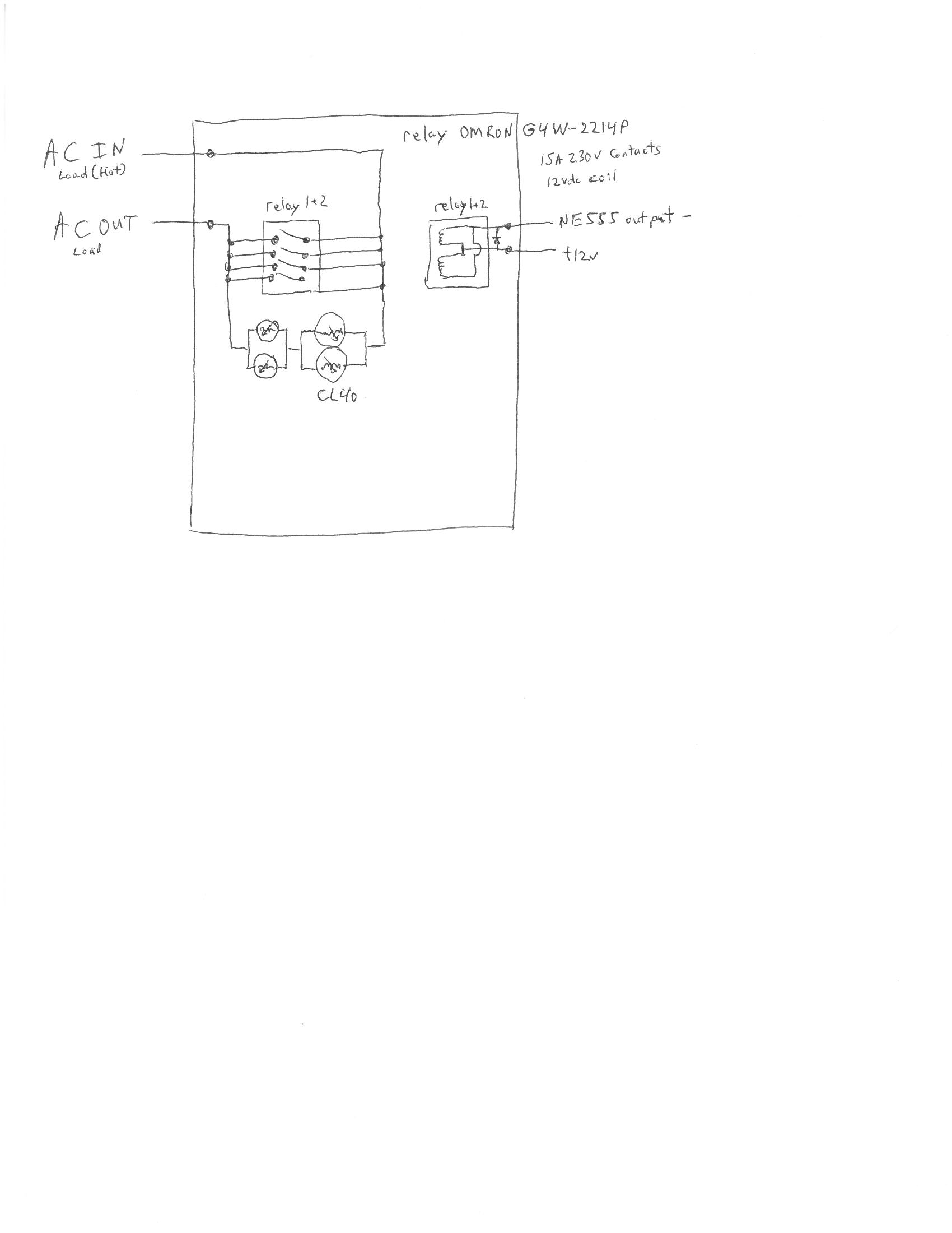

Hi Dazed2,
You shouldn't need anything but the softstart which is nothing more than a in-rush current limiting Thermistor. If you are blowing the fuse then your thermistor isn't the correct value. For the power supply I am currently working on the mains fuse is 10 amps so with 115v mains I can get away with 10 ohms for the thermistor. To make sure it does heat up too fast I use 4 thermistors, 2 in parallel, in series with another parallel pair. That keeps the initial resistance at 10 ohms and splits the load. Then I have a NE555 timer pull in a relay that bypasses the thermistors so there is no current limiting and the thermistor aren't working continuously. The relay is capable of 30 amps on the mains and the relay coil can be pulled in with 12 volts and a few milliamps of current the NE555 can sink.
Have a good one,
John

I tried what you were thinking too..... it doesn't work! I was trying to be lazy too.... I had 3 10ohm 10A thermistors in series in a soft start.... it blows a 10A fuse when it switches over, if it doesn't blow the thermistors first. I had the timer anywhere from 0.5 sec to 10secs.
With that much capacitance, you must have BOTH a soft start to start the transformer AND a slow charge to charge the cap bank. ESPECIALLY the amp you build is a class A amp. ie constant current draw at startup. Listen to AndrewT

Hi All,
Attached is the softstart circuit I use to start my big amps. The CL40s are 5 ohms and 6 amps. In parallel and series it is still 5 ohms and capable of more current. You could eliminate the 12v transformer and the NE555 circuit and just use a switch to pull in the relays after a slow count of 5 or 10 seconds. I found another softstart supplier on Ebay in Hong Kong or Shenzeng that has every thing on one small PCB, I purchase one but haven't tested it yet. The parts alone was worth the price.
John
