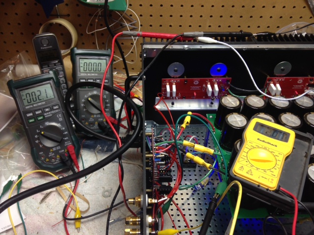

Folks:
I've reassembled my F5T V3 and the problems I've been experiencing have not been resolved. The attached photo shows the VDC readings: the green meter on the left is connected to the two P output boards and reads 2.1mv and the green meter on the right is connected to the two N output boards and reads 0.0mv. These two meters do not change when I adjust P1 and P2. This is the same result I was getting before I removed the two sets of output boards from the circuit (leaving just the power supply and gain stage board) yesterday.
The yellow meter is connected to the output and ground and reads 2.07 VDC. It also does not vary when P1 or P2 is adjusted.
Your thoughts?

Have you checked if those aluminium bars that are holding the mosfets are not touching a leg of one of them? They seem to be pretty close to the legs on the picture. Even the big washer holding a diode that looks blue on the picture seems to be very close to the legs.
petefrontiers:
You're right, the aluminum angle is close to the MOSFET and diode legs. But they do not touch, and since the aluminum angle is grounded to the chassis I trust the circuit or amp fuse would blow if they came into contact.
Scott

Ok, it looks like your voltage is drained to the ground from somewhere so I'm trying to remove each option. Do not rely only on the fuse, check for continuity between each legs of diodes and mosfets and even the thermistors to the heatsinks.

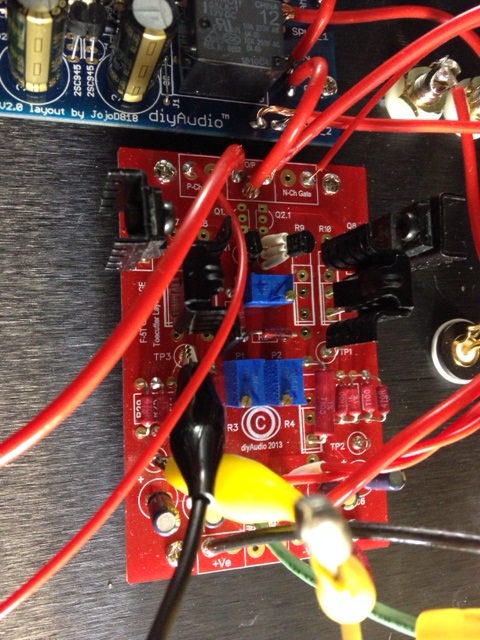

petefrontiers, SirByrd and Buzz:
You guys are clearly on the right track. I have replaced the homemade spreader bars from the MOSFETs and installed washers instead. I'm getting some inconsistent readings between the N and P sides of this amp. With one probe connected to the chassis ground, I'm getting the following readings:
With the PS attached to the N and P output boards and the gain stage board
All N output board MOSFET gate, drain and source legs show low resistance, which slowly increases
All N output board diode legs show low resistance, which slowly increases
All P output board MOSFET drain legs show low resistance, which slowly increases. The gate and source legs show as open circuit
All P output board diode legs show as open circuit
With the PS detached from the N and P output boards and the gain stage board
Open circuit for all N output board MOSFET gate, drain and source legs
Open circuit for all N output board diode legs
Open circuit for all P output board MOSFET gate, drain and source legs
Open circuit for all P output board diode legs
To be clear, I understand the leg orientation on the MOSFETs to be, reading left to right with the printed side of the device facing up and above the legs: G D S
The minimum resistance across R5 (using TP3 and TP4) is 823R. Rotating P1's screw increases resistance slightly (about 1R per complete rotation of the screw)
The minimum resistance across R6 (using TP1 and TP2) is 0R. Rotating P2's screw increases the resistance
Even I can see something's up. Your thoughts?
Scott

First things first. With multi-meter set to measure resistance, attach common probe to the heatsink and the remaining probe to the drain of each mosfet. Every fet should read as an open circuit or infinite resistance. If not, you do not have proper isolation. Start there.
BTW, it should not matter if you have the PSU attached ot not.
Folks:
With the power supply detached from the output boards and gain stage board, I get infinite resistance between the chassis and the drains on each of the MOSFETS.
However, when the negative and ground power supply leads and N gate and output connections are connected to the N output boards, I get readings (which slowly increase) between the chassis ground and the drains on each of the N MOSFETS. The same holds true for the P side.
I disconnected the output and gate connections between the N output boards and the gain stage board and the power supply connections to the N output boards and, not surprisingly, again got infinite resistance between the chassis and the drains on the N MOSFETS. However, if the negative and ground power supply leads were reconnected to the N out put boards (but the gate and output remain disconnected from the gain stage board), the resistance between the chassis and N MOSFET drains was about 12.8M.
The pinouts on the 2SC4793 and 2SA1837 seem consistent across all manufacturers. The same seems true of the 2sk170 and 2sj174. They are all properly oriented. My resistors are in the right places; I've got 5.6k at R27/R28 and 12k at R25/R26, but otherwise everything is in the right place with no obvious flying leads, bad solder joints and the like.
Recommendations?
Thanks,
Scott

Replace pot on R5 side. Test pot adjustability again after doing so.
