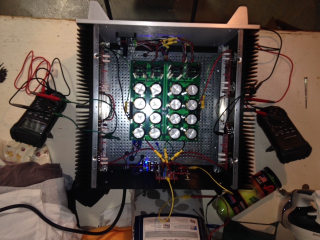

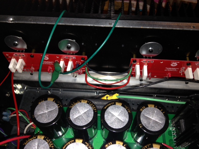

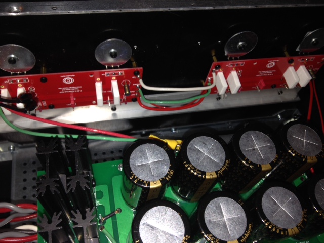

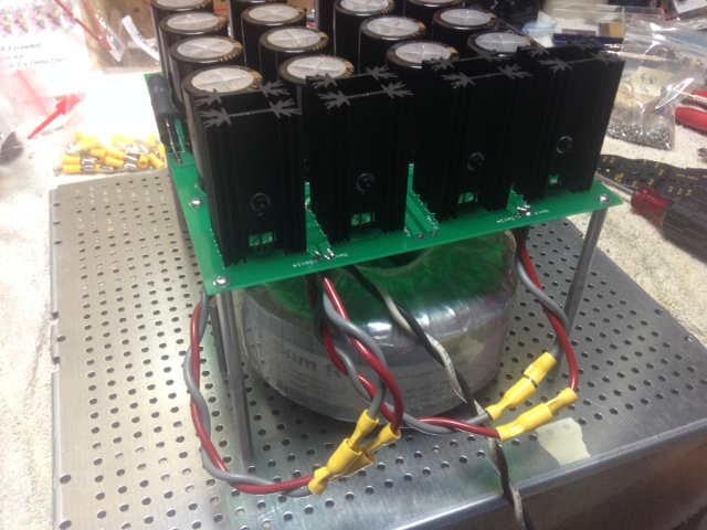

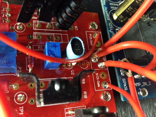

Folks:
This is great -- I'll start checking voltages and the MOSFETs in the morning. Yes, the measurements were taken without the dim bulb tester. Here are a few photos in the meantime.
Thanks for your help!
Scott
Scott

Folks:
The MOSFETs are properly installed on their respective Output Boards.
The power supply readings are +/-47.3 VDC.
PS Ground to both N Output Board TP2 and TP3 is 47.3 VDC.
PS Ground to both P Output Board TP2 and TP3 is 47.3 VDC.
I'm cascoding.
PS Ground to the drain pin on Q1 is 0.066 VDC.
PS Ground to the drain pin on Q2 is 0.064 VDC.
The VDC across R3 is 0.066.
The VDC across R4 is 0.064.
Recommendations?
Scott

What's happening at TP1 & TP3?
These are the two test points just above R3 & R4 on the Front End board

It appears to cascade related. Measure from the middle of your cascade voltage divider to ground on both rails. This divider sets the voltage at the drains of the jets. The jets are on and properly biased, but have insufficient voltage at their drains if your numbers are correct about the readings from drain to ground. I am sorry, as I do not have the store boards to reference.
