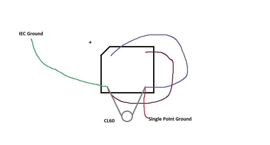

Folks:
I'm building my first F5T amp and would like to confirm the grounding scheme before doing something particularly dumb. Can someone confirm that this diagram is correct?
Many thanks,
Scott

roger57:
Thank you. Rod Elliot's pages often provide very helpful information (and a little attitude) for this newbie, but not in this instance. I'm using power supply pcbs for my F5T project and have wired the power supply correctly, as confirmed by my dim bulb tester. My question wasn't about the power supply, per se, but about grounding in accordance with Nelson Pass' F5T article. It appears to me that Nelson's grounding scheme can be built very simply (and almost entirely) on the bridge rectifier that is part of the ground. I simply want to verify that what I've drawn matches Nelson's design.
Scott
roger57:
Scott
Your drawing is okay. It reproduce the grounding scheme of the PSU diagram.

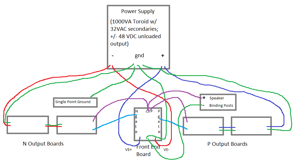

Folks:
I've hit a snag in the first channel of my F5T V3 build. I'm using diyaudio's F5T boards (version 2). My wiring diagram is attached. I'm reading about +/-48 VDC off the power supply, output boards and gain stage board. VDC readings across TP2 and TP3 on both the P and N sides are 0.00, regardless of my adjusting P1 or P2. I'm also getting 0.00 (or 0.01) at the output.
Can someone point this knucklehead in a useful direction?
Thank you,
Scott
