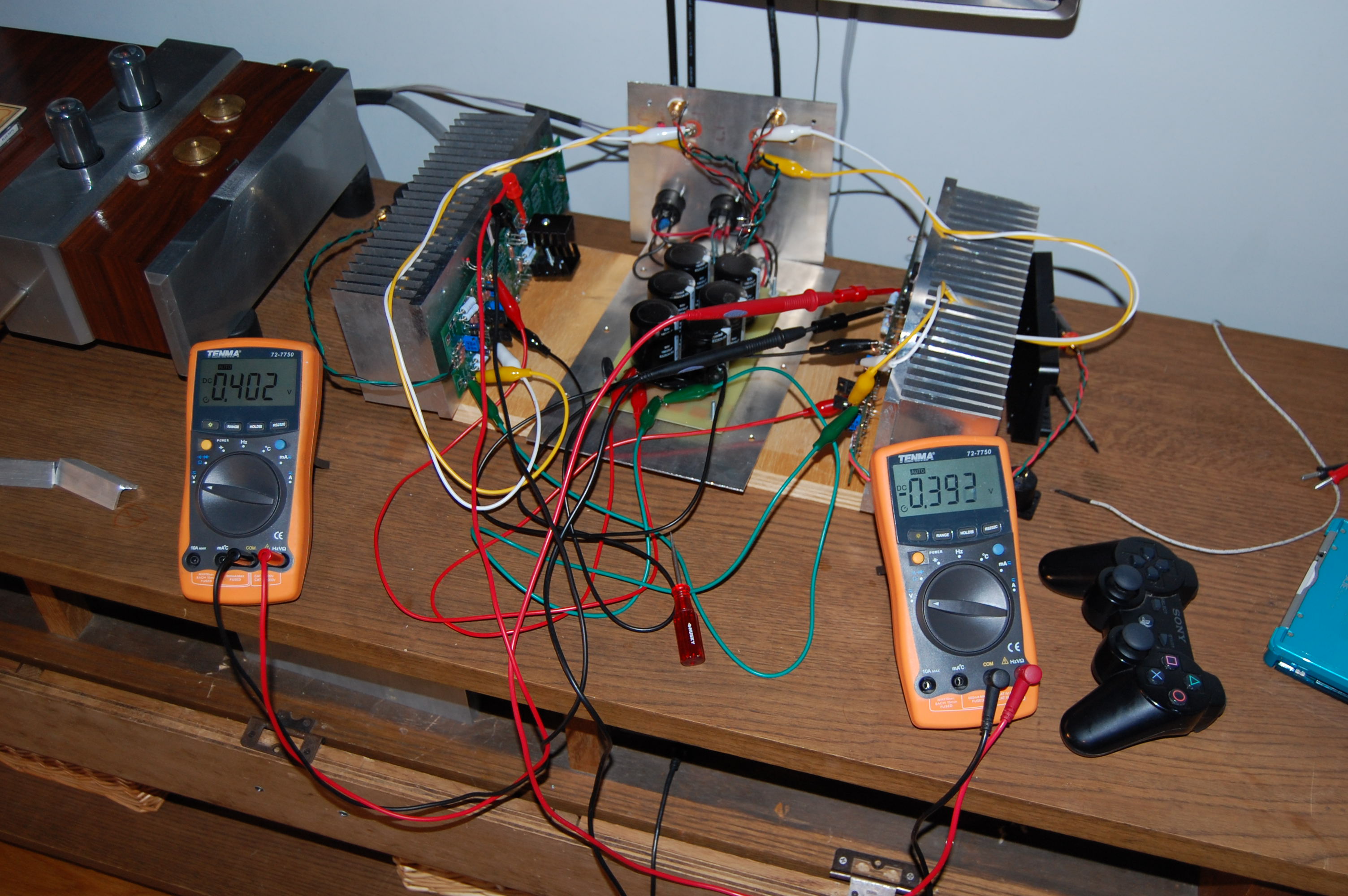

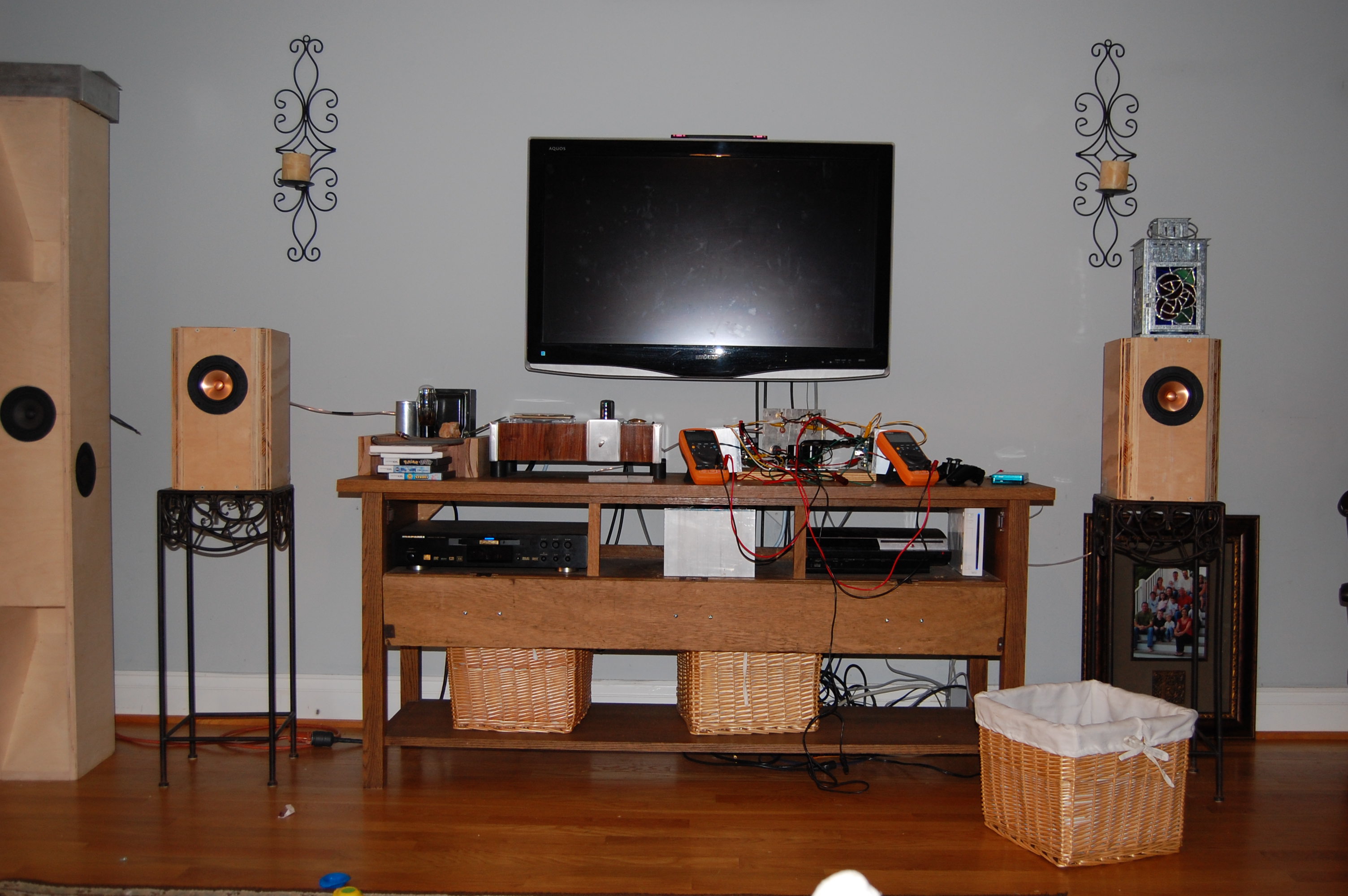

I agree. As for other diodes, unless you want to use them more actively in playback, I dont know what is accomplished in trying others, but then again, I dont know squat. I like the idea of a 2 pair V3 biased at 1.5 to 2A across .22 Rs with really well matched ppairs. I really wish i had a couple thousand pieces to sort through.:devilr:
Excuse the mess in my ever changing test room.
