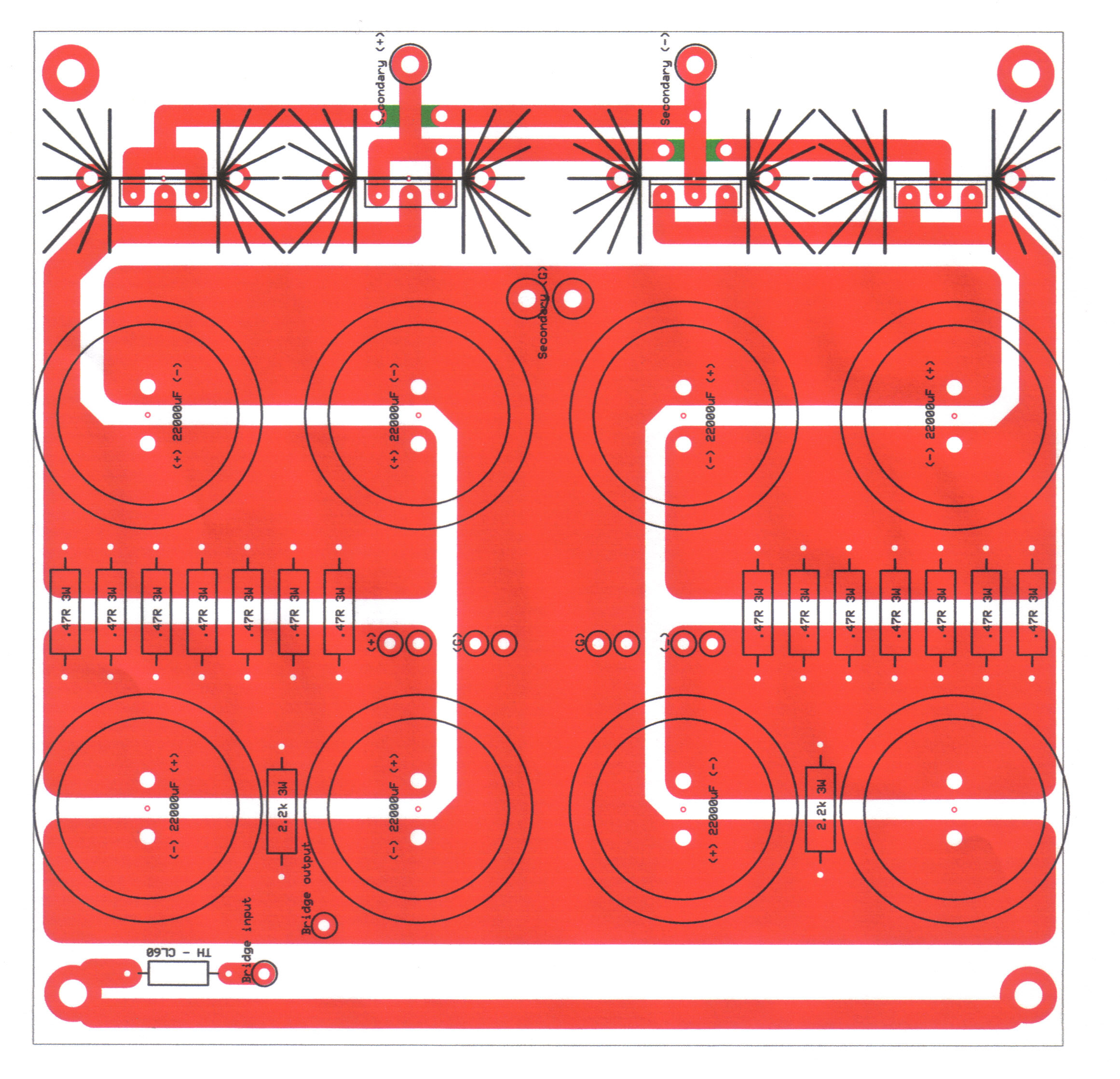

Thanks guys. Clearly a newb. Why is it better to have (+) and (-) in central area of pad over edges as shown. Also, why is it better to have a ll grounds at central point as long as they are on same pad? Last;y, if going double sided, do you want ground plane directly under positive and negative planes

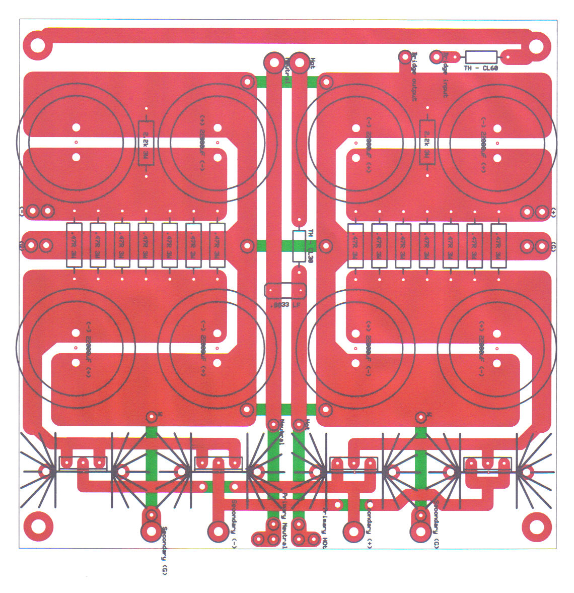

Will someone double check my PSU. I am calling it Lerch
Almost good
Stick the diodes on the vertical side instedad of botom
Line up the caps and it is done bigh thick and shoorth cooper traks is what is needed here(exactley as you did)
I am using different diode bridges so did not bother with finishing that part off.
I will be Happy to do it but you doing prety good job so no problem there...
Diodes on left side output on right red outline for 5 resistors and final smmoting film cap.
There is plenty of clearence for larger size caps
If you are tring for single sided which is IMO better there is no going around one of the track on the diodes crossing over the other.
I spent few hours triing to figure out a way which alwaise turn up to be a Jumper wire.
If you go duble sided I would Mirror the tracks on the botom layer (apart for where jumper wire is ini't) current carring capacity is the point here no screaning
If you want screaning from nasties DC filter and chokes is way to go
