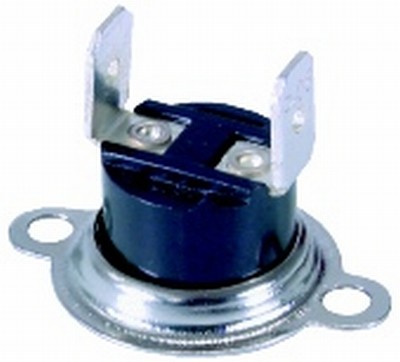

Papa is pullin' ya leg (with stat)
that's thermoswitch
normally On
