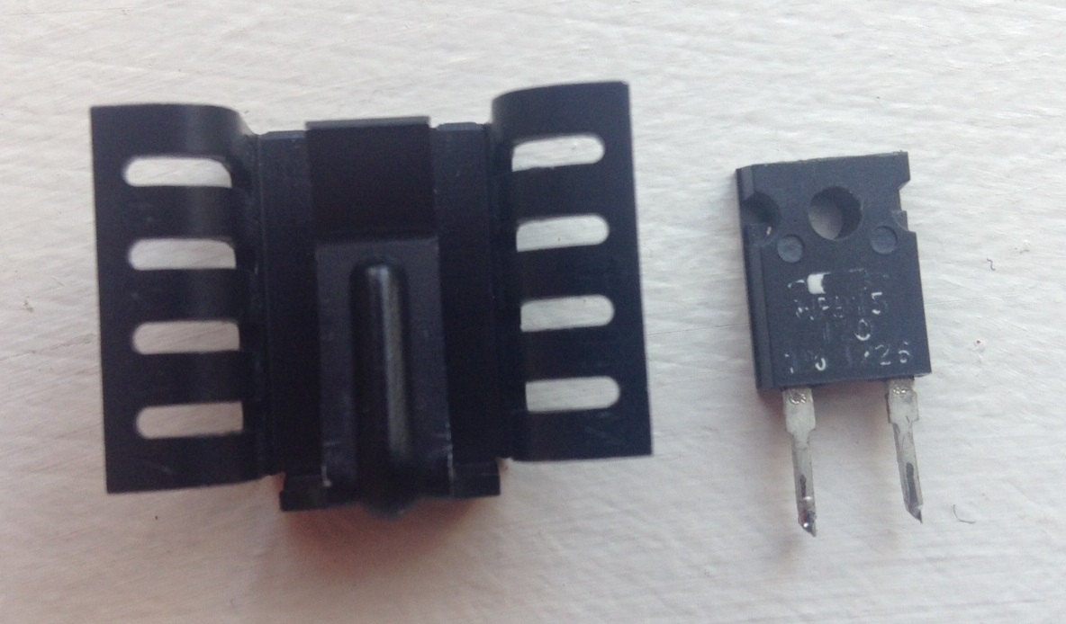

So if the OP here is running 45V rails then the Voltage over those feedback resistors would be 22.5V which through Ohms law should only have a max power of 4.22 watts with the 120ohm resistors.
So unless the heatsink wasn't touching the resistor at all, I'm sure that those MP915 should handle 4-5 watts with no problem.
Perhaps something else happened to cause those resistors to fail?

Post #53 says 1.5W with no heatsink.
yes but I think he was using a heatsink albiet a small one. So unless it was not touching at all I'm pretty sure 4 - 5 watts should be no problem.
Also 4-5 W rating is if he were to drive the amp right up to full rail voltage all the time!
1.5W rating for a non-heatsinked resistor would mean that he would need to output OVER 27V to his speakers for a extended period of time to blow those resistors! Thats like having a concert level listening session !!!!
Perhaps when he shorted ground it also affect the other amp? That and shorting the speaker terminals or using very inefficient speakers would be the only way I can see it possible to put enough voltage through the feedback loop to burn up those resistors.

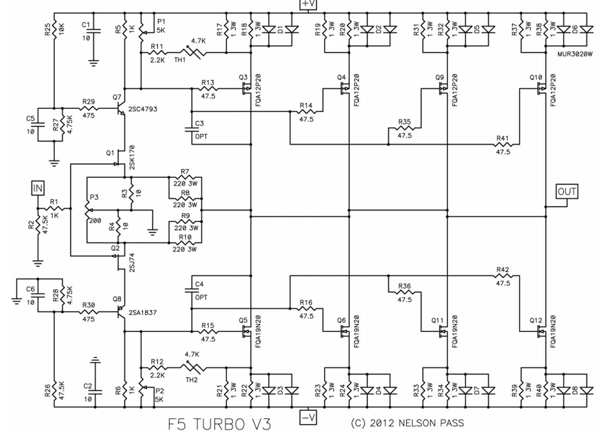

tell me on which exact schmtc to look , and I'll explain how's there half amplitude on feedback resistors , using proper designation numbers
Same schema from article.
I was thinking the same. The heat sink as it was attached should have had some effect. The destruction of the output stage in combination with testing practices and lack of proper heat sinking could all have contributed to the degradation of the resistors. Failure did not come from one issue/mistake/problem.
Can a resistor meant to be used with a heat sink suffer the same hot spots that a transistor can suffer if the case is not properly affixed to a heat sink? I think it might.
OK , V3 from article - attached
say , for simplicity sake , that we have +/-50V supply
then say that , for simplicity sake not counting on losses through mosfets and MURs , we have output amplitude of +/-50Vpp , which is exactly 100Vpp
then - we are looking at one feedback net half - say upper one , comprised of ((R7//R8)+R3)=120R
so , ref. to GND (where R3 is having anchored one leg) voltage at output node (other side of feedback net) is either +50Vpp or -50Vpp , which is nothing else than half output amplitude
so , current trough feedback net is 50Vpp/120R =416mA
lets put pause there ....... if you want dissipation on resistor expressed in normal way , we need to convert Upp to Urms , simply dividing Upp with 2 and again with sq. root of 2 , so 50/2/1.41 = 17V68
OK - current through feedback net is effectively (meaning - same as that DC voltage s there ) 17V68/120R=147mA
dissipation (P=I^2 x R) at R3 is 217mW
dissipation at R7 is 1.19W (half of 147mA !)
dissipation at R8 is 1.19W (half of 147mA !)
same applies on lower feedback net ((R9//R10)+R4)
to repeat - House : Everybody lies ...... either heatsink lied , or thermal goo lied or lied one who said it was heatsink there
so - don't bother what went wrong , just be sure that you have now properly heatsinked resistors ........

Looks like a 25deg C/W rated heatsink based on the data on this Mouser catalog page. This rating would of course assume that thermal paste was present. It would seem to me that this should be a sufficiently sized heatsink for the job.

Thanks ZM for clarifying the math. Makes sense.
Also good to note adding thermal grease to those little heatsinks.
