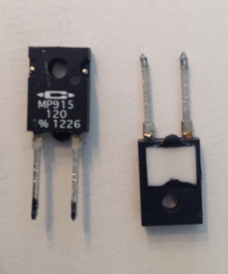

Folks:
Here's something odd. In the process of repairing my downed F5T monoblock, I took a closer look at the other (properly working) amp. Instead of using 3 watt 220R resistors at R7, R8, R9 and R10 on the front end board, I was using two MP915 120 ohm power resistors, rated at 15 watts, which were supplied in Buzzforb's first F5T group buy. I had small clip-on heatsinks on both. Neither resistor reads 120ohms; one is 230R and the other is 247R. Both have a dimple between the legs (insert joke here); see the photo.
Has anyone seen this before? I will order replacement MP915 resistors from mouser, unless anyone can suggest a better component or source. Naturally, I'd like to avoid going through this in the future.

Hi Scott,
I was wondering if it were possible the resistors were de-rated, for lack of a better term, if the heatsink wasnt properly touching the resistor body? For example, with heatsink its rated at 15w, but without the heat sink they are only good to 2-3w.

Just checked the data sheet for the MP915 120 ohm power resistors. Only rated to 1.5w without heat sink.
But still. Is it possible?
I don't think I saw goop.

yep that explains that. the higher value in feedback resistance will give you a higher gain. Therefore it will make that amp sound louder than the one you rebuilt.
Not sure how that happened that it melted the resistors though. There is some math someone posted here about how much current runs through those feedback resistors, Perhaps someone remembers it ?
Anyways in my build I deliberately put 200R resistors in the feedback loop instead of the spec'd 110R in order to give 6dB more gain. I've had no problems with the resistor melting. Its been running continously for 8 months now with 50V rails
P=IV=I²R=V²/R
well yes of course its based off Ohms law.....
Just can't remember how to arrive at the V in normal operation in that loop (R7 through R10)
