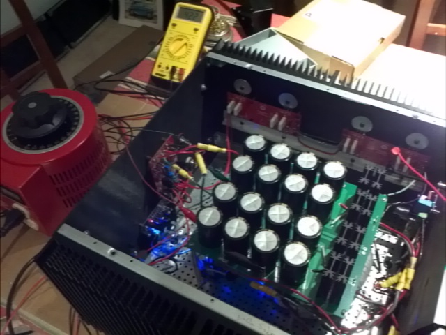

Hey guys. I just picked up a 10 amp Variac for this repair and future projects. Any tips on bringing up an amp on a variac?
What to look for?
What increment levels/steps/time to bring up the amp?
Should I be looking at heat changes as well as voltage and current?
Was going to attach as many meters as possible to monitor the startup.
Luckily, this is a mono-block. Makes things a bit easier.
Thanks,
Vince

At the moment, I'm 3/4 of the way to rebuilding the amp.
All the p - ch mosfets and diodes check out ok. still need to check n-ch side. All the source resistors and caps check out ok. Rebuild the front end on to new board and all components are ok. Checked jfets and bjt. all ok. The power supply is ok.
I'm guessing either output protection or softstart start is faulty. Still need to check all components on n-ch side.
Do that tomorrow.
Vince

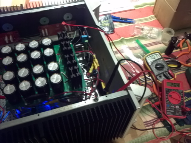

The amp is working. No hum. 🙂
Taking measurement of the bias from both sides. The n-ch side is off .035mV from the p-ch bank. The higher of the two readings is .301mV right now. The heat sinks are warm. Put the lid on it and letting it run for now. Its playing music just fine.
Anything I can do about the off set of the two channel banks? P3?
Vince

I don't understand your question...
Bias until your heatsinks are quite warm after 30min. The difference in the N and P channel is to be ignored. They will still be in the same ballpark.
DC offset is measured at the speaker terminals.
Doesn't mater. Any source resistor is fine.
If DC offset is zero or close (and 10mV is fine) the Bias through the rest of the devices will be close.
Once set, then check drop across all the device's resistors just to make sure you don't have any mosfets hogging current.
If your shooting for a certain bias mv number then just average the P & N mv's to get the number you desire.
That's interesting. So in the event that both banks are not equally biased, one can take an average. This is the first amp I worked on with parallel output FETs, so this is new to me.
The reason I was concerned in the first place is because of the diodes in the output stage need to be in a certain temp range so the current doesn't runaway. The article says .400v is where this may happen. This is why I stopped at .300v for the higher bias reading of the two banks.
BTW- the mosfets Vgs measured tolerance was .03v max. For example, one mosfet would be 3.86v and another 3.89v. Some were exactly the same Vgs.
