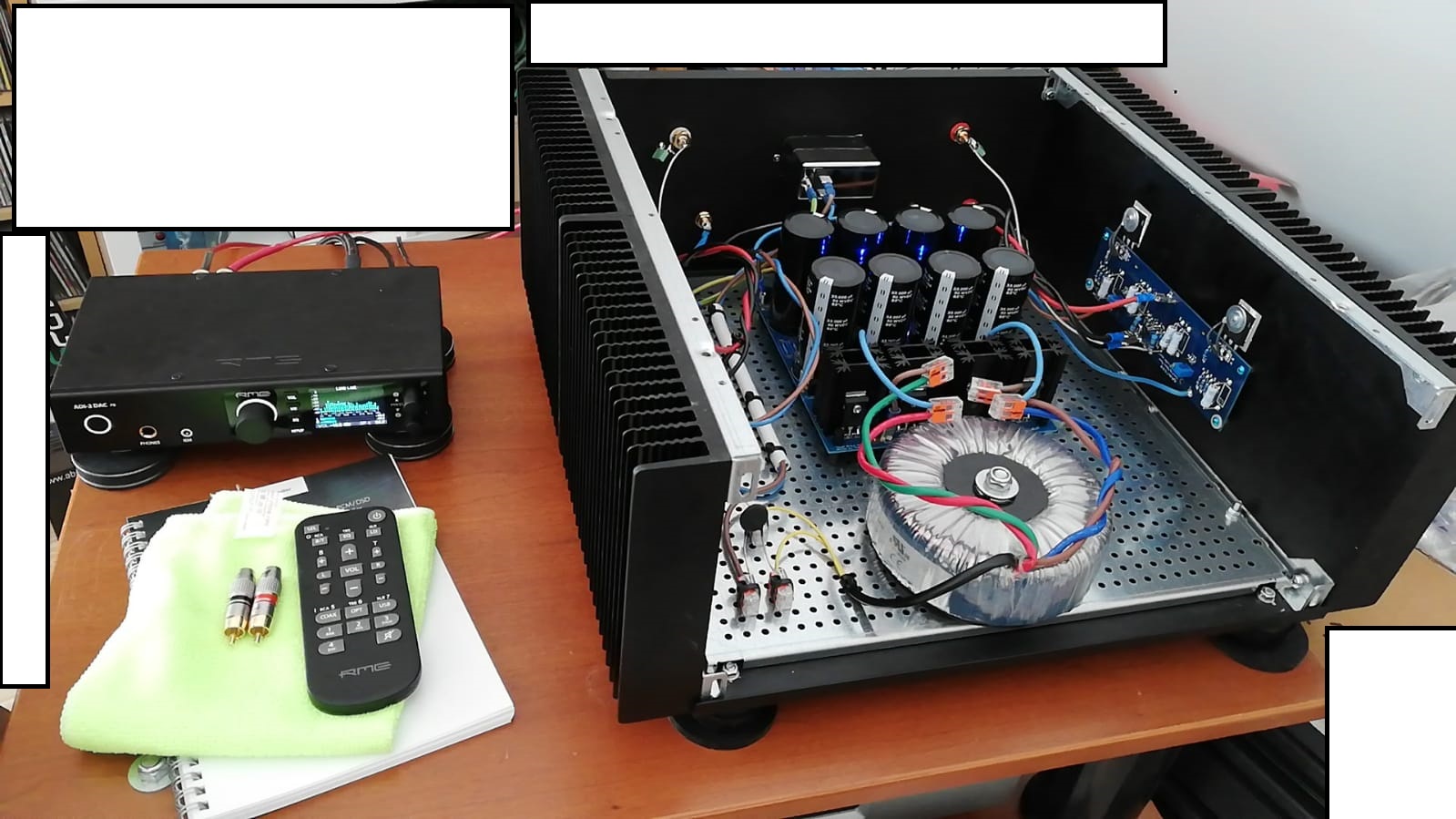

Hello everyone,
for about 2 months the F5 clone has been driving my Audiovectors, the sound is really good, clean without a hum.
I want to improve the parameters of my amplifier. Currently, I have a quiescent current of about 1.75A and a THD distortion of 0.017%, dynamics 90.3dB, noise 97.2dB.
I would like to improve the THD and noise level in my F5. I know this amp can have a THD of 0.002-0.005% and some examples 0.001.
I plan to increase the quiescent current to 2A, but I have to improve the cooling (1.75A and heat sink temperature 57 degrees C), maybe some fans.
Here's a question for you, what do I have to do to get THD below 0.005%.

Monoblocks would be a real improvement. Otherwise match all the parts, and use low inductance source resistors.
Also use five series 10R feedback resistors (the exact same part as the 10R to ground), to cancel distortion
due to thermal modulation. That means a new board layout.

I looked at the diagram and it is a question of replacing two 100R resistors connected in parallel with five 10R connected in series. Will 5W resistors be appropriate or would I have to use 10W?
Why does such a series connection of resistors have a better effect on THD?
I have one more question, maybe a lot of these questions at once, but with one tampering with the amplifier I would like to correct the weak points of my F5.
How can I improve the dynamic range of my amplifier?
Calculate the power dissipation in the feedback resistor at full power (roughly 5W), and derate each of the series 10R accordingly. For example, each of the series 10R would dissipate roughly 1W, so derate by a factor of three to ten, depending on the parts and board space available. Use the same part for the 10R to ground. But use the very best
quality resistors for the feedback network, since it determines the performance of even an otherwise perfect amplifier.
This works because all six of the feedback resistors have the same signal on them, and present the same error
(mostly thermal modulation distortion), but this is cancelled out when scaling the output voltage down to
that across only one of the six resistors. All behave the same (if in the same thermal environment), so to a
first order approximation, the error drops out of the equation.
Dynamic range would have to extended either downward by lowering noise, or upward (in current)
by adding additional parallel output devices. Some remove the current limiting circuit, but with added risk.
Also look into adding snubbers to the secondary transformer windings.
