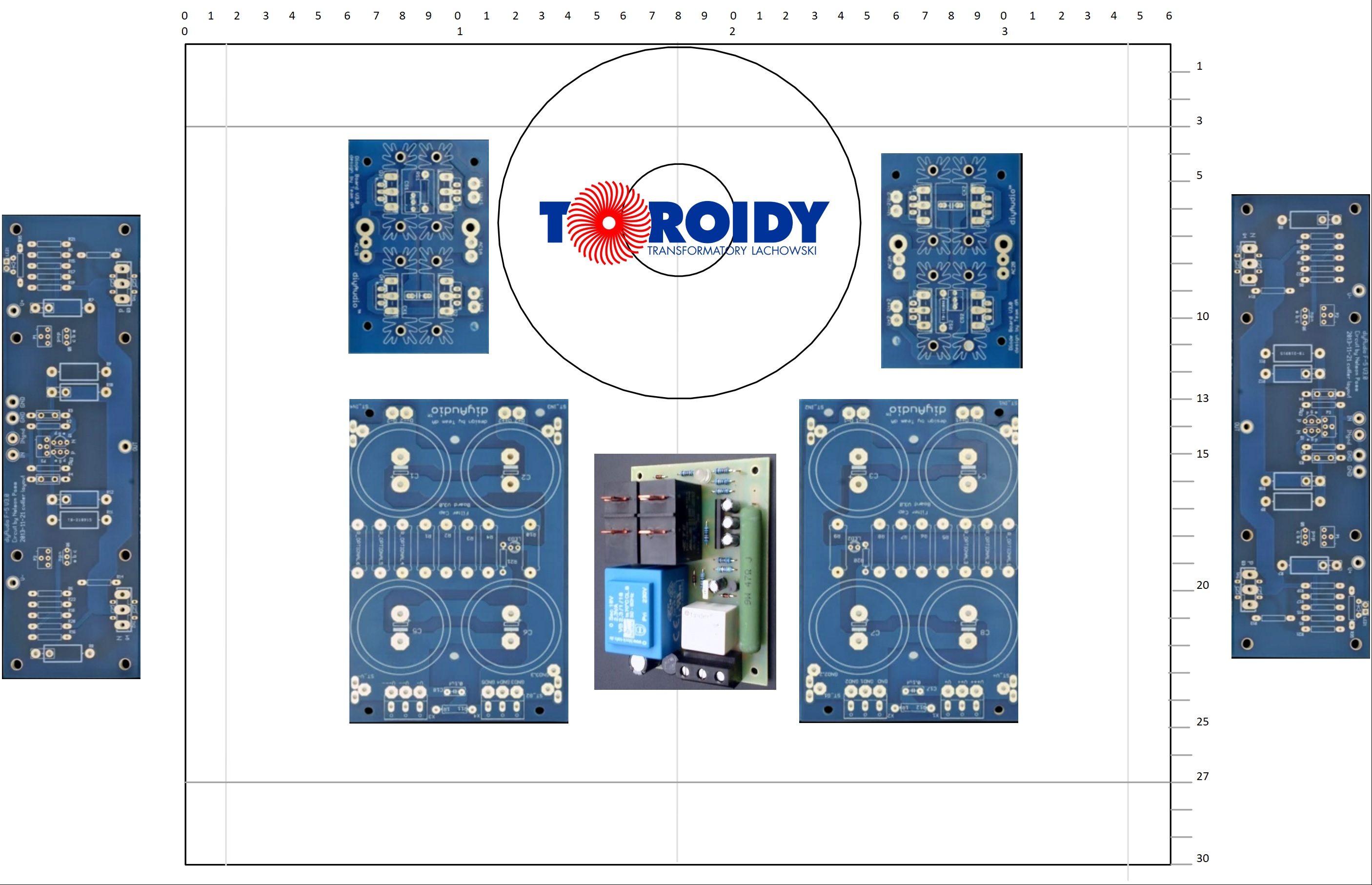

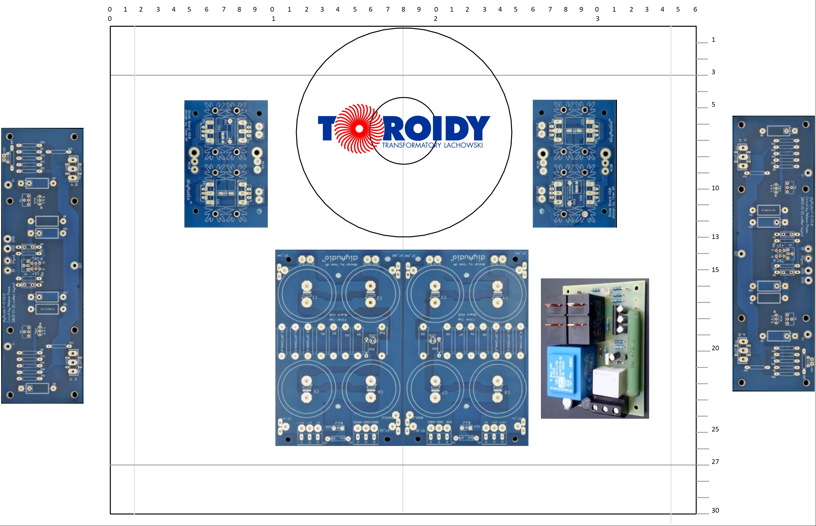

Hello Gentlemen,
I plan to build an F5 on basis of 4U Deluxe Alu Chassis and V3 boards from DIYaudiostore.
First of all I wanted to read the whole thread, but it seems a losing game with over 1600 pages. So I need your help and advice.
My intention has some modifications of the standard project.
I want to use a soft-start and speaker DC protect board. Why this? I don't like hot running thermistors in a case. I remember all these old tube TV sets with thermistors used then for soft-start.
Nevertheless it couldn't avoid filaments breakdown, especially on weekends and Xmas, when you were watching something interessted.😉
The question is: how to place transformer, power supply and my soft-start boards on the baseplate 360 x 300 mm, so that:
- connections are minimized
- no hum, no oscillation will be detected
- best grounding
My soft-start board is 86 x 66 mm.
I don't want to use risers, there is enough place on the baseplate, I think.
The attached pics showed two possible configurations. Which is better? I apperciate any advice.
- best grounding
Use your first option. Don't separate the two halves of the capacitor boards or you may have ground-related hum problems. See 6L6's recommendations at the beginning of the Power Supply thread for bonding these two boards together for minimum resistance.
Thanks for the prompt answer. This was my first thought too, even the visual "super-symmetrie" is somewhat teasing.
Is it necessary to use a thermistor to lift the grounding, when the soft-start is built on relais without any thermistor?
I would go for a third option. Mount the softstart on the back panel and the transformer in the front end of the chassis.
softstart and groundlift are two different things even if they use same components.
some ΩΩ between audioground and protectionearth is a good thing.

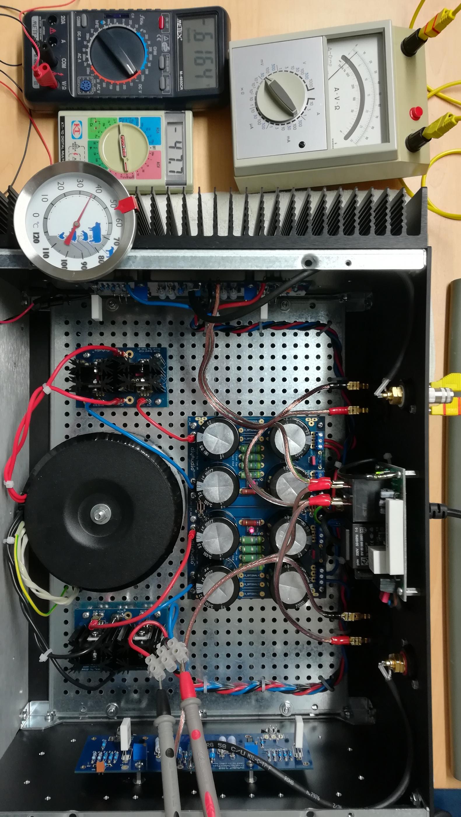

AudioSan, it is an excellent idea, thank you. Take a look at the attachement.
This is what I have been looking for.
But there is a little doubt: could the small transformator on this board (2.5 VA) stray on the input RCA connectors?
Sorry for being absent so long time, but it took many days to assembly my F5.
Now I'm cooking the left channel, see the picture.
The multimeter measuring the offset is older than most of you, I think. Full range scale is 30 mV.
You could try to guess how old is it...🙂

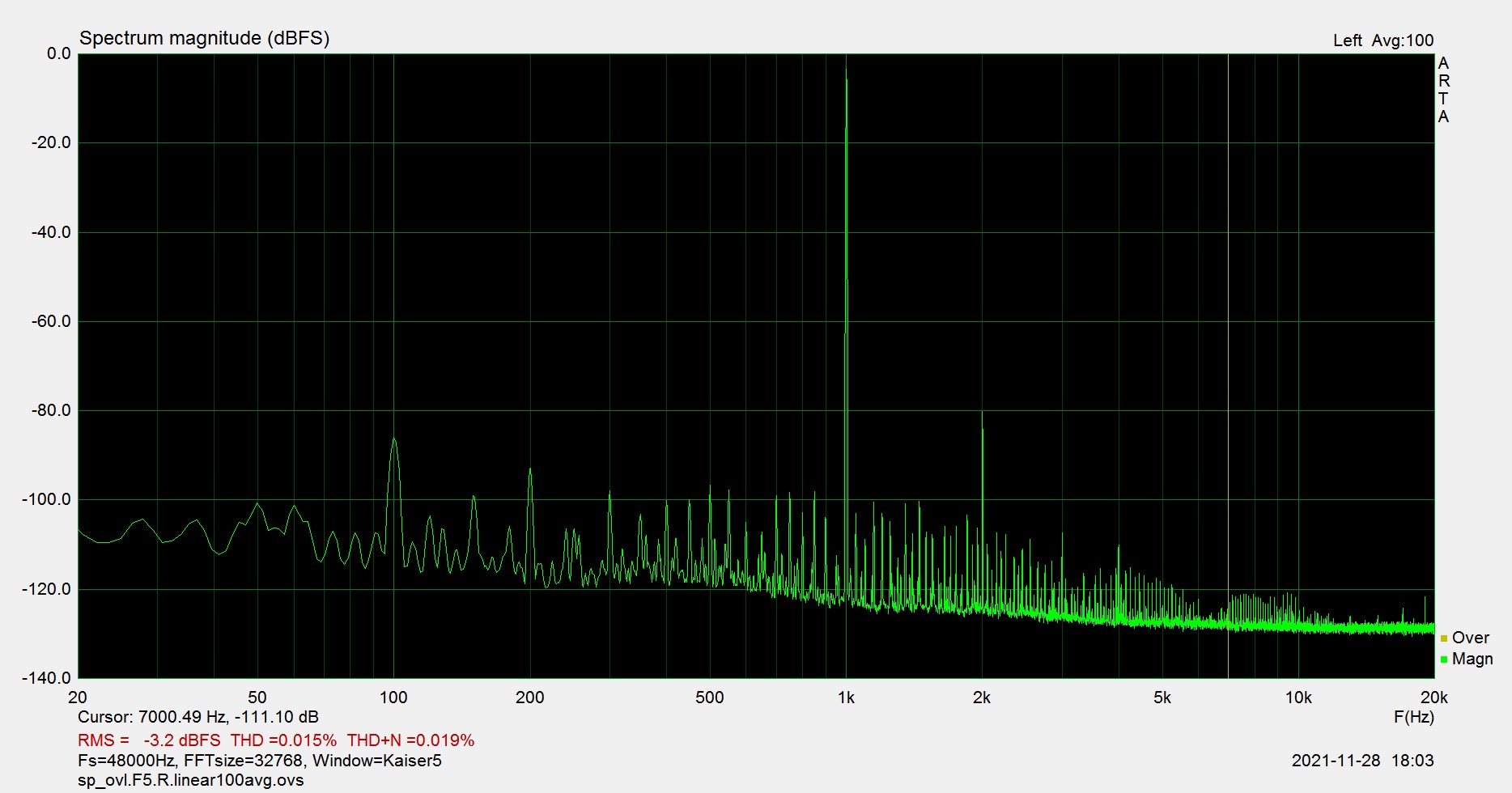

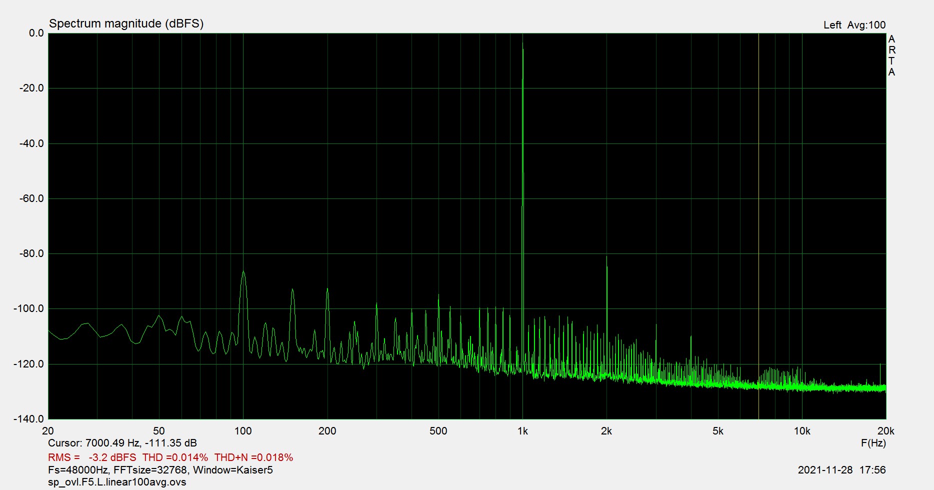

F5 THD+N
My new F5 was ready for some tests, I have done recently.
The figures show distortion at about 1 W for the left and right channels.
You can see the noise floor of 50 Hz harmonics less than -100 dB relative to 1 W power
at dummy load 8 ohm.
The results are a little worser than the original showed in F5 manual.
Do you find it good or bad?😱 I would like to hear your opinion 🙂
