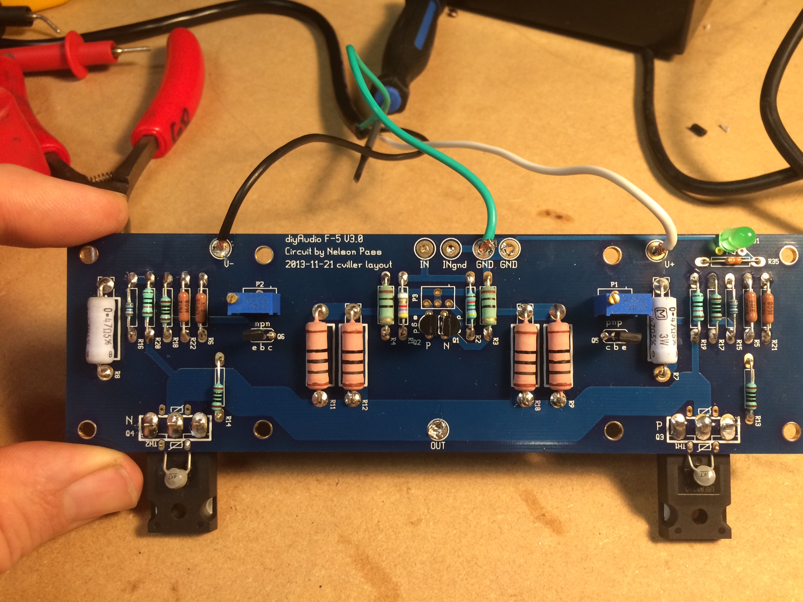

After having some bad luck with Ebay jfets I received my new Linear systems parts from DIY audio and have now installed. I have set P1 and P2 to there lowest value (adjusted fully counter-clockwise) I am not seeing any voltage change when measuring across R7/R8....even with maximum adjustment on P1/P2.
I am happy there was no smoke this time but am really at a loss of where to go from here.......
what Idss values are these JFets ?
I ordered Grade "A" which are listed as 2.6-6.5
Oh.
Make the resistor in series with the pots 4.7k or so. Increase that resistance until you can get bias.
Oh.
I did put another 2.2k resisitor in series and noted no significant change. I will keep bumping up resistance and see what happens...
I hope this pic is helpful. One thing odd I am finding is the power supply. Measuring voltage at supply with board unplugged, I am read +/- 25v which seems right, however when powering up board I read +25v and -35v which seems odd to me.
Time to walk away for a bit!
There's something wrong, be careful. Try two load resistors instead of the pcb.
