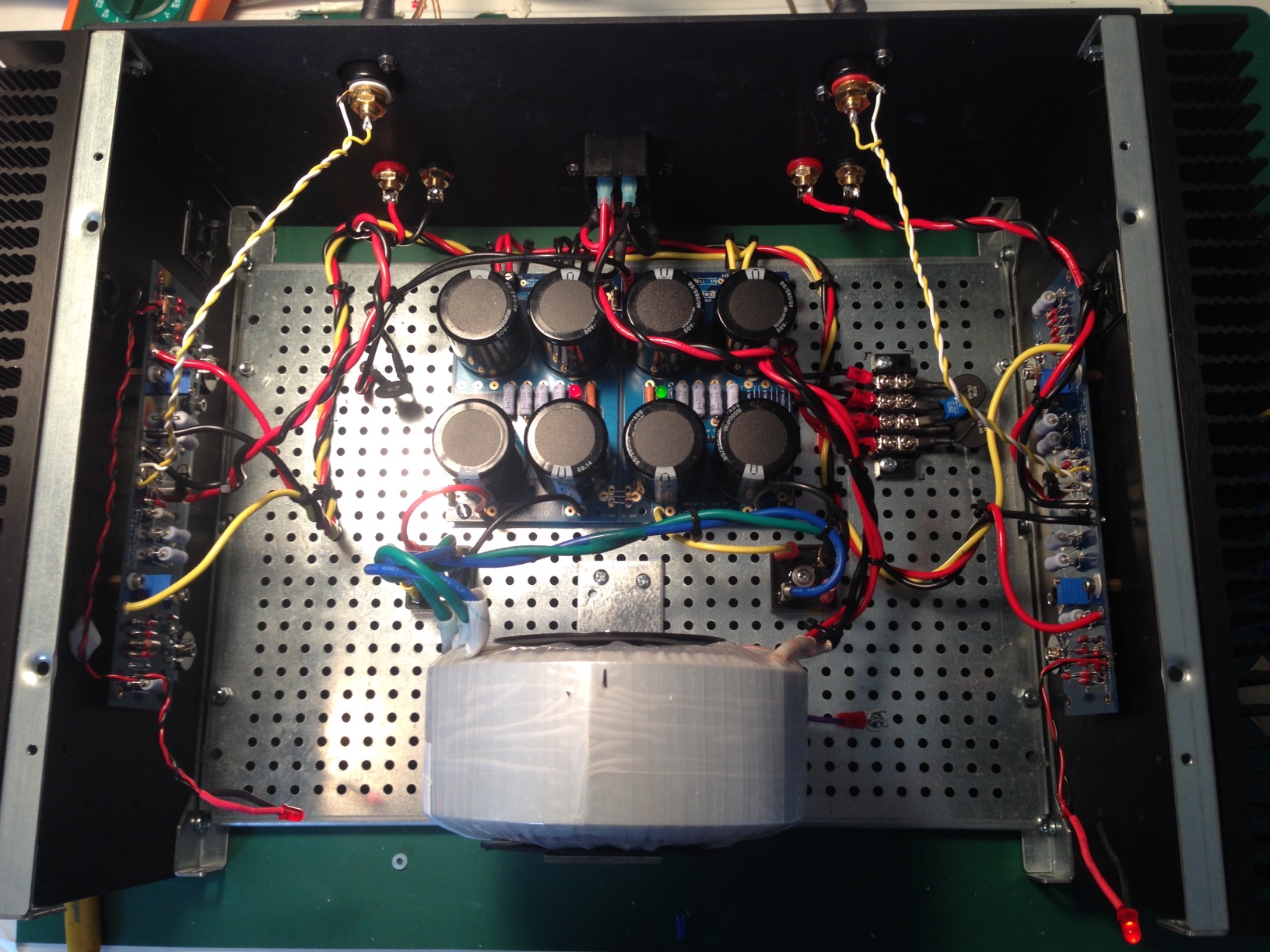

Follow-up to hum problem post #15422
Thanks to everyone for their suggestions. I tried almost all of them: checked all grounds, moved wires around, lots of different grounding configurations. Was about to take it all apart and try the HBR method when I thought I'd unbolt the transformer and stand it on its edge, perpendicular to chassis base. And voila, no hum. So I got a fairly sturdy right angle brace from the hardware store and bolted the transformer onto that. I also cleaned up all the wiring I'd messed up while trying different configs. Turned it back on and the hum was back but very faint and only in the left channel. Moving the left side output wiring towards the center cured that, see picture. So my hum is gone or at least to a point that I can't hear it. Woohoo! Listening to it now with my "test" Focal Chorus 714v speakers. Sounds great. My next step will be to add the speaker protection PCB. Thanks again everybody.
Dbis,
you have used twsted pairs for the flow and return virtually everywhere.
That twisting helps make the amplifier less susceptible to picking up hum interference.
However I see big loops at your inputs. You should see whether reducing the area of these loops has any effect on hum pick-up. You could reduce the loop area to less than 10% of what shows at present.
After that the three widely spaced power wires are creating big loops. You can run the wires closer to the board to reduce loop areas.
I see some black and red single wires between the caps and the transformer.
Do these pass any varying current?

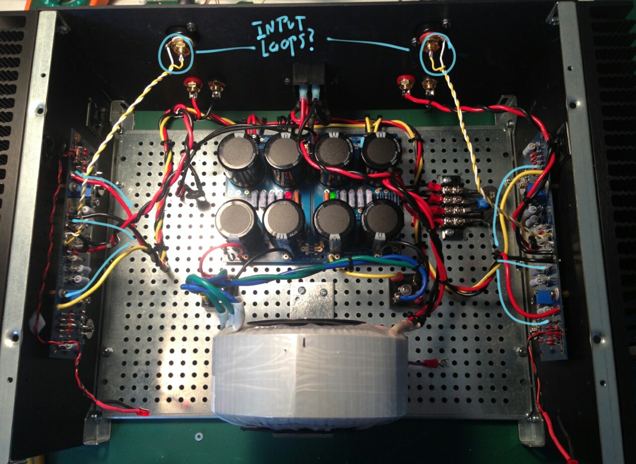

Hi Andrew,
I really appreciate your feedback. I just want to make sure I'm getting it right. When you say input loops are you referring to the blue circled areas on the attached image? And for the loops in the power supply wires, are they the single wires(red, yellow, black) right before the amp boards? I've highlighted them in blue. To get them closer to the boards should I try to twist them together some more and take out some of the slack?
The single red and black wires (yellow and black on minus side) between the transformer and the psu are the wires coming from the bridge rectifiers to the psu board. Should those be twisted and shortened as well?
Thanks again
Thanks again
I am surprised that rotating the ring core transformer changed your hum so much. Is your hum 50 Hz or 100 Hz?Thanks to everyone for their suggestions. I tried almost all of them: checked all grounds, moved wires around, lots of different grounding configurations. Was about to take it all apart and try the HBR method when I thought I'd unbolt the transformer and stand it on its edge, perpendicular to chassis base. And voila, no hum. So I got a fairly sturdy right angle brace from the hardware store and bolted the transformer onto that. I also cleaned up all the wiring I'd messed up while trying different configs. Turned it back on and the hum was back but very faint and only in the left channel. Moving the left side output wiring towards the center cured that, see picture. So my hum is gone or at least to a point that I can't hear it. Woohoo! Listening to it now with my "test" Focal Chorus 714v speakers. Sounds great. My next step will be to add the speaker protection PCB. Thanks again everybody.
Yes, you are reading me correctly.Hi Andrew,
Thanks again
The loop areas between Flow and Return halves of the pairs should be kept very small to minimise interference.
I don't know how much effect it will have on your amplifier. The changes could be unmeasurable.
I was measuring the effect on a long "ground" trace in an amplifier that had +ve supply and -ve supply on opposite sides of the PCB. The ground trace had to run around the perimeter of the PCB. The 2mVac/div showed up an enormous interference waveform on the scope as the probe was placed at different points on this long trace.
The input signal was being corrupted by the long "ground" trace. I scrapped the DX PCBs. I have had other PCBs that repeat this error.
I believe it's 120Hz. I don't have anything to measure but seems too high a pitch to be 60Hz. Before rotating there was a buzzy hum in the transformer as well as the speakers. After rotating you could still hear it in the transformer but not the speakers. Strange. Maybe the magnetic field changes. I'm not quite sure how that works but I saw some drawings online showing how the magnetic field manifests itself around the ring and out from the center. So I thought maybe changing the orientation might change the way the wires are affected. You have to get within a few inches to hear the transformer and once in the chassis with lid on and in the audio rack it's really hard to hear.I am surprised that rotating the ring core transformer changed your hum so much. Is your hum 50 Hz or 100 Hz?
around the ring and out from the center. .
First Watt routinely rotates their amplifiers' toroids for minimum noise in production.
