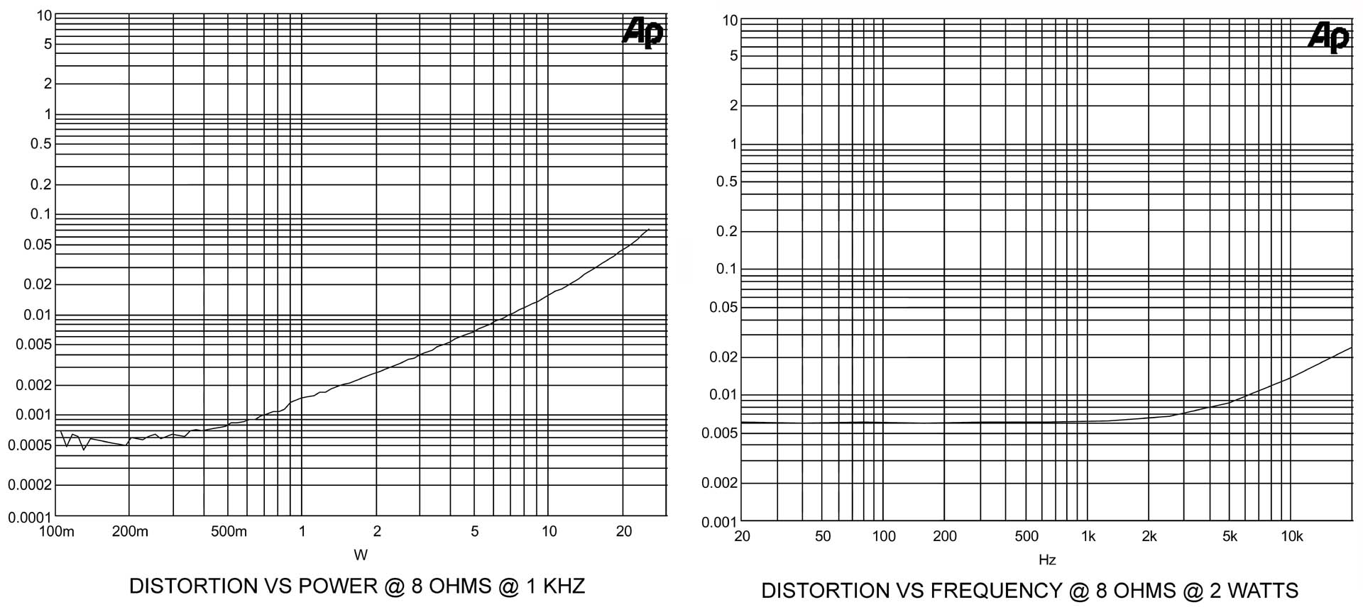

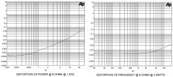

These are the standard measurements for the F5. It would appear that
your F5 is not behaving as designed, or perhaps you are simply reading
the tweeter's distortion figure.

Why do your plots compare tweeter distortions when you should be comparing amplifier distortions?
It would be OK to compare amplifier distortions with a resistive dummy load and/or with a simulated and reactive dummy load and/or with a real tweeter as a load. But in all cases you should be measuring amplifier performance not tweeter performance.
