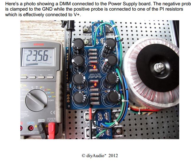

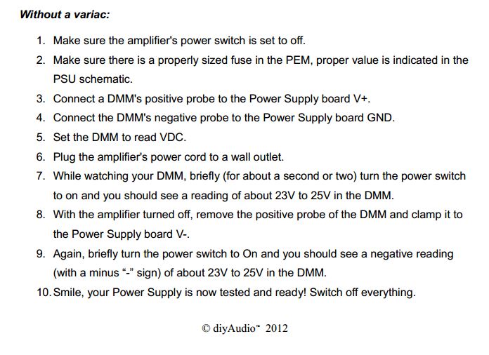

48V where??? Are you following any of the build guides?
Clipped from THIS PDF

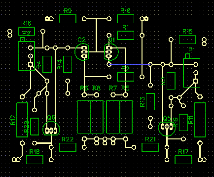

It's been a few months since I've started reading up on the whole DIY thing. I want to build this F5 point-to-point and am wondering if there is anything I should consider when placing the parts.
I've had a fun afternoon with ms paint and came up with a design.
Not really thought about anything special except the transistor placement. I want them to be as close as possible, because I will not be using the bulky heat sinks.
I'd be happy if someone would be so kind to look over my ms paint design and tell me if there's anything wrong and where to put out-.
Q1 is left-to-right S-G-D, Q2 is D-G-S, Q3/Q4 is top-to-bottom S-G-D and Q5 is E-B-C, Q6 is C-B-E if it isn't clear in the picture. I've tried to show the flat sides of the jfet/bpt and the metal on the mosfets. Not sure if one can tell with all the wires going there and the picture being ms paint.
point to point does not have to be laid out in 2D format.
You can use 3D if it helps with locating components near where they belong.
Here's an example:
http://www.diyaudio.com/forums/blogs/wintermute/134-construction-p2p-lm3886-gainclone-part-1.html
or
you can go back to valve/tube style layout using "tag strip" to support devices and components
Woops. I didn't know what point-to-point meant. Sorry. What I wanted to say is I won't be using a printed board, because i can't afford a custom one. Will be using wires to connect the parts. I thought this was where point to point came from, as I would be connecting point to point with wires... I don't know 🙂
If you are not using bulky heatsinks how will you be managing the (large amounts of) waste heat?
I was thinking of using either a 1155 cpu socket cooler (the brackets are already in the picture, 75mm x 75mm) and if that is not sufficient I will be using a waterblock in the same dimensions.
I didn't do any calculations, but I've based this on the TDP of modern overclocked CPUs (~150W+) which are easily cooled by either of those - and they're doing it down to <80°C. This would make the build cheaper and smaller.

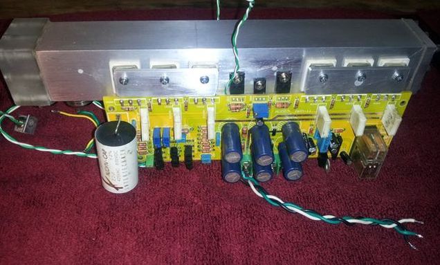

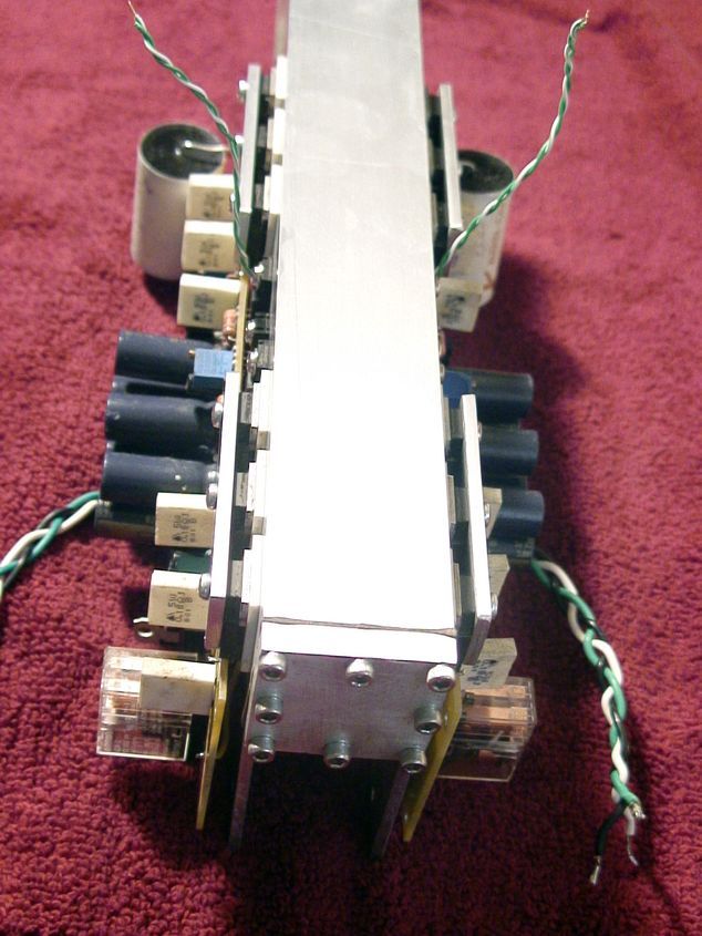

Development on a multi-use liquid cooling chassis is progressing. It has a new horizontal format as opposed to the earlier F5 & BA-3 LC builds. A larger unit for longer boards will be a separate item.
I'm mentioning it here for a reference to heat management for an F5. The photos show a prototype that can maintain 12 output devices at 85% of full class A operation - with only an 6" (120mm) fan. Pump noise is no longer a problem, and I'm currently determining the optimum fan configuration for noise and air flow. At present it appears something as small as a standard 80mm fan will do the job for an F5. Worse case is a distance of 3 - 4 feet to not hear a modern fan. Better results can be achieved and some alternate units have been ordered. A single 120mm fan at 40 - 60% max speed is quiet at 1 foot but requires a larger chassis.
"One cooler will require the fan at max RPM, and should the fan fail, so will the amp."
The BA-3 amp has a temperature sensor that stops the main AC at 68 degrees on the outputs. Other temps can be chosen if desired.
I encourage others to jump on the 'water wagon' as new developments in the PC cooling community make the concept much more adaptable to power amps.
Stay tuned........😉
